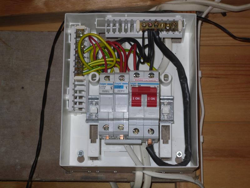

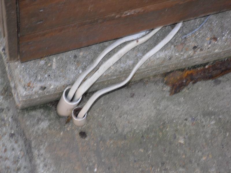

1. 2.5mm T&E i think here's the photo of 3 cables coming out we have a outside light on the patio controlled by the main incomer in the shed.
The cable is about i guess from the CU 20m there is a junction box under the door under the slabs so can't have a look.
The MCB is 20A the fuse carrier in the shed for the plug is 15A and lights 5A i was going to change to a 20A as we don't use the light on the patio i got the festoons wired for that.
It is all T&E under concrete.
Here's the cable going to the house

Could you scan or take a photo of the installation certificate and schedule of test results? Blank out any names etc, it's just the technical information of interest.
Why does that need 3 cables? And I can't see anything coming off the main incomer except what there should be, so I think that you are (fortunately) wrong about that.
Not allowed.
Not allowed.
Ye Gods.
This "guy down the road" is an incompetent and dangerous idiot, isn't he, not an electrician....

1 Sorry i meant fuse unit the fuse there is one cable that goes into a light switch i will take a photo of at some point
Well it's to late now it is about 3-5m under ground so can't really do anything
Sorry a second mistake i meant shed not house :oops:
Oh well, never mind then.
I hope it isn't one of your children who gets killed by that electrical installation.

I did't mean it quite like that what can i do with out ripping the patio up?
Jake
Isolate it until you can have the supply properly and safely installed.
