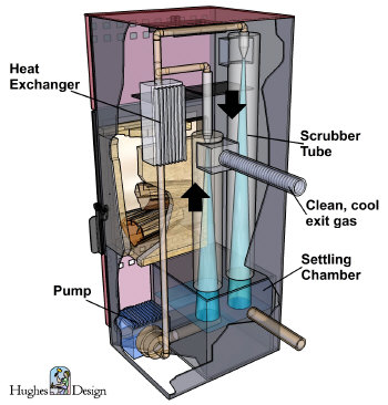

I would say off hand the problem is size, we look at the old steam railway engine and much of the energy was unused, but with a power station, with condense the steam and form a part vacuum where it exists the turbine so extract much more energy, same was done with ships. With the experimental solid fuel fire using condensing it used a plastic flue pipe and there was no need to keep a fall with the pipe, the heat was removed plus all the nasty stuff in wood burning fires by using high pressure sprays of water.
Other more simple wood burners allow water to dribble out of the flue.
