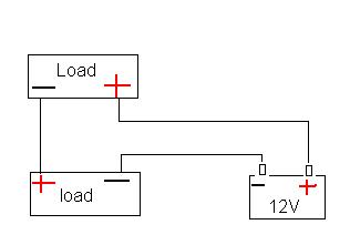

wiring 2 loads up in in parallel to drop voltage (ed: he means in series)
4 Sep 2022
625
3
So we all know this one works
but what about if we wire the loads up in in parallel circuit to one battery. will this mirror image and drop the voltage
Sorry I`m struggling to see your intentions clearly here.
It seems one diagram shows two 12v batteries wired in series to provide 24V to one load.
The other diagram shows one 12v battery wired up to two loads (or if you prefer two half loads) in series so they will both consume the same current but the voltage split will be dependant upon the equivalent resistance comparison of the loads. i.e. if both loads are exactly half of the total load then they will run the same current and at 6v each.
Yes, each of the loads in the second image will get a proportion of the 12V.
If they both have the same internal resistance, they will each get 6Volts.
But in the real world, with real loads you have to be careful as their internal resistance can change giving interesting effects, for example providing more voltage to one over the other.
It has worked very well for many decades in thing like Christmas fairy lights.

Yes that is what i want to do hear; is split the voltage in half for each load so they are 6V each
So is that how they get say a 24V DC supply down to 2V per LED; by having 12 lights wired up (series or parallel one not sure!)
BTW it is 2 times LED lamps I want to wire up to a car battery. The LED lamps take 4 AA batterys (so 1.5V times 4= 6V each)
But will each one get 6V
They will if the two loads are (electrically) identical - which is what SFK was referring to when he talked of them having the same 'internal resistance'.
If the two loads are different, then they will share the 12V unequally (e.g. one might get 8V and the other 4V).
BTW, in your diagram, the two loads are in series, not parallel.
Yes the loads will each have a voltage across them according to how their equivalent resistance looks like in simple terms so if they match up pretty well they will 6v each from a 12v supply but if their resistance appears very different to the battery they would divide that total voltage very differently. Could you say what you are intending to achieve please?
With other resistances you might find 8v and 4v or 1v and 11v etc etc

BTW it is 2 times LED lamps I want to wire up to a car battery. The LED lamps take 4 AA batterys (sic) (so 1.5V times 4= 6V each)
We do not know the construction of the LED lamps that you wish to use.
If they consist of several LED "chips" wired in series - with a suitable dropping resistor (as is likely) - all should be OK if you place two such lamps in series across 12 V.
However, if there are two (or more) such series "strings" in parallel in each lamp,
if one parallel "string" in one lamp should fail,
the Voltage across the other lamp (and the Current through it) will drop
