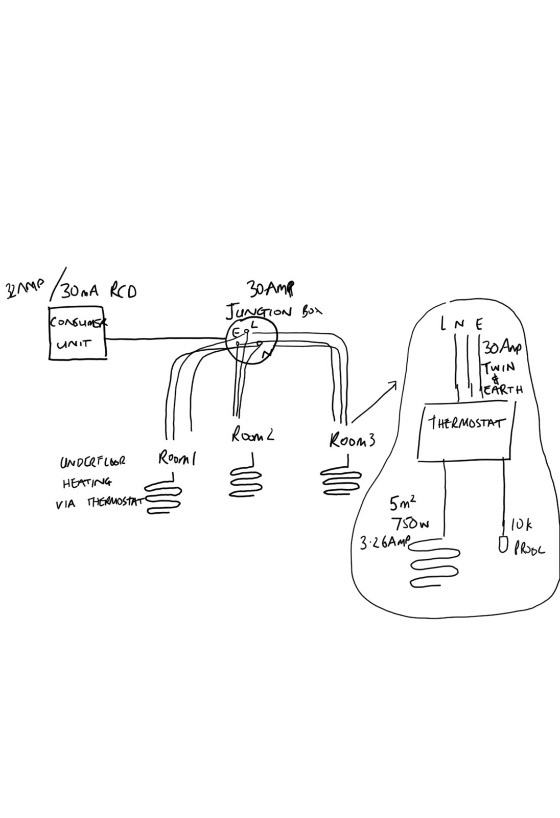

Hi All, I’m doing a DIY project but needed some advice before I comitted and would really appreciate any help/advice you can offer.
I have recently moved in to a new house and wanted to put in electric underfloor heating in the hallway. The property is a bungalow and all the wiring goes in to the loft and then back in to the rooms, its been re-wired recently (from what I can tell) and has channels within the walls to use in order to drop the wiring down in to the rooms. The property already has underfloor heating in the kitchen and the main bathroom. It’s wired on its own circuit from the mains (consumer unit) through the use of a junction box.
I’ve checked all the wire ratings and RCD ratings and all seems to be fine – the wattage rating for both of these mats/loose wires adds up to 1.3kW. I'm looking to add another mat/loose wire in to the circuit of 750w.
My question is can I tap in to the existing junction box and make use of the RCD/mains and drop the wire in to the hallway to power the mat/loose wire? I appreciate I will need an electrician however wanted to size up the costs and whether or not I’ll need a new circuit as at current I have no free slots in the consumer unit.
Thanks in advance or your replies and apologies if my wording/terminology isn’t spot on – I’ve also done you a little diagram (of my madness)!!! Also if you could go easy on the abuse that would be great :)

Hi Kadi, while the elders argue about the merits of old money versus new money, let me answer your question.
You say you have checked the ratings on the RCD, usually the there is an MCB (breaker) for the circuit and an RCD for multiple circuits (if it's a combined one it's called an RCBO). Either way, it's the breaker current you need to be sure you are not exceeding (technically the RCD max current and the total current for the incomer as well, but the chances of going over that with 1.3kw are slim). Whats the rating on the UFH breaker?
In general, yes, you can do as you suggest. If you are wiring it into an existing circuit (and not directly into the Consumer Unit) and the UFH is not in a special location (bathroom etc) then you could do all the work yourself without requiring Part P.
You could also likely safely wire 1.3kW as a fused spur off any ring-main socket in your house.
