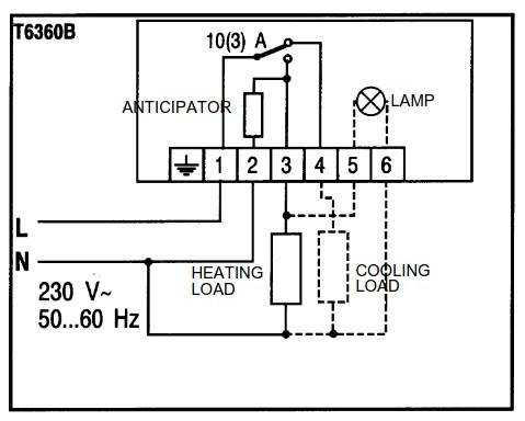

From what I've read, terminal 1 in the Honeywell thermostat should be permanent live and terminal 3 should be switched live.
My multimeter says they are the wrong way round. I've looked at the isolator switch wiring for the Vaillant Turbomax Vuw combi boiler. There's a 4 core into the boiler.

The 120vac is odd, are you testing correctly between neutral or cpc/earth? 120vac is usually when you test between Live and switched. At the Honeywell test between 1 and 2 without demand, you should get around 230vac. Between 2 and 3 without demand should be 0vac and with demand should change to approx 230vac.
I concur with what you say based on what I've researched on YT. It seems to me that the connections for the thermostat at the boiler need checking.

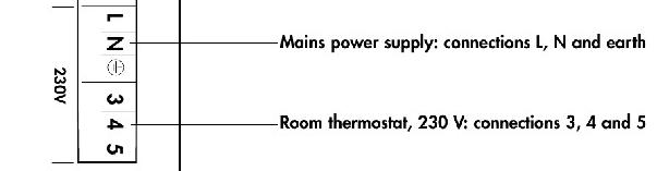

This picture of the boiler's install manual indicates the relevant terminals on PCB so I'd need to ascertain which connect to terminals 1 and 3 on the Honeywell T6360B.

It should be 3 (common/live) out from Vaillant to 1 on Honeywell
3 out (switch live) from Honeywell to Vaillant.

Is Vaillant 4 or 5 the switch live?
Presumably the remaining of three being the neutral!
This gives the wiring info. p20
Is it necessary to take the permanent live and neutral for the Honeywell from the combi's pcb terminals?
Could they be taken from the switched side of the isolator switch?
Vaillant 5 is neutral. 3 permanent live 4 switch live, which is what I said in post 5 minus the neutral

I found the issue having looking at the Vaillant pcb !
Honeywell 3 is connected to Vaillant 3
Honeywell 1 is connected to Vaillant 4
The neutral in the Honeywell 2 is connected to the switched side of the isolator.
