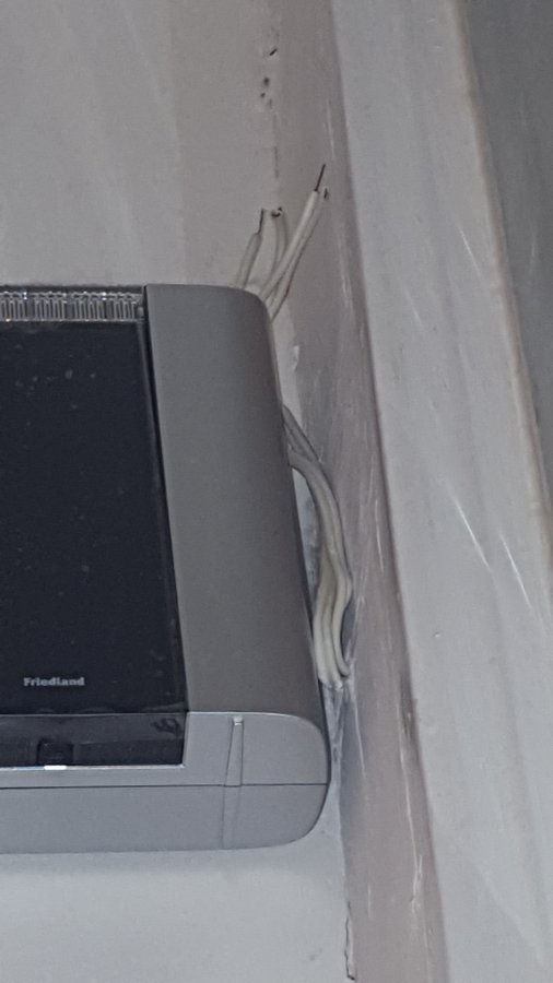

I want to replace my wireless doorbell and chime system and not sure how to go about it....
I have located the existing location of the chime unit and it has two set of two wires -
1. 2 Wires that come from the (I assume) the consumer unit that are meant to go into the chime
2. 2 wires that go from the chime to the doorbell.
Not sure how they are supposed to work and where they have been connected into the 'consumer unit'?
The wires are skinny white wires and have no colours on them.
Any ideas what I need to do?
Does not sound wireless to me?

The chime unit could have been fed by a transformer unit hence the white wires, popular in the 60`s
Like this: http://www.screwfix.com/p/time-bell-cable-2-core-100m-white/87513 ?
If so, then those from the consumer unit will be from a transformer, the others to the button at the door.
Wiring is to take one wire from the 'consumer unit' end and one from the button end and connect them together.
The two wires that are left (one from each side) are connected to the chime or bell.
This assumes that the transformer and button are still working.

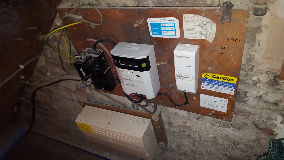

That is exactly the wire!

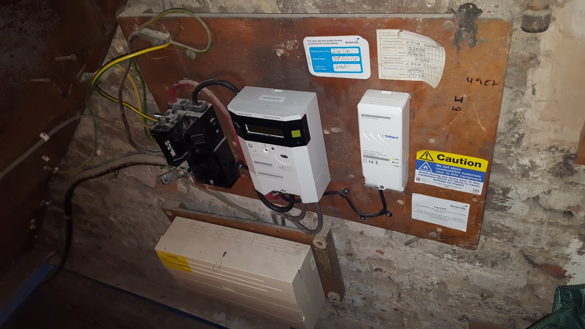

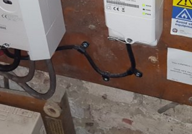

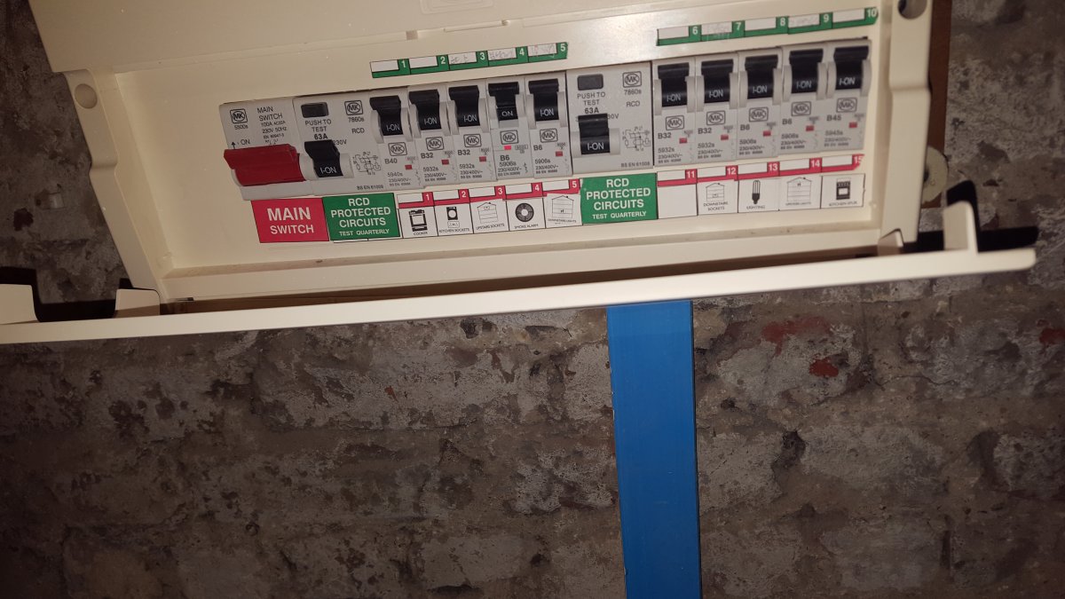

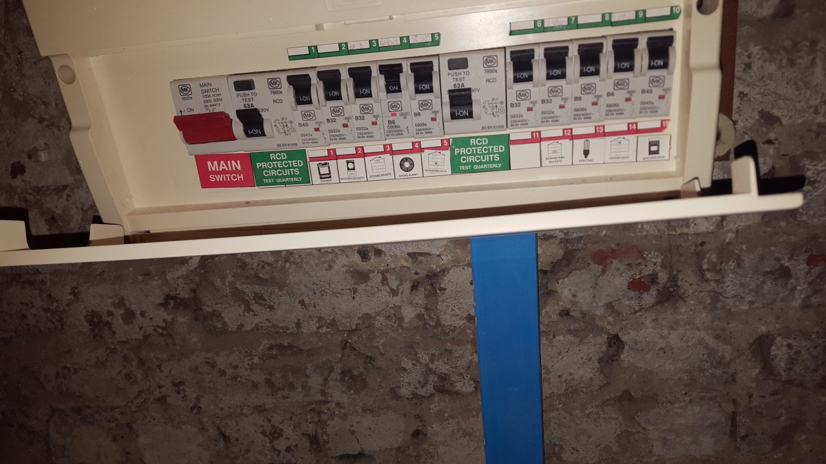

How do I know the builders have connected it to a transformer and not directly from the consumer unit?
Usually the transformer is located next to, and sometimes inside, the consumer unit.
Post a pic of the cu and its surroundings.

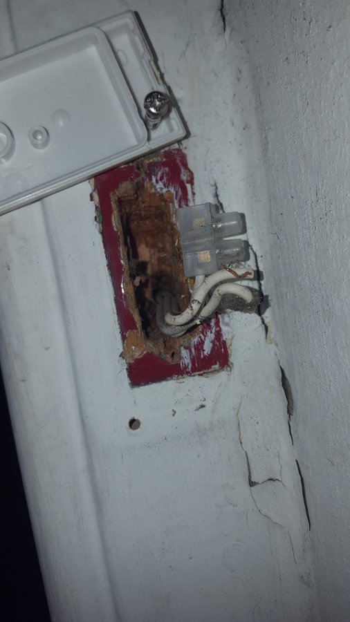

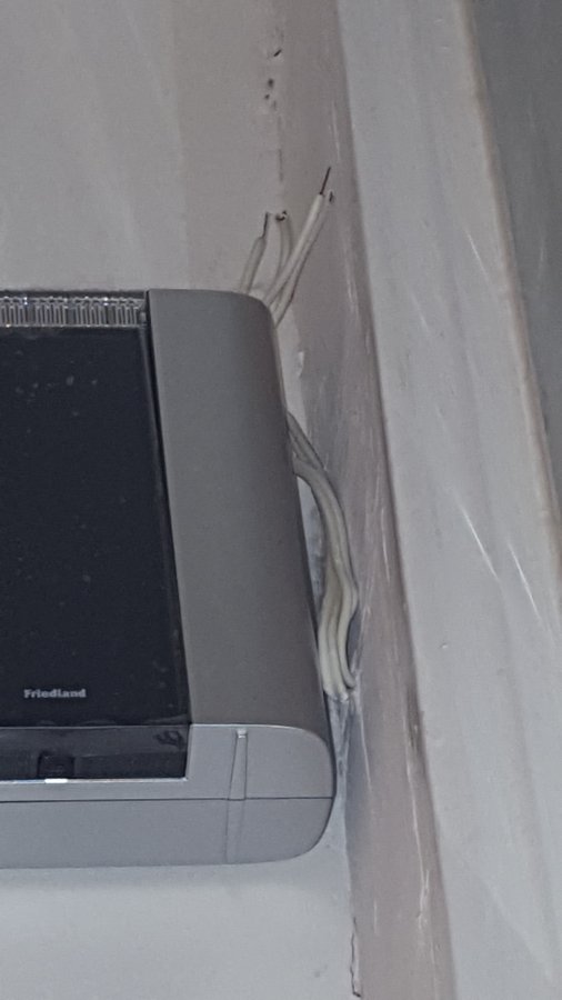

So a little confused now...

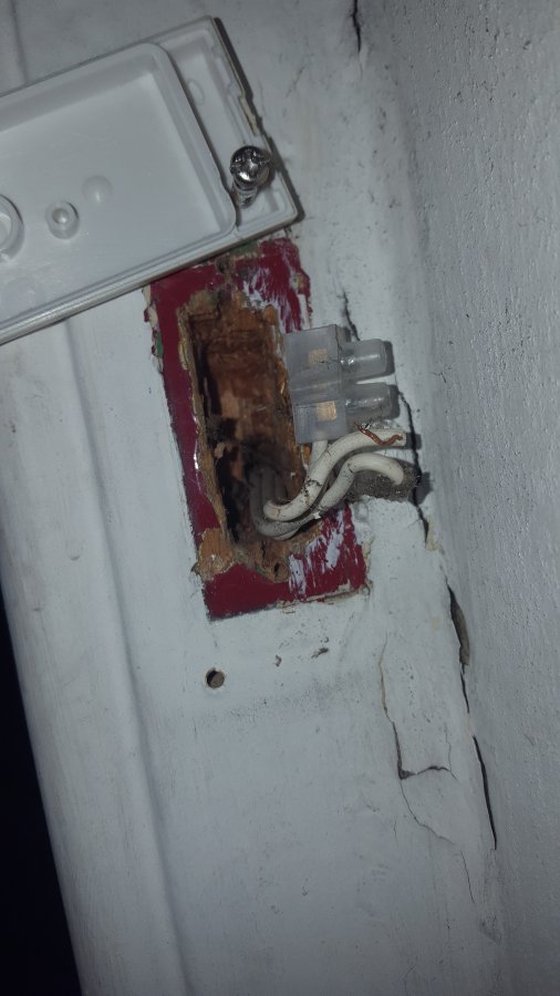

Here are the pics of behind the doorbell, where the chime will go and the consumer unit....
Not what I expected!
I especially thought there would only be two wires behind the doorbell not 2 sets of 2...

Any ideas guys how I will wire the bell and chime?
Just to add - I have a 2nd chime unit in the kitchen area.
I have just checked behind it and there are 2 wires located there as well....
So I assume the way it is setup is as follows -
Kitchen Chimes to Doorbell?
Doorway Chimes to Doorbell?
Consumer Unit or other source or Doorway Chimes?
There doesn't seem to be a transformer near the consumer unit.
Do you own a multimeter?
