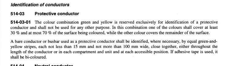

I'm used to that sort of stuff too, the fact is the current edition of the regs (17th edn BS7671:2008 amd 2011) causes some confustion on the matter by mentioning single core conductors.
Prior editions such as the 16th edn (i.e. this scan from the amd 2 of the 1992 regs - yellow cover) made it cast in stone back then that you must never use green/yellow for any other purpose:
But didn't that change with the Europe directive and harmonisation.
Possibly, however it is something that was drummed into every electrician who was trained in the 16th era which there are still a lot of about!
The punishment for falling foul of it was a megger across the back of the neck :LOL:
The current version of BS 7671 uses pretty much the same wording, regarding green/yellow colours.
One can speculate on the purpose of that particular mention, but in reality all we need to know is that the colours are reserved for cpc usage, and for anything else in an electrical installation, we must use another colour. To waiver on the side of caution in this case, I'd probably sheath the entire exposed length.

514.4.2 Protective conductor
The bi-colour combination green-and-yellow shall be used exclusively for identification of a protective conductor and this combination shall not be used for any other purpose.
How can anyone argue about that? It is rather final. It continues:-
Single-core cables that are coloured green-and-yellow throughout their length shall only be used as a protective conductor and shall not be over-marked at their terminations, except as permitted by Regulation 514.4.3.
In this combination one of the colours shall cover at least 30 % and at most 70 % of the surface being coloured, while the other colour shall cover the remainder of the surface.
A bare conductor or busbar used as a protective conductor shall be identified. where necessary, by equal green-and yellow stripes, each not less than 15 mm and not more than 100 mm wide, close together, either throughout the length of the conductor or in each compartment and unit and at each accessible position. If adhesive tape is used, it shall be bi-coloured.
The exception referred to is for a PEN conductor which are never used within the home.
that scan means exactly what erics quote from the 17th means and its not what you think see below
but it's not saying what you think it does
It's saying that a cable identified by the Bi colour combination green and yellow will be a protective conductor and nothing else
It does not say that you can not over sleeve said conductor and use it for a live conductor
A reference to single core cables not multicore
