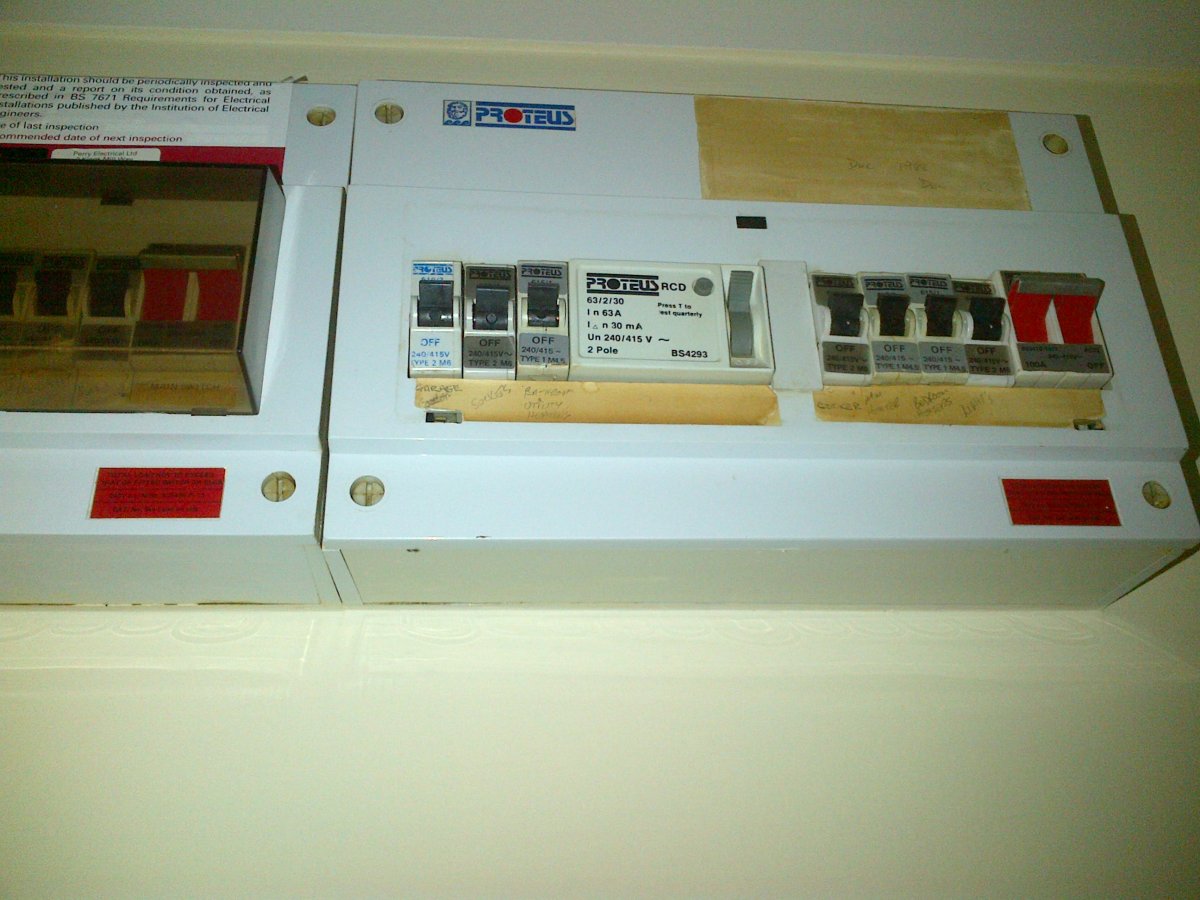

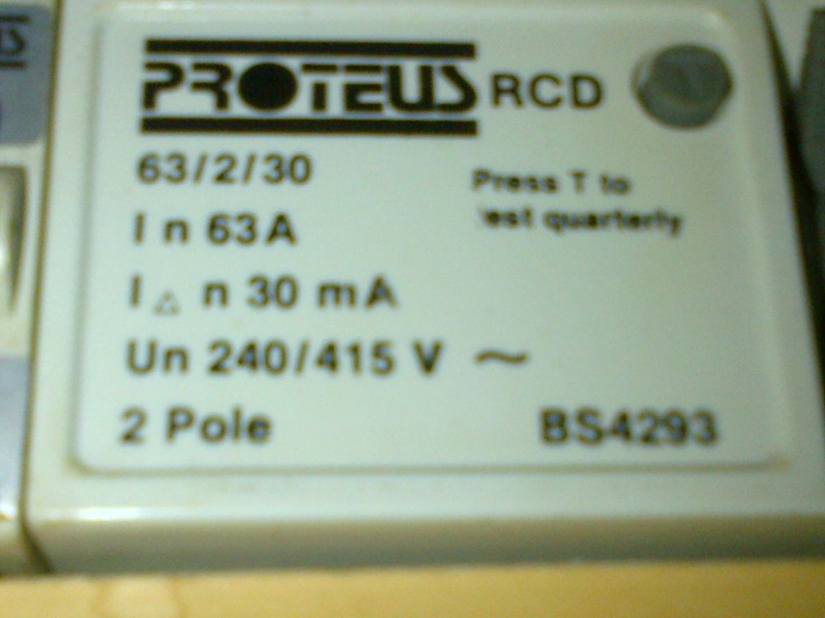

He did mention that if the RCD in the attached picture failed I would not be able to get one and would need a new consumer unit.
Do you know if I could source the RCD anywhere to keep as back up?

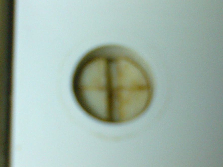

Also I noticed today one of the 4 spring loaded screws holding the cover of the consumer unit is missing, I had a look on ebay but had no luck finding one, do you know the correct name and if I will be able to get hold of one?
That is true, but it might not fail for 10 years, 20 years or ever.
As for the screws - no chance, they will most likely be specific to that unit. One missing screw out of 4 won't make any difference. Might not even be screws, could be some quarter turn things instead.
Front plastic cover also appears to be missing - but again, so what?
You will probably need a new consumer unit at some point anyway, as the RCD doesn't cover any of the circuits on the right side - changes to any of those will almost certainly require an RCD.

Actually you are right, it is a quarter turn thing.
As you say it is probably not important. I was thinking ahead and if I sell this property in future it might be picked up by a picky buyer or surveyor.
I took the front plastic cover off to take the photos.
I do not plan on making any changes to the circuits on the right side.

For Proteus contact CEF (City Electrical Factors) it is there stuff.
Did the electrician say why the RCD had failed?
It maybe possible to modify the board so their newer RCD will fit.

After going into 3 electrical outlets yesterday and asking about the Proteus RCD one shop told me of the
CEF connection so I did e-mail them yesterday with pictures. Awaiting reply.
It has not failed yet. Before he left he pointed out that the RCD is only in connection with the 3 switches to the left which are the Garage, Sockets and Utility/Bathroom heater.
He mentioned IF it failed I would probably not be able to get a replacement.
He pressed the T button, to test and it took a couple of attempts to reset the RCD and said this can be a sign it is on it's way out.
