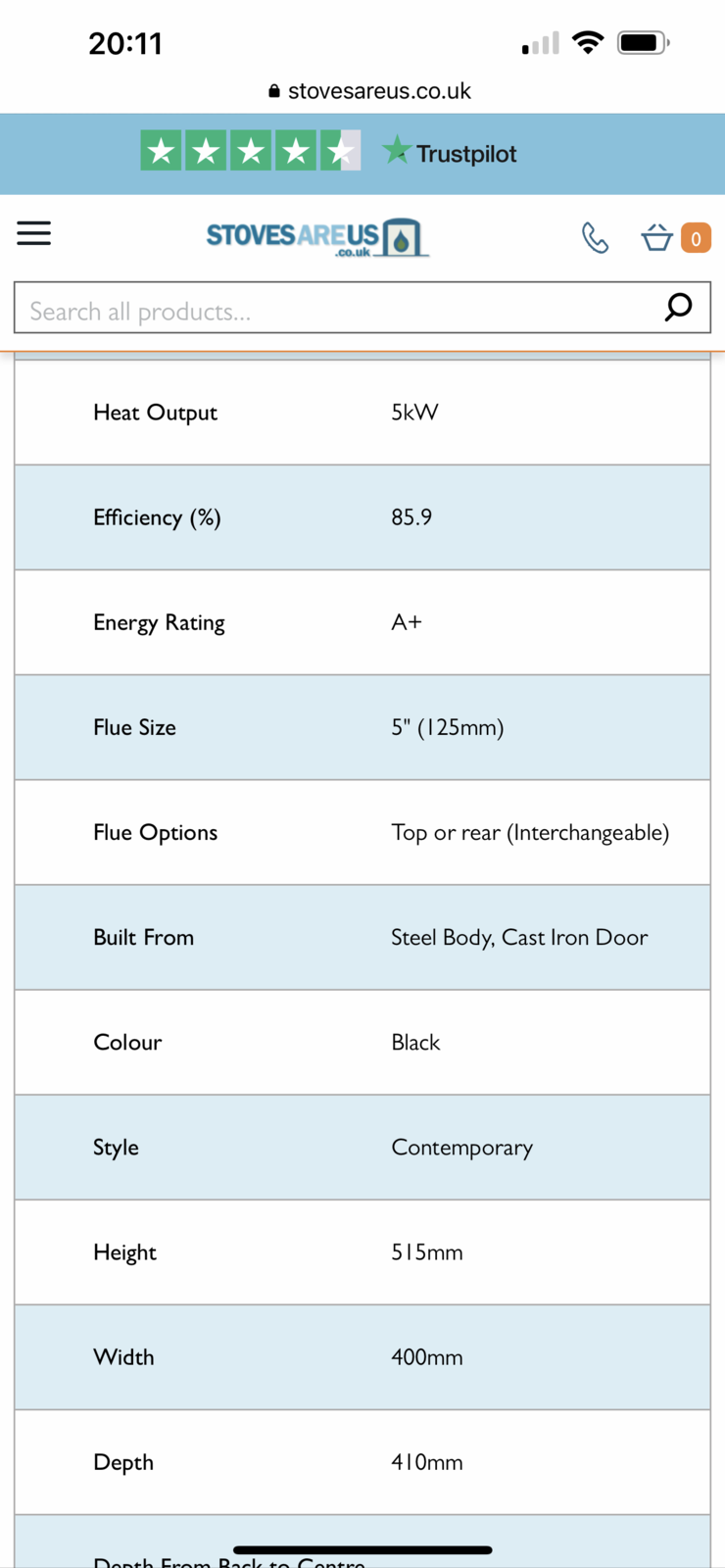

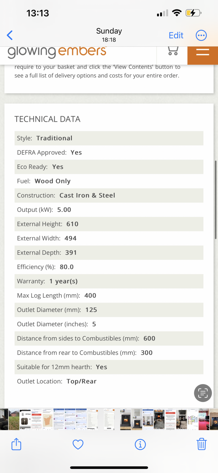

@Burnerman I have the option to switch from an Allure 05 burner to an Aspect 4…
This will mean little cost as won’t need to touch the current surround or hearth but will only give me 6” of space above the stove (compared to the 2”) now… worth it? And probs like an extra inch either side of the stove.
I’ve added both specs to this comment!

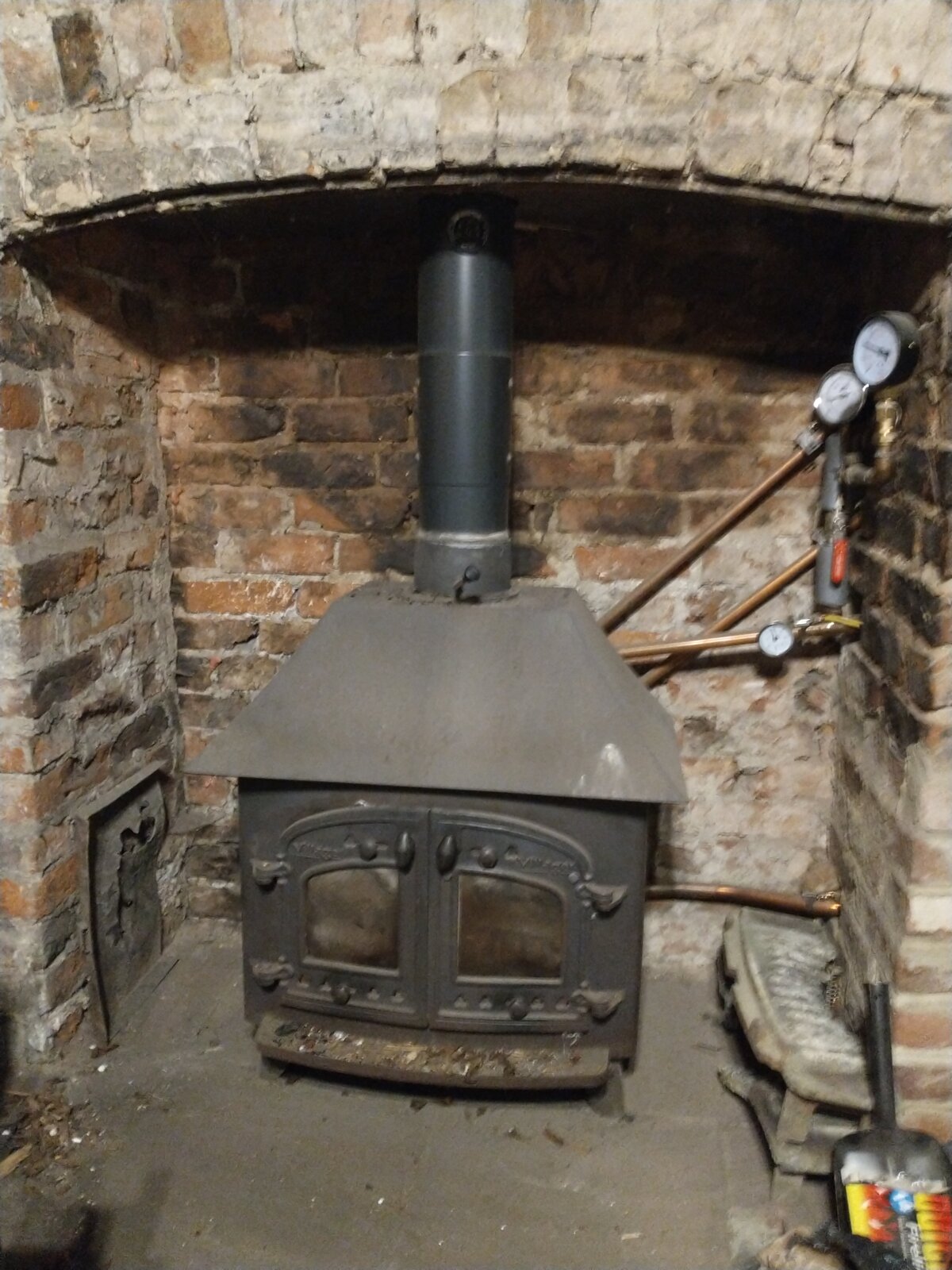

My four penn'orth- either pull your existing burner forward (if your stovepipe is 5" the minimum you can come forward will be about 8") or open up the fireplace so the thing can breathe (or fit your smaller stove).
As long as it's the same company who fitted your burner they should be happy to use the same liner so labour costs shouldn't be hideous. Wouldn't get excited about part-ex value, you'll probably do better on Facebook Marketplace.
Here's mine- it's set back into the fireplace and has a water jacket on it (13kw total, 5 into the room) and it heats this room (kitchen) and the hallway and upstairs landing very nicely from convection, the water jacket heats the thermal store which looks after rads and hot water. Drawbacks- it eats timber, stoking every 20 minutes or so, glad I don't pay for it :)

You’ll realise the spec you’ve uploaded ( left sheet) is for a wood burning stove only.....ideally you need a multi fuel stove so you can burn smokeless ovoids, or the log bill will be huge! To be fair, there isn’t a huge difference other than a grille that can be riddled. Ovoids cost about £15 per 25 kg up here.

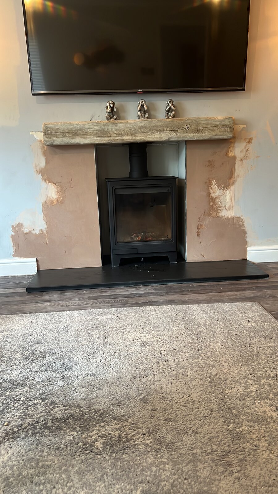

Hey! @Burnerman @oldbutnotdead
We’ve had the recess opened up as much as possible. The space above the wood burner has increased from 2 inches to 9 inches and the space on the sides has increased from 2 inches to 3 inches (it wasn’t possible to open it up anymore due to the external chimney breast!)
Better????
I still think it's tight at the sides... out of curiousity what board has been used on the sides and back of the aperture/reveal?
The sides may get warm depending on how much heat is thrown out of the sides of the stove.
Better now you've got more room above the stove... a flue thermometer is a good investment (£10) so you can see when it's burning efficiently.
I have a heat activated fan above mine too. Also make sure you have carbon monoxide detector.
FWIW I've got around 125mm space at the sides... and my skirting board is chopped flush to edge of the aperture/reveal, no problem when stove is raging.

That’s as wide as it could go at the sides we’ve been told, so there has just been a small increase at the sides then the original set up - the only way to get more space is to change our burner which is currently an Hunter Allure 5 and replace with the smaller version Allure 4… but I’m hopeful that this new set up will be enough to stop the heat getting trapped…
The guy that installed it said he has put insulation down the flue too - stones of some sort he said , so instead of heat going up the chimney breast and getting lost more should get transferred into the room?
There is fire proof boarding around the sides and back - same as what was there before, I believe it’s only thin boards?

Reckon you might just get warm sides of the reveal if the fire has been on a few hours, it's it cement fire-board, it will cope with the heat no problem.
The 'stones' may be vermiculite and a around the flue liner. This is the proper way to do it.
