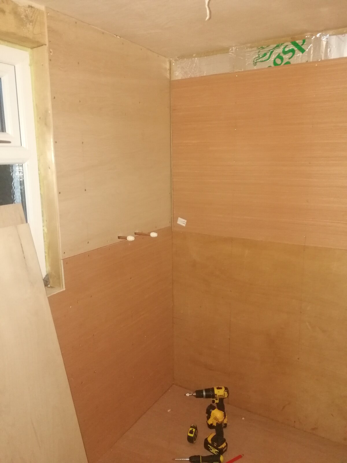

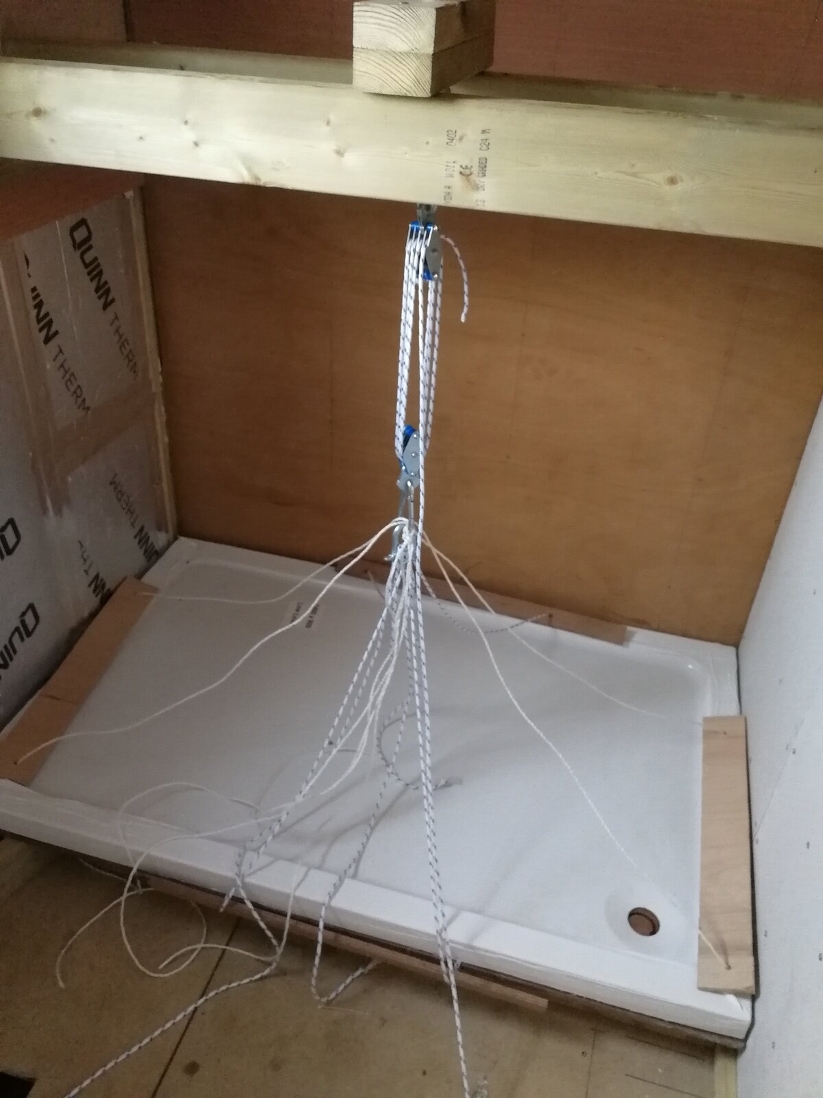

Sounds like you're at the same stage as me. My tray was a tight fit between 3 walls (but the tape measure says I have 10mm to play with). I have taken the ply off the left hand wall to allow a level fit, then I will wedge in whatever fits and tile up from that. Don't know if you're able to do this?

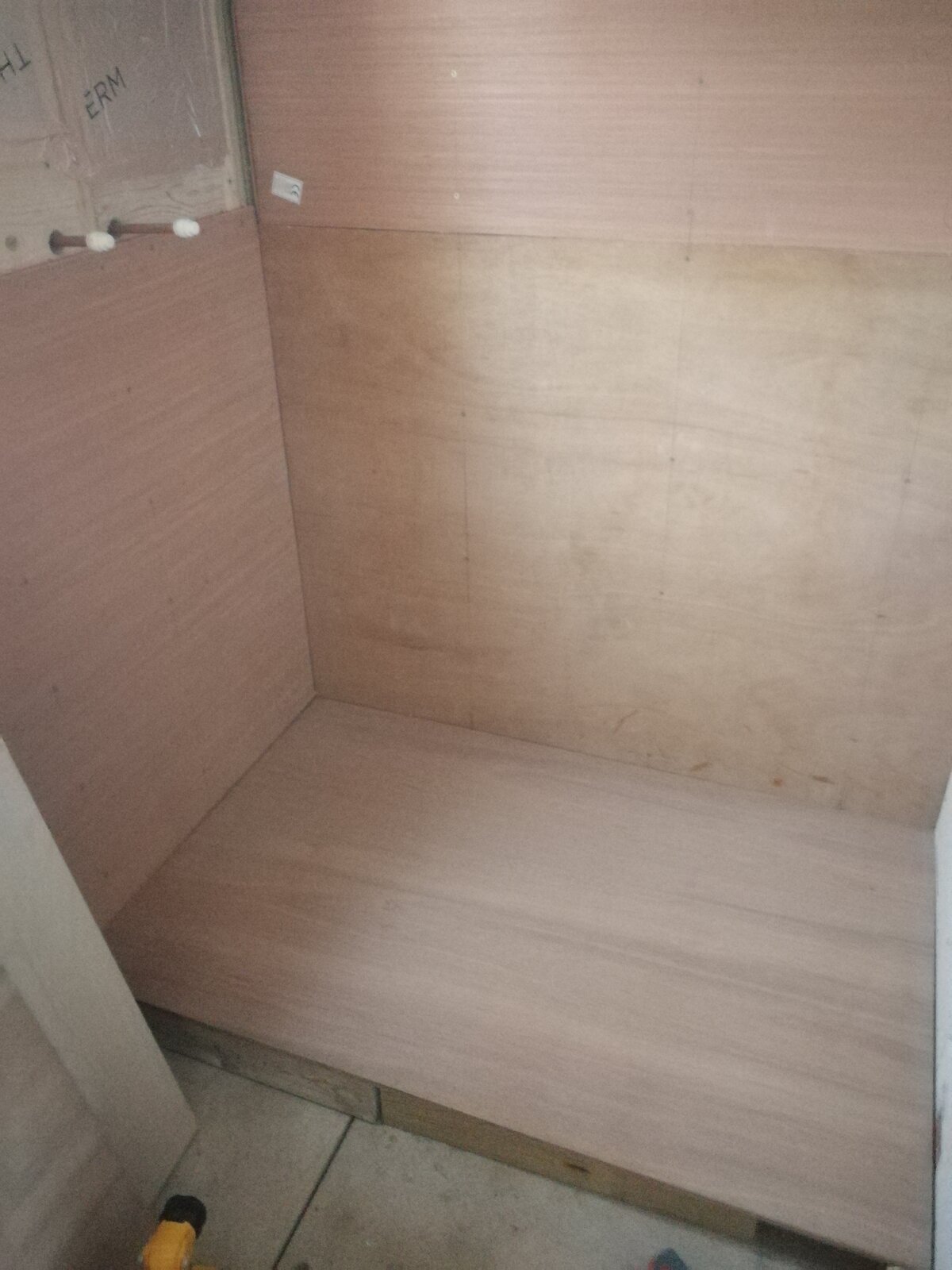

Its 3mm high as I had a real pain in the backside with levelling the floor. I had to splice a couple of joists with steel plates due to rotten ends; its an old house and getting it level to where it is was extremely difficult! (for me) especially and I've just discovered my spirit level was just out (replaced with a Stablila). The 3 walls of the enclosure are square and plumb, done out with backer board. But my measurements were almost too accurate and its left me with a very tight fit, it would be especially difficult for me to bed on a sand/cement whilst guaranteeing I solve the 3mm problem! I don't think using shims to level the tray would work as it would mean some of areas of the tray wouldn't be in contact with the ply.
With regard the 3mm difference for the rest of the enclosure, I'll account for it on the first course of tiles (subway), I'll be starting from the second course using a laser level to ensure any discrepancies don't continue over the whole wall.
It's a stone / resin tray and will be fitted with a single wet room screen from Mira. Worth noting that the front edge on which the screen will be fitted is level, its the back right corner which is 3mm out.(one furthest from entrance and adjacent to shower head). Shame as the floor is solid and the enclosure is square. :confused:.
Thats some solution to the problem! I was thinking of something similar but can't see how I'd manage it with the enclosure at the stage its at, I'd have to remove the backer board from one of the walls, taking all the tanking with it. Are you going to bed on cement or use silicone?

If you take the backer board off, could you cut a bit off the bottom (the width of the shower tray), then refit backer board. Not sure how much this would compromise the tanking. I'm slapping a load of tile adhesive on my base.

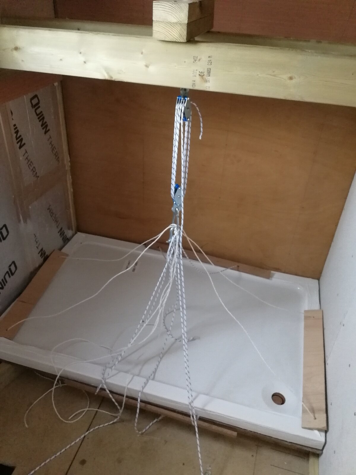

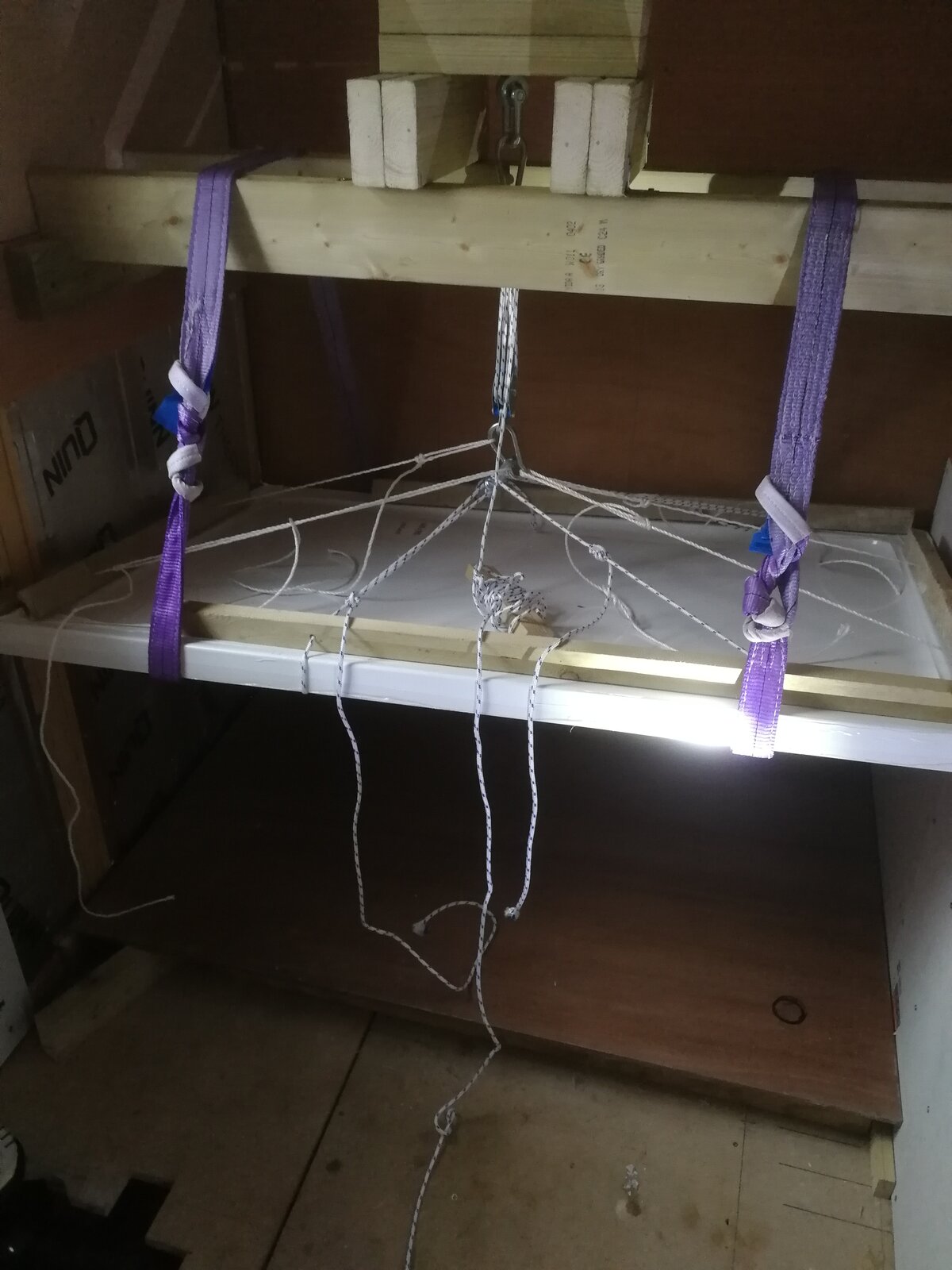

I would rethink the silicone option. My tray is 1400x900 like yours and weighs in at 60kg! (That why I made my lift for it). I'm only a diyer but I wouldn't be putting silicone under that much weight in stone resin TBH.
