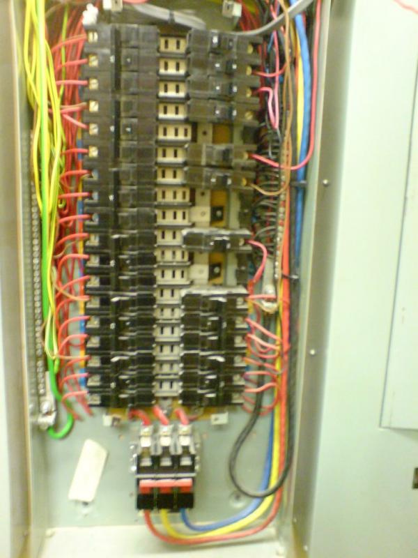

There are 2 (thin) reds and 2 blacks from the Henley block disappearing behind the service fuse, which I think (hope!) feed the Wylex in some way.

Probably some form of dual tariff, flats were probably built with electric heaters.
Not seen inside yet. I'm a bit cautios about going in as Wylexes (Wyleges?) of that age often have live bits easily touched.
Oh absolutely. It looks to be the right vintage to be dodgy with the cover off, so best not to if you're not sure.
Looks like a flat with underfloor heating, where the wylex did the heating and normal electrics.
As some stage maybe one of the circuits (heaters?) have been moved to the mem, maybe for E7 ?
Though the wylex boards are quite tame compared to some of the 3phase boards around at the same time... D/S loadmaster, federal, bill 3036 etc :evil:
But yeah still not good for the OP to be taking apart if he is not sure what to expect :idea:
Found a couple in my archives tonight
Or 2-phase/split-phase (whichever you prefer but keep it to yourself) domestic boards used in the USA.
