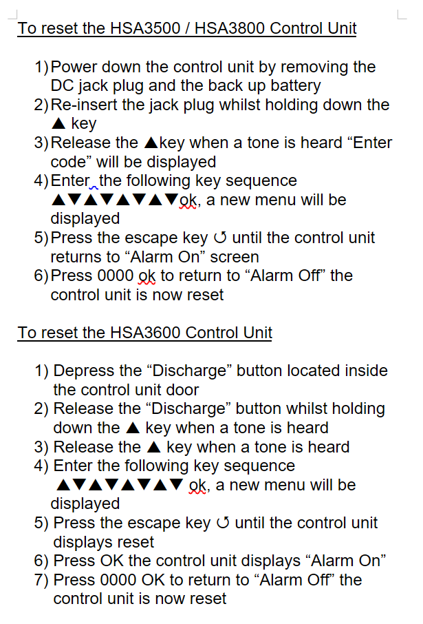

Having picked up a Yale HSA3500 unit in a garage sale in need to reset the PIN. Having worked out how to bring up the factory reset, I can’t work out how I enter the code shown as there are no letters on the keypad. Can someone help me out please.
Sadly that doesn’t work either. Does anyone know what button I need to hold down when I turn the power back on?
The "up" arrow.
did you reset it using the up down up down up down up down OK instructions?
after that you should return curly arrow repeatedly until it displays Alarm On, then 0000 OK.

Thanks JohnD, the arrow sequence did the trick. Now armed and dangerous!
Old post but i thought i would share this.
