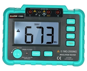

- I've tested the resistance of the heating element - 19ohms, which I think is correct. No detectable connection from either terminal to the tank itself, though I'm only using a multimeter and not an insulation tester.
