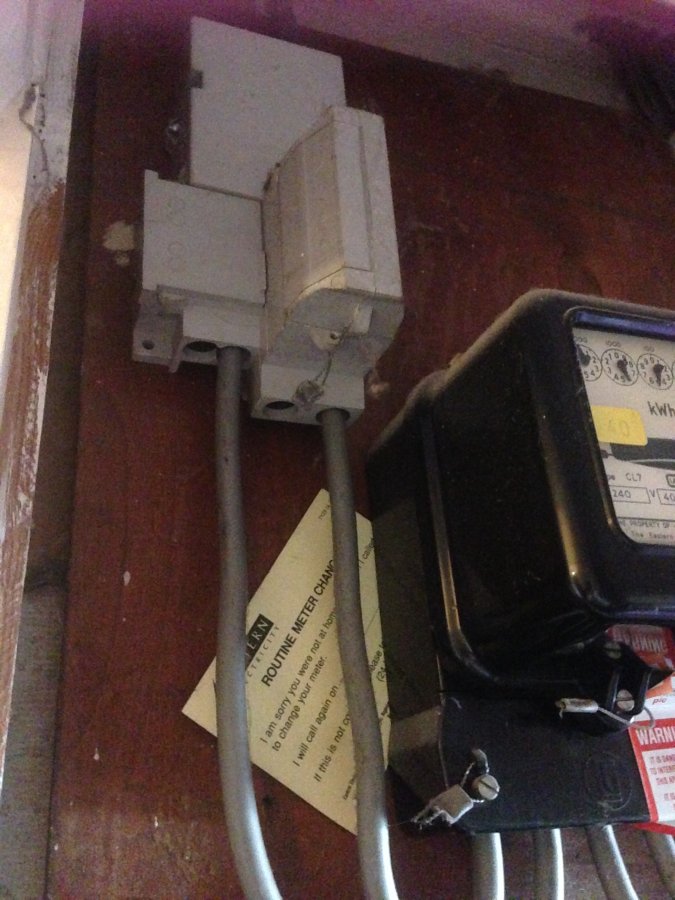

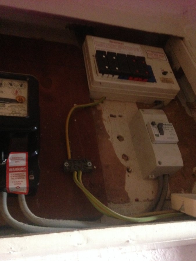

Trying to clear something. Up here as there are so many conflicting answers.
I'm getting over 200 ohms earth loop at sockets in a property on a TT earth arrangement, what is the maximum permissible ?

200 ohms is the max for reliability in guidance docs.
The max in the regs 1666 ohms for a 30mA RCD protected socket circuit (50v/0.03A=1666 ohms).
So although the theoretical maximum is above 200 ohms, this should not be exceeded as it is considered unreliable.
200Ω is the guidance max for the earth electrode itself. With no bonds to other services in place.
If you get 200Ω+ at a socket, you need to check on your bonding and investigate improving the Ze of the earth electrode.
PS I hope that is a 30mA RCD, and it is running to spec.
Ok so to get a proper correct figure disconnect the bonding to the water and gas (as pictured)?
I think I may get the service provider to see if they can PME the earth but obviously the Ze needs to be below 0.35 for them to do this, if so is the main rcd ok to remain?

Numerical spark - it's only 1 ohm, but I thought the regs said 1667, which I think is wrong, as it puts the touch voltage above 50V.
I used to be guided by the 100 Ohm maximum that ECA used to set (don't know if it's still the same).
If you have a reading above 100, investigate it to find out why.
OP - in the earth block at the intake, you have one to the CU and two others - do these go to the service pipes?
You may have a poor earth off the pipework and no earth electrode!
