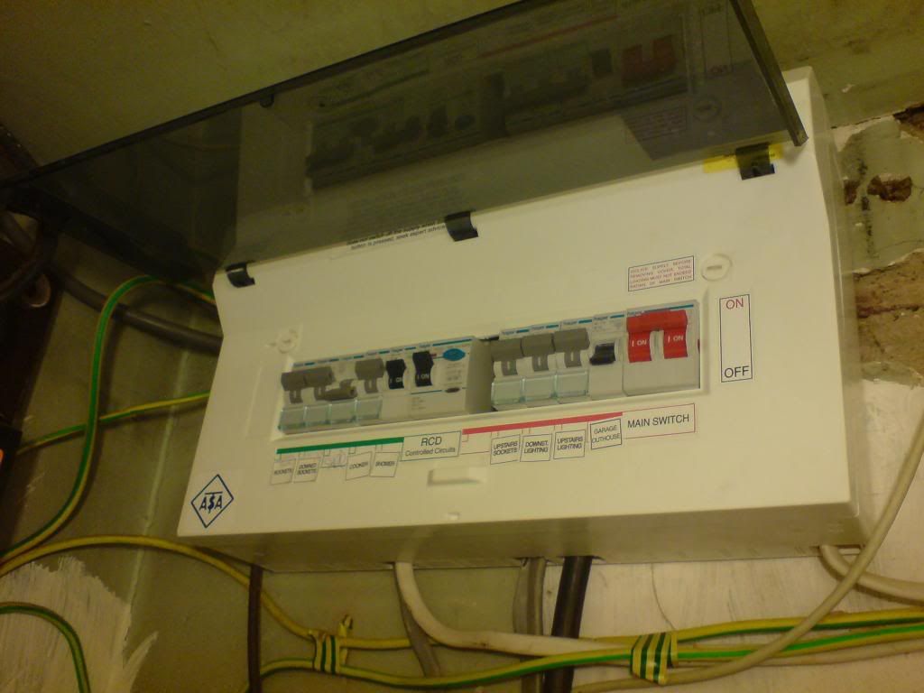

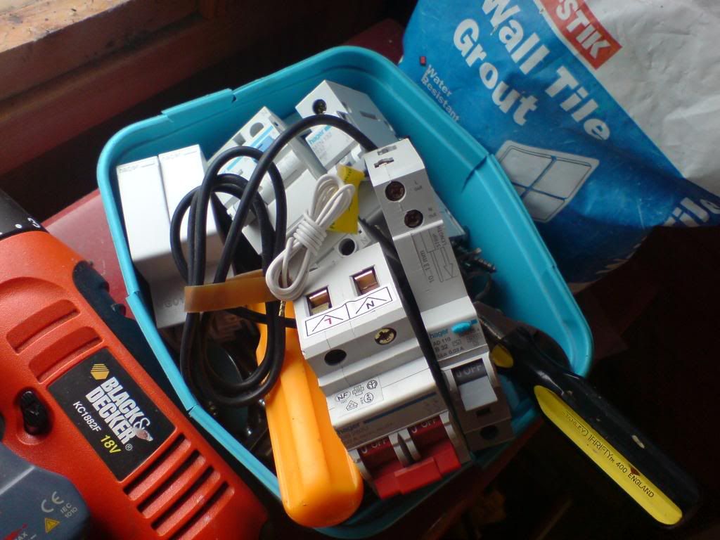

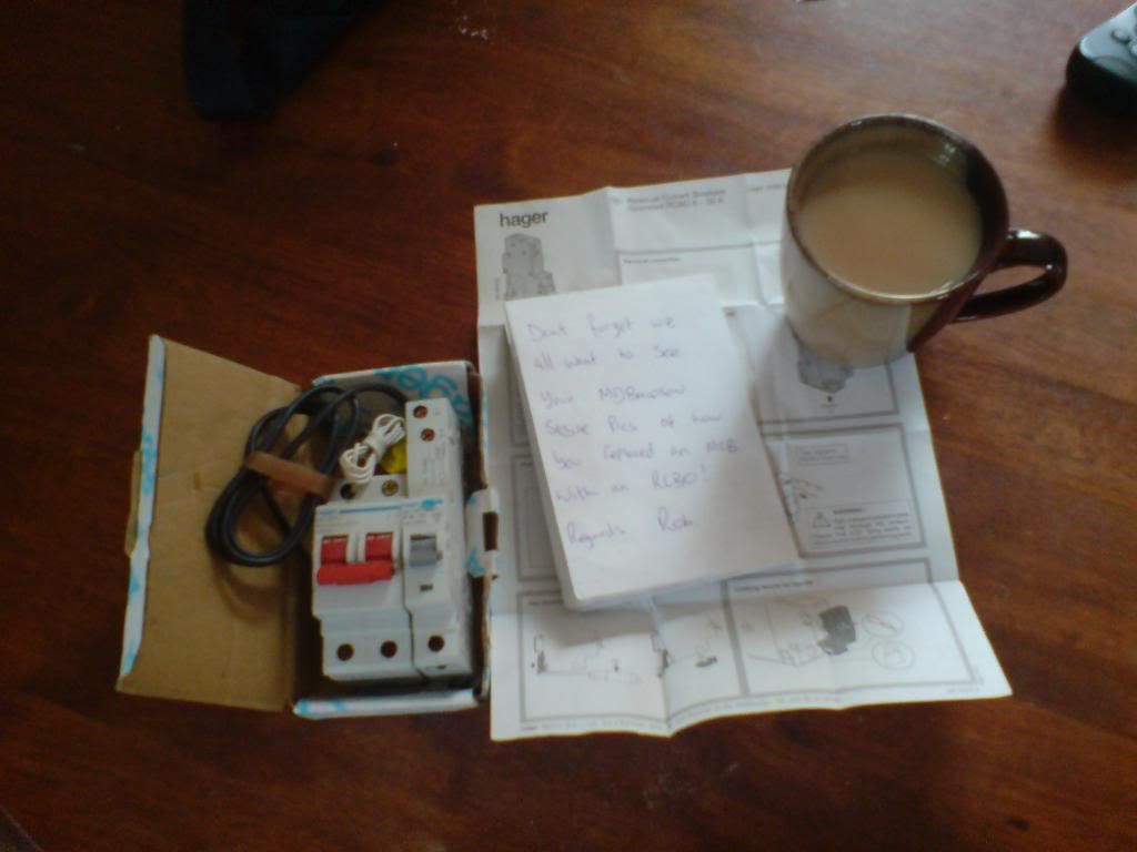

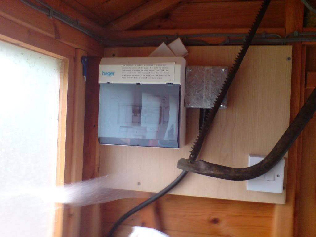

RF Lighting very kindly sold me an RCBO and a second hand 63amp mainswitch, so this morning i set to work fitting them in my shed.
First things first:
The note says "Dont forget we all want to see your MDbalson style pics of how you replaced an MCB with and RCBO"
Power off in the house:
http://i239.photobucket.com/albums/ff284/Crafty1289/Shed RCBO/DSC00826.jpg
http://i239.photobucket.com/albums/ff284/Crafty1289/Shed RCBO/DSC00827.jpg

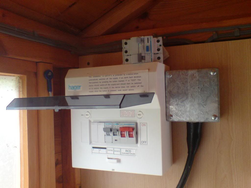

CU in the shed:
http://i239.photobucket.com/albums/ff284/Crafty1289/Shed RCBO/DSC00831.jpg

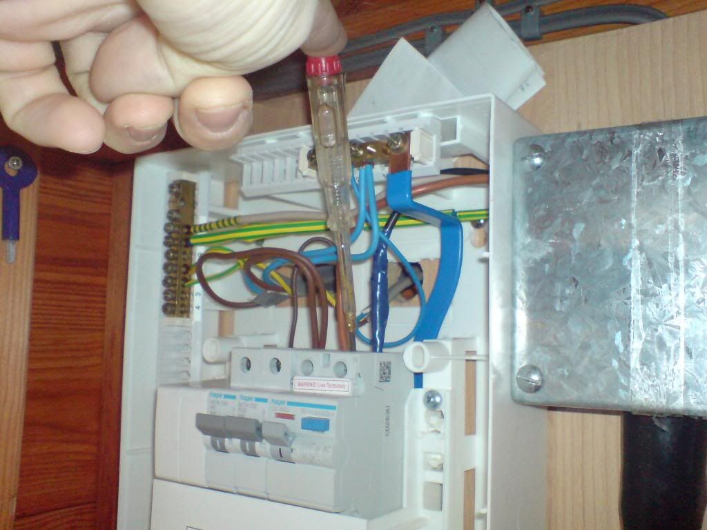

Testing for dead:
http://i239.photobucket.com/albums/ff284/Crafty1289/Shed RCBO/DSC00832.jpg
teehee, only joking. I did use an el cheapo multimeter, it read 0.4volts L-N.

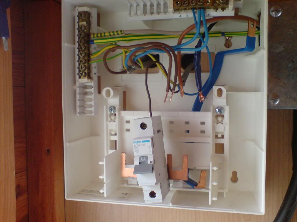

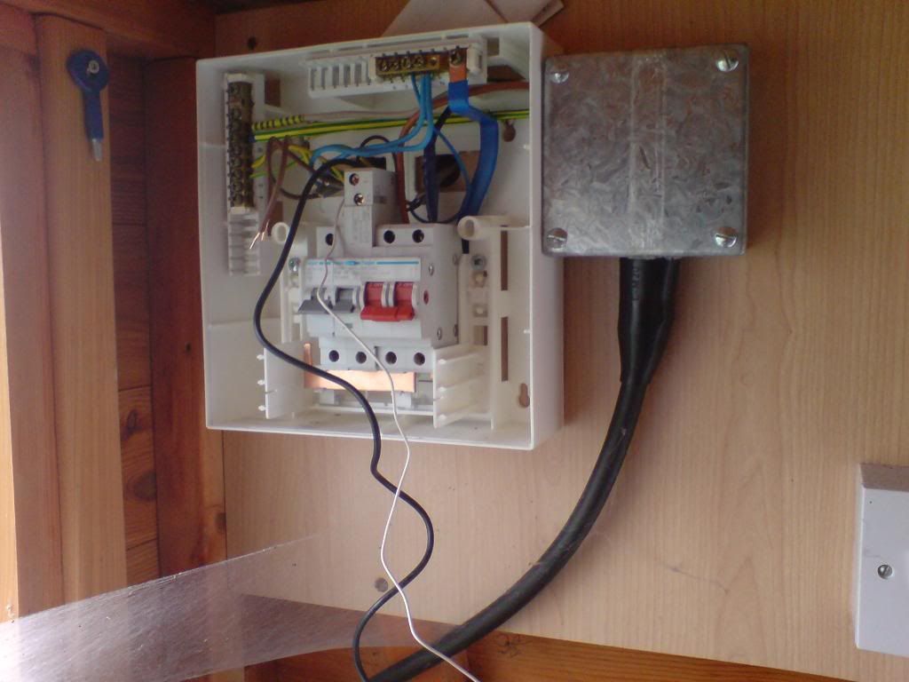

CU stripped down:
http://i239.photobucket.com/albums/ff284/Crafty1289/Shed RCBO/DSC00834.jpg
http://i239.photobucket.com/albums/ff284/Crafty1289/Shed RCBO/DSC00833.jpg

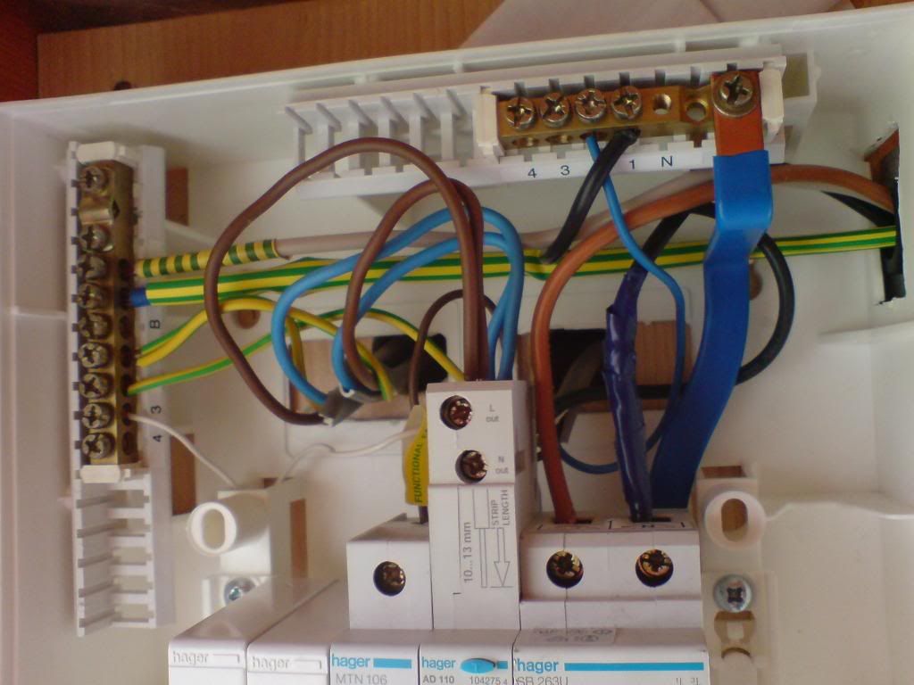

New stuff fitted - RCBO and mainswitch:
http://i239.photobucket.com/albums/ff284/Crafty1289/Shed RCBO/DSC00835.jpg
Wired up:
http://i239.photobucket.com/albums/ff284/Crafty1289/Shed RCBO/DSC00839.jpg
Closeup of the wiring:
http://i239.photobucket.com/albums/ff284/Crafty1289/Shed RCBO/DSC00841.jpg
All finished:
http://i239.photobucket.com/albums/ff284/Crafty1289/Shed RCBO/DSC00842.jpg
Eagled eyed viewers will note I cut short the tails on the RCBO. They were about a metre long! I have seen them curled up before (how do you do this? Does it involve winding round a screwdriver and applying heat?) Why are the tails made of very fine copper?
And I know the wiring could be neater, but I was working at an obscure angle from the right, using my left hand (i'm right handed). Is it just me (and my inexperience) or are the new colour wires stiffer than the old ones? Those XLPE cores were hard as iron! :shock:

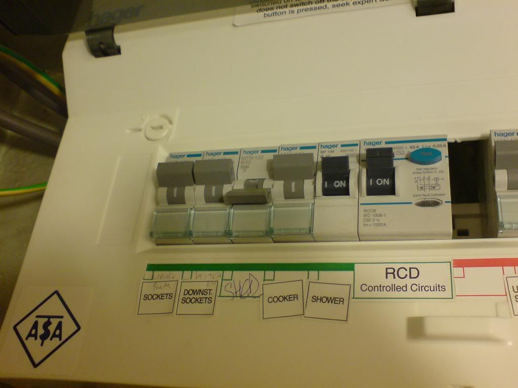

Anyway, cheers Rob! I just need to get the shed circuit off the house RCD now, and fill that pesky hole with a blank :roll:

you'll be wanting some ratchet crimps and heat shrink sleeving to tidy it up.
And a main isolator to get those ferkin tails out of the way :evil: What a stupid way to route them. To think, this was done by an approved electrician.
i'm not sure that stopping the shed light from getting tripped is worth the cost of reconfiguring the shed CU.
why have you started this RCD reorganisation drive? have you been having RCD problems?
JohnD said:
shed freezer planned?
I guess that would be a plausable reason, just make sure the freezer is not connected via an ordinary plug and socket.
Steve said:
...Eagled eyed viewers will note I cut short the tails on the RCBO. They were about a metre long! ..
have you still got the bits?
You still after some wire to extend an RCBO functional earth tail? Have you got an old fluorescent fitting, the wire in it may be what you're after. I have a 100m roll of it if you want an odd metre, email in my profile.
