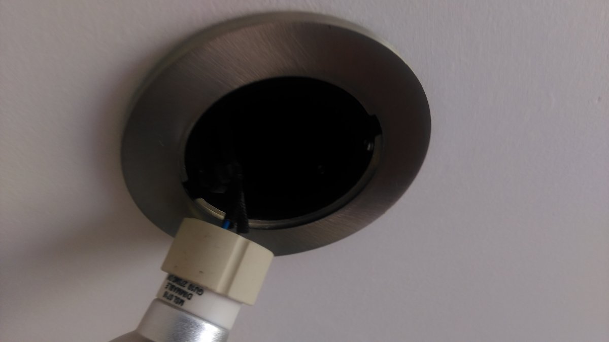

Terry, the flex is inside the the fitting, when you un-screw/pop out the LED lamp, the lamp hangs on the flex. You can do this without removing the rest of the fitting from the ceiling. I'll try a photo.....
You can just make out the black flex inside the fitting.
thanks got that ,but if you remove the actual fitting from the ceiling it will reveal more ,and possibly ,give access to the cables / jb's. as BG said above those testers are not brilliant ,do you have a multi meter ?. if you can be sure that you have 230/240 volts across the switches by measuring the voltage ,then the switches can be ruled out .it is more likely a problem with the switch or the conductors connections to them, but of course not exclusively .By the way I assume we are talking about lights that have been working normally for some time ,and suddenly you turn them on and they are not working ??

I haven't yet managed to take a fitting out of the ceiling......... Any tips for getting them out with minimal damage appreciated. Yes I have a Multimeter, yes can confirm 240v across the switches. Completely agree on the tester pens....... I use with extreme caution.
