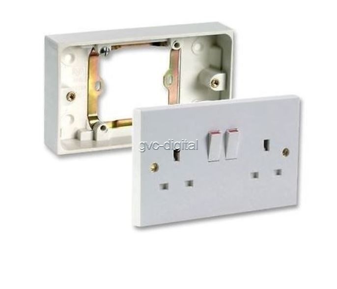

I've used one of those single to double sockets and I would definitely NOT use one again. When it was in use we sometimes found it really difficult to get the plug in, we would have to push it in a certain way and it would take us several attempts. When I took it off to decorate I found out why, the socket used cheap plastic components to hold the metal connectors in place, the plastic deteriorated and fell apart leaving the metal connectors free to move around. If you notice from the pictures, the screws to hold it to the back plate are right in the middle of the pin holes. The plastic screw covers fell off within a week leaving bare metal screws potentially in contact with the connectors inside. It still makes me shudder just thinking about it. I'll never use this type of thing again, it's the positioning of the screws more than anything.
I've seen in Wilkos (!) socket boxes with a large cutout that screw into the existing backbox and/or the wall and take a normal double socket. Much better
Yes, that looks infinitely better than the one I had, screws on the outside, where they should be.
