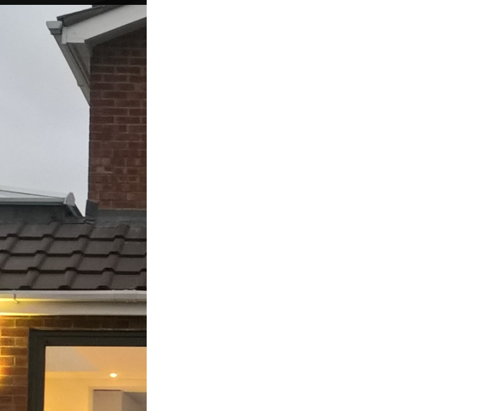

I thought it may be helpful to post a picture of the guttering run. If the consensus view is to add another down pipe, I'm unsure on where I do this.
Whoops...
sorry, my comment on "unsure on where I do this" referred to where I put the downpipe in my situation. Missing the attachment upload is down to my incompetence!
lets try again.

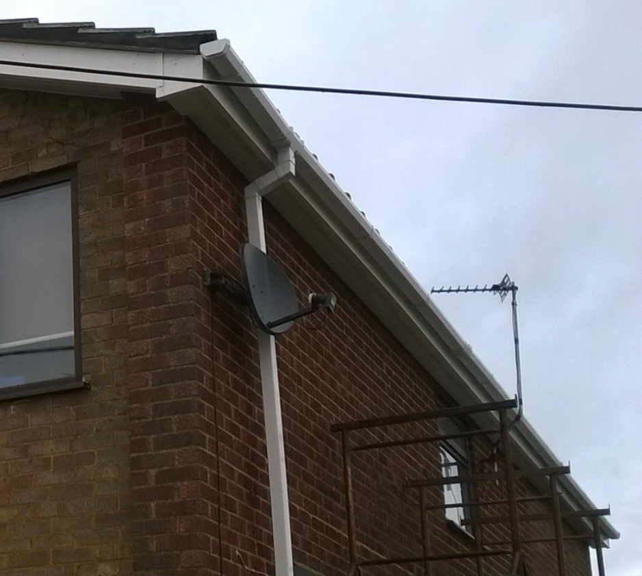

are there any drains at the back or maybe a bathroom gully in the middle of the run?
This is how it looks from the back. I could drop something down here but aesthetically, it wont be great but i am then probably creating another problem for this gutter as it may then start to overflow, etc.

You could put a downpipe in at that gable end going on to that roof at first floor level
