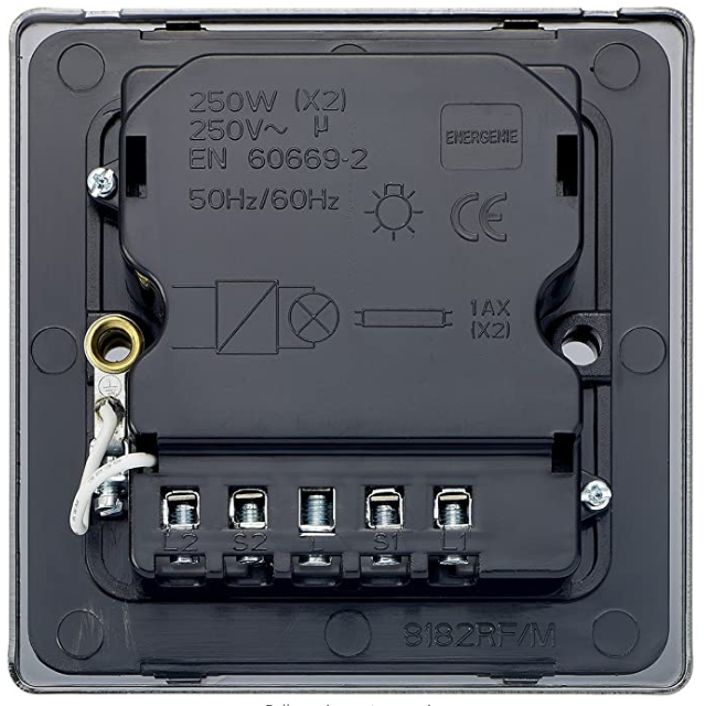

2 gang switch wiring different
Not the cheapest option but was looking at:
https://www.amazon.co.uk/gp/product...title_srh_1?ie=UTF8&psc=1&smid=A2OAJ7377F756P
https://www.amazon.co.uk/Energenie-.../B00V52HTXS/ref=psdc_1938304031_t2_B073VT51RQ
As think these might work, as no neutral wire required, look like same wiring (below) just need to set up a hub too.
That little bit of white wire could be taking an Earth into the switch to use as a surrogate "Neutral" This could result in a trip of an RCD protecting the circuit.

First point - fair enough, did wonder why it might be going through as thought you would usually just connected your earth to it.

I said the CE mark was counterfeit, why would the manufacturer use a symbol that could be mistaken for a valid CE mark.

Guessing you were going to potentially say about running a neutral? Won't work I guess!
I was hopeful, but not so now. As you currently have 2 permanent lives going to the switch from the same circuit, and your new switch only needs one, the other wire could potentially be changed into a neutral if you get to the other end of either of them, and obviously a neutral is within connecting distance. 18 Downlighters and presumably a nice ceiling makes that hard work though.

Annoying, my other option is just getting one that works on a remote and not smart enabled I guess and wall mounting the remote somewhere more accessible.
