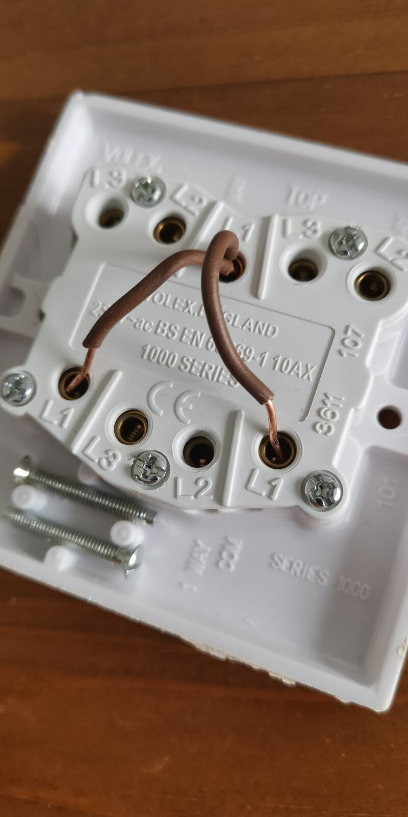

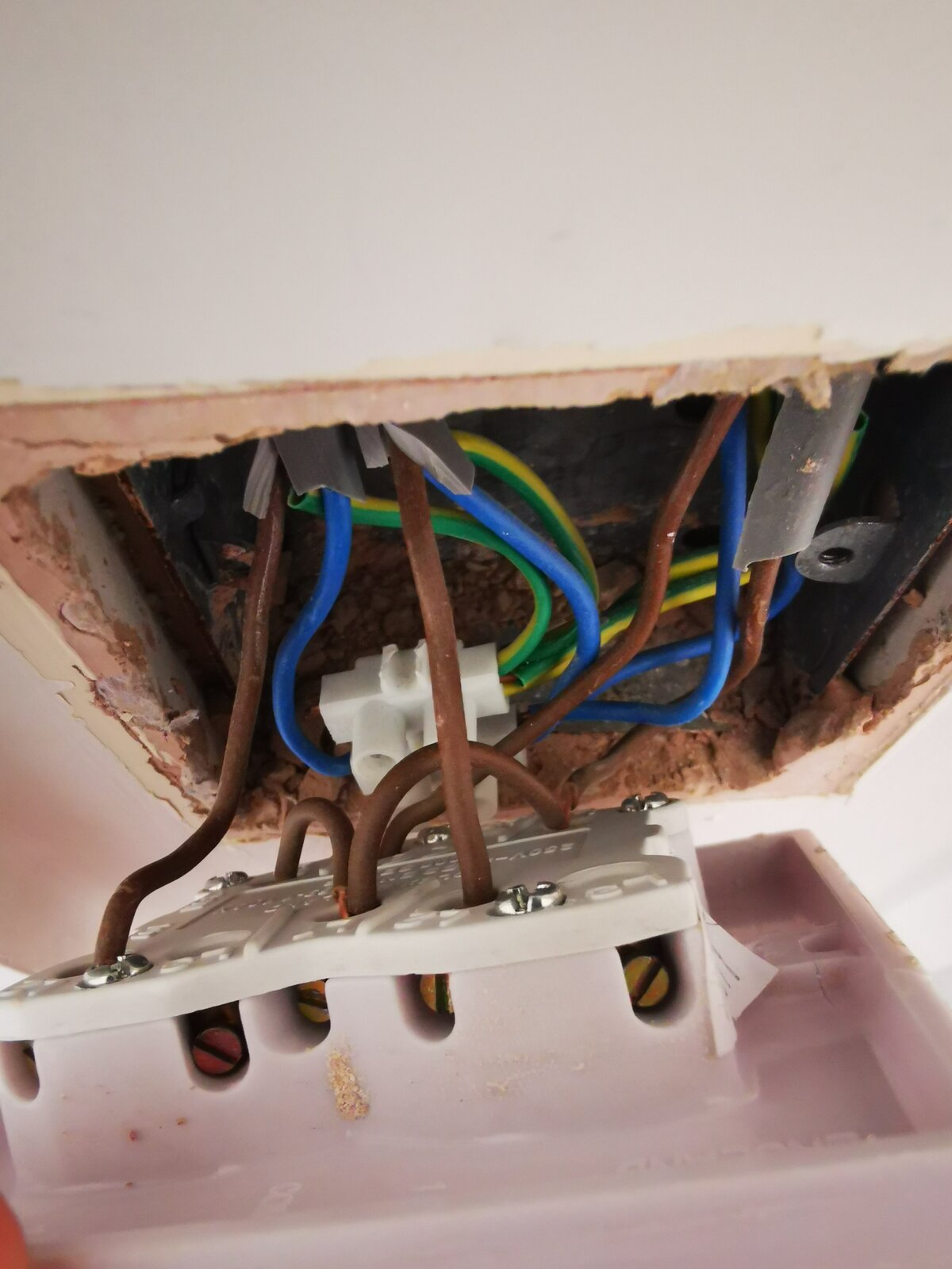

Trying to change a broken Volex light switch with a Click
Thats what it looked like when I took out the Volex switch I've mirrored how the cables went in with the click switch but lights aren't working. There all in L1 & L2's like the original Volex any help?

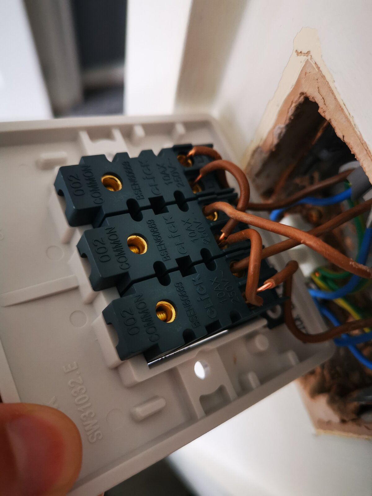

The labelling of terminals is different
Old Switch.........New Switch
L1......................Common
L2......................L1
L3......................L2

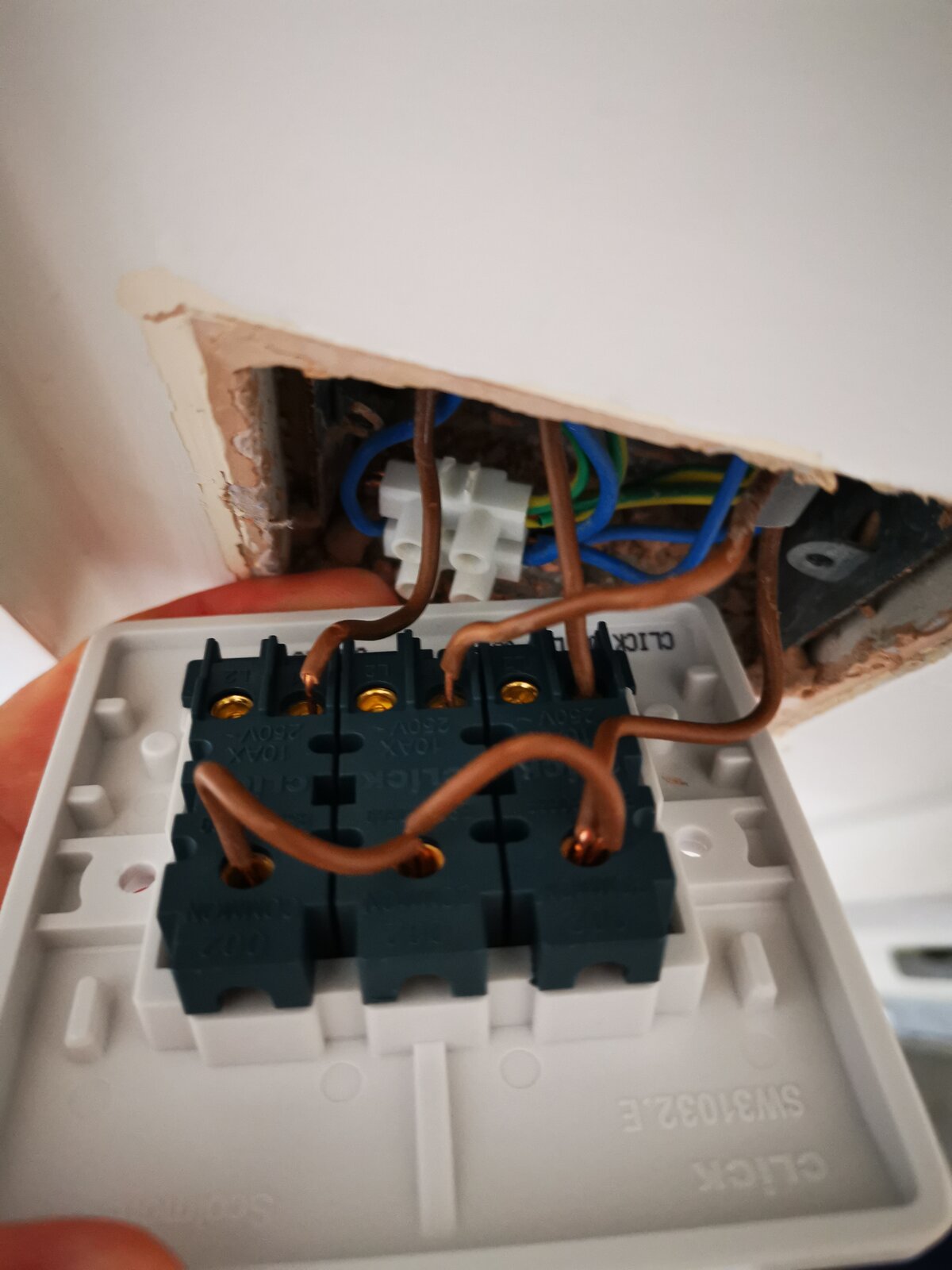

So I don't want anything in the L2 terminals then just common (L1) and L1 (L2)
volex/crabree use this silly numbering.
The problem is the COM terminal have no wires in them. They should have the brown loops in them (and the supply wire)
