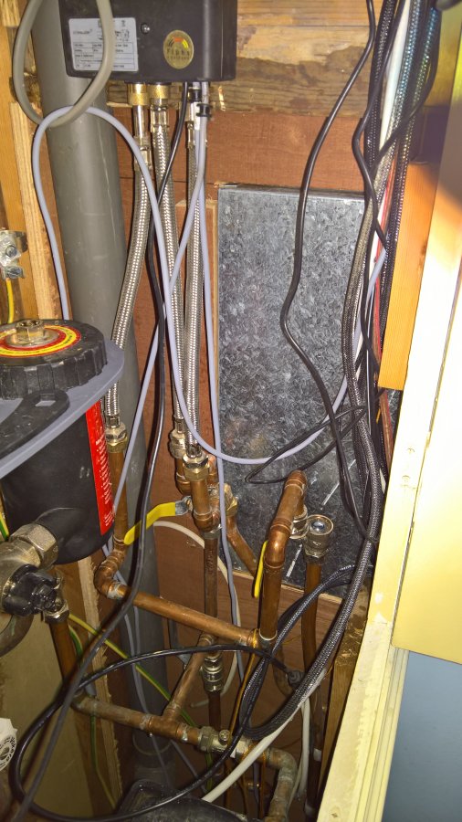

Got a phone call from a client today.

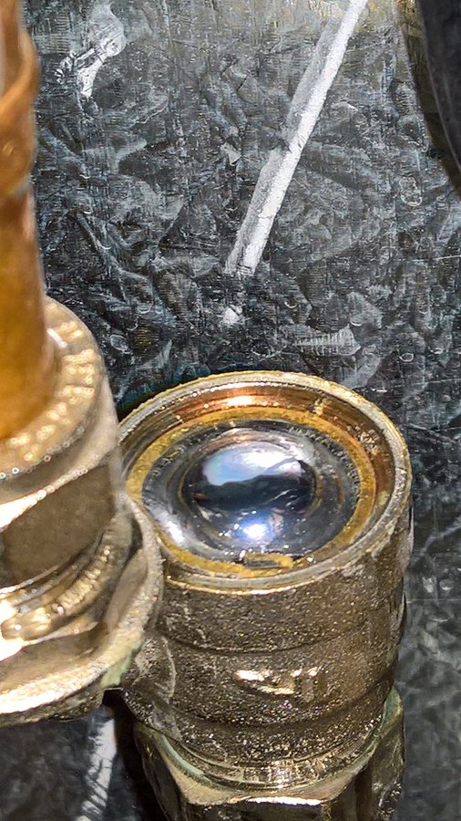

He had water peeing through his light fittings. On closer inspection he discovered that a valve that I fitted a little over 3 years ago had snapped.
It was one of these toolstation lever valves
http://www.toolstation.com/shop/p64716?table=no
For no obvious reason the valve snapped at the non-supply side of the housing, the top end just sheared off, exposing the ball inside. Fortunately it had only been gushing (combi pressure) water for about 2 hours before someone isolated it by turning the lever.
The valve was a hot water feed to their Crosswater bath mixer. It wasn't under any undue stress and the bath hadn't been used for a number of hours.
I will post the images later.
Has anyone else had valves that just decide to snap for no obvious reason?
I am now worried about the cold water valve to the bath (which I have turned off).
I had an AAV that snapped at the body/thread junction, during the night on a refurb. Supplied from Plumb Centre. I had to fork out for some major replastering, but I suspect that I got stitched up.Intended to chase PC/maker (Flamco?). But I was so busy in those days, i just never got round to it.
The valve (two thirds of a way down on the right hand side). WP_20161213_17_53_06_Pro.jpg

It has sheared/snapped.
The pipe work is in a cupboard in the WC room. The clients aren't the kind of people that would tinker with things. I have known them for years and trust them implicitly.
As far as I can see, it just decided to fail. Either it was faulty or I overtightened it when I fitted it but I honestly cannot see how it could be the result of over tightening.

It has sheared at a seam. I guess that the seam exists so that they could fit the nylon washer which prevents the ball rubbing against the housing.
No idea how they "weld" the bits together though.
I must say I've never made a study about it but I'd have thought the detached upper bit was screwed down onto the lower piece, holding the ball and whatever in place......brass would be soldered rather than welded.
Either way its certainly not your fault but I guess the punter realises that.....just a complete PITA. Failure after 3 years - are we ever in the clear :eek:
Bye bye profit for this day!
John :)
As ^^^^^^^^ looks like the thread holding the valve together has snapped.
