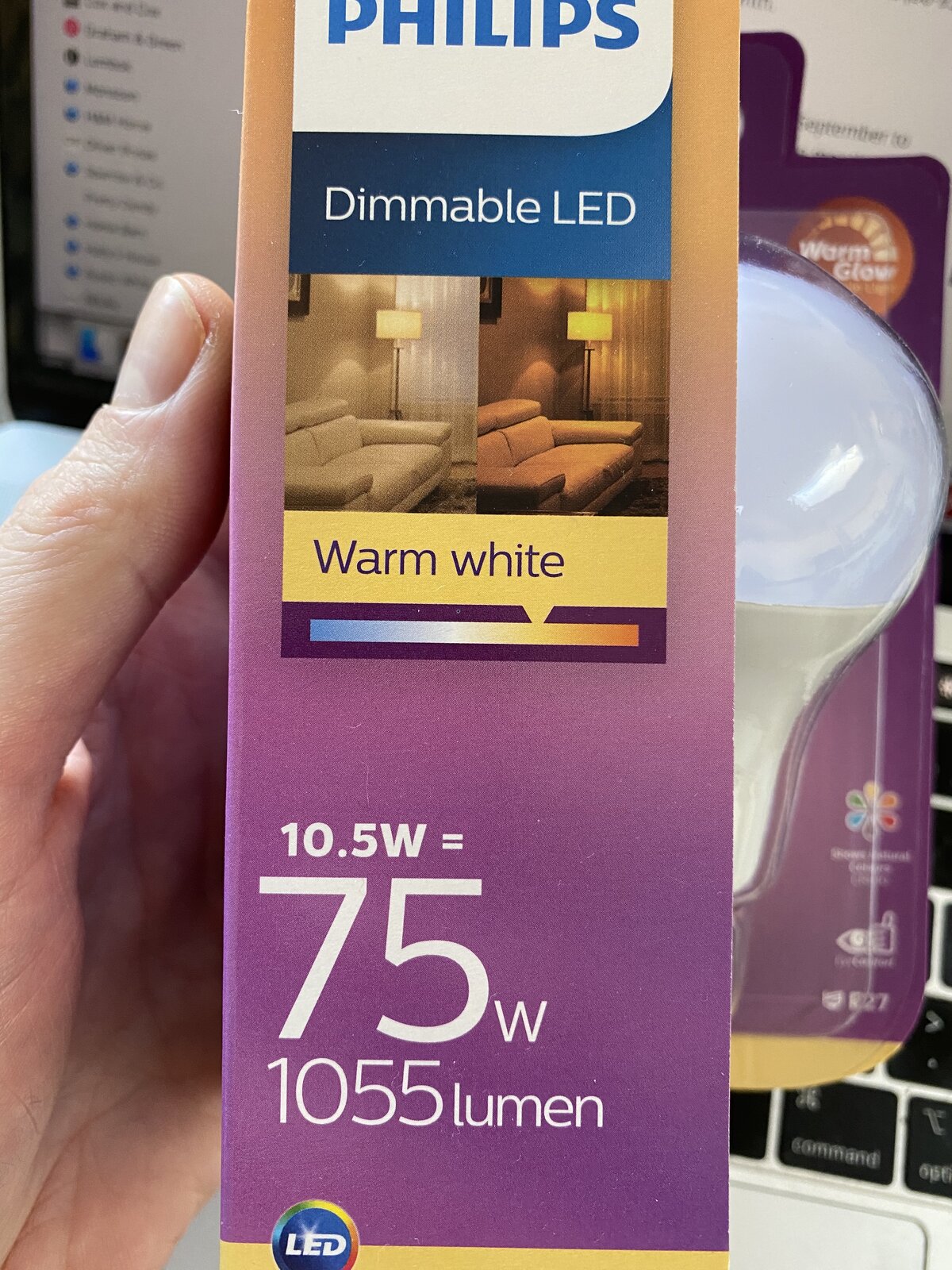

5 amp sockets keeps tripping - confused
Are there two RCDs in the consumer unit ? If so then maybe the Neutral for these sockets is in the wrong Neutral bus bar in the consumer unit

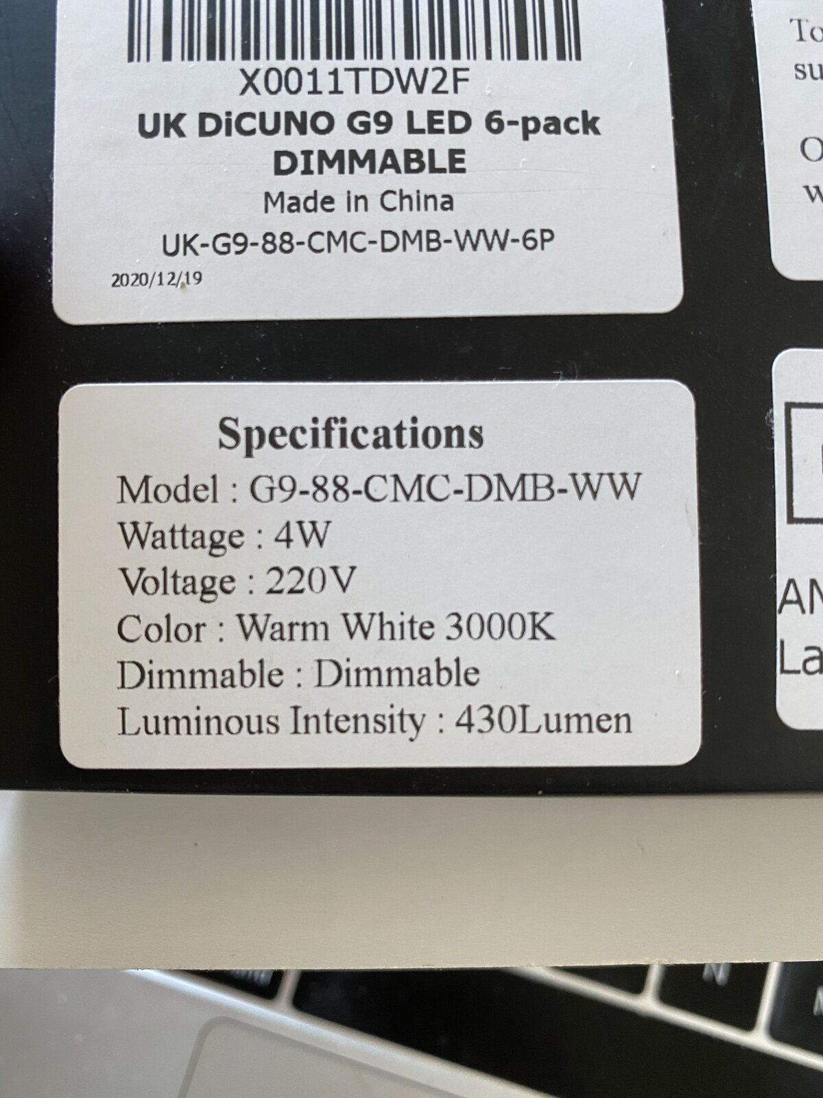

Why are you using 220 volt bulbs in a 240v country? Those bulbs are for China not here.

Just a thought, could the 5A sockets be on a non RCD lighting circuit and bedroom sockets RCDd?
Or have I read through too fast
I think it must be a cross-connected neutral. Need pics inside the board if the OP is confident
