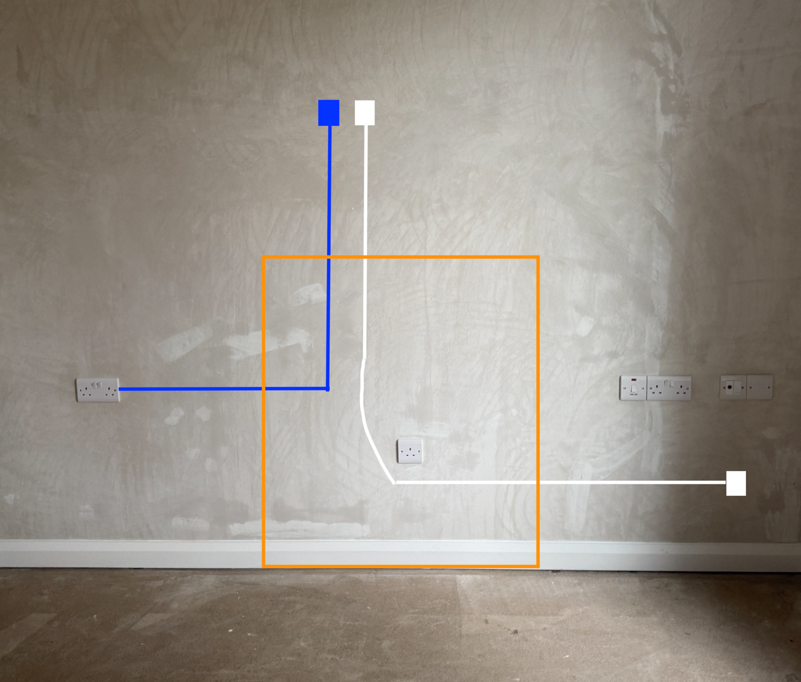

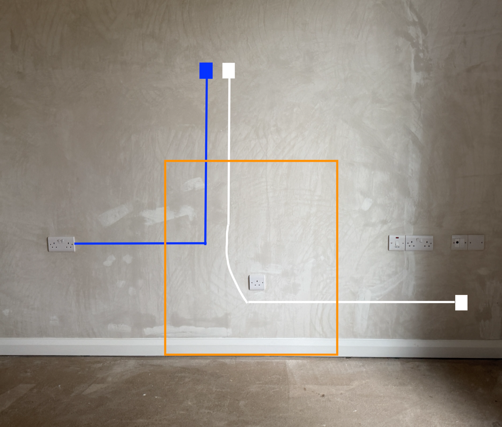

OK, I have worked it out.
Blue = Spur (easy enough)
White = HDMIs, Ethernet, coax
White Box = White brush faceplate
Orange Box = Fireplace
I will chase along the horizontal white line, fit 38mm conduit with clip off cover. Install leads and bring them out freely behind the fireplace (no chased angles). I will then chase a vertical channel from behind the fireplace to behind the TV and fit another brush faceplate for the cable exit. I will run leads into the vertical conduit and out behind the TV. Test everything. Replace conduit covers and repair walls.
Ho does that sound?

Plaster straight onto blockwork? That's honestly quite surprising/premium for a new build, you won't be complaining when you're fixing your TV there. Double check that it's not dot and dab plasterboard when you take the faceplates off.
If it is wet plaster finish, I wouldn't be chasing anything deeper than 20mm conduit in horizontally - you've maybe got 10mm of plaster before block, another 10mm+ and you're close to weakening the wall.

I should have been clearer too, the chase will be to accommodate 38mm (wide) trunking which is 25mm deep. But I don't want to risk any structural damage.

Even that's a bit ropey, 10mm plaster is a guess. They do make a 16mm deep trunking.
The other option would be to whip the skirting off and chase the concrete
Looking at the plans, the internal solid walls are 140mm deep, so I am expecting the external walls to be the same with the additional cavity and then final brickwork. If 140mm deep, then I should get away with a 23mm deep chase, right? I'll air on the side of caution though and go to 20mm. As long as I get a single coax and single HDMI into the conduit, I will be happy. Would they both go into a 16mm pipe, do you think?
I will be taking skirting off to lay flooring but would prefer not to start digging up the new floor.
If that were the case then yes 100%, but for a 38x25mm trunking you'd need to chase out about 26-28mm (which would likely still be OK with 140 thick walls). I'm confident you would get all 4 cables through a 38x16 trunking with the lid off. You might want run a leg down from each box to maximise your bend radius (2 into each).
Just make sure you're happy with what's going in there, pulling new cables with connectors through's not going to happen, if you're going to use trunking rather than conduit I'd glue the lid on when you're done so a tug of the cables doesn't rip your wall back open.

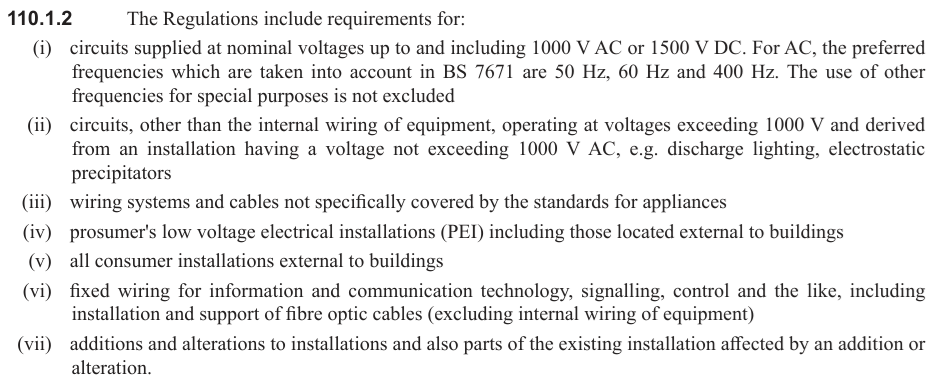

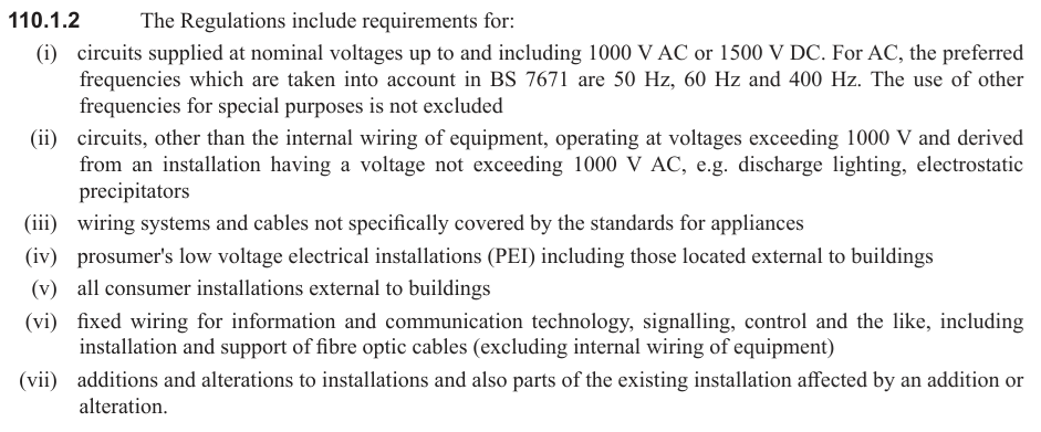

Doesn't that just mean that the regulations contain things which apply to HDMI & coax, etc, not that every regulation applies?
Personally, I have always understood it this way.
A cable is a cable, no matter what voltage and current it carries or is capable of doing thus.
Irrespective of whether it is low voltage (includes "Mains Voltage" or extra low voltage (including signal cables and tv/radio and other communication cables).
Therefore should be run surface or in suitable surface containment or buried to a suitable depth, hopeflly reducing the risk of accidental damage.
I am not overkeen on the 50mm/2" depth being sufficient in all cases for the simple reason that any substantial fixing might employ screws longer than that depth in order to achieve an adequate purchase) but hey ho that is the dimension decided upon by the great and good.
Why would anyone not allow similar rules for any cable purely for any logical reasons?
OK we might not need cables to enjoy the same very basic level of such protections merely for the sake of danger to Persons/Livestock/Property which is always the prime consideration of BS7671 but let us be guided by what (in my humble opinion) is the most powerful reg of all
(Good workmanship and proper materials, throughout!) .
Every cable is a cable is a cable.
Agree with all that, but as you say, the prime consideration of the regulations could easily mean that the measures required for safety for "electrical" cables are not required for signal ones.
(As an aside, re "substantial fixings", Corefix ones are very long not to get good purchase for significant loads but so that they will work to prevent D&D plasterboard from getting crushed.)
