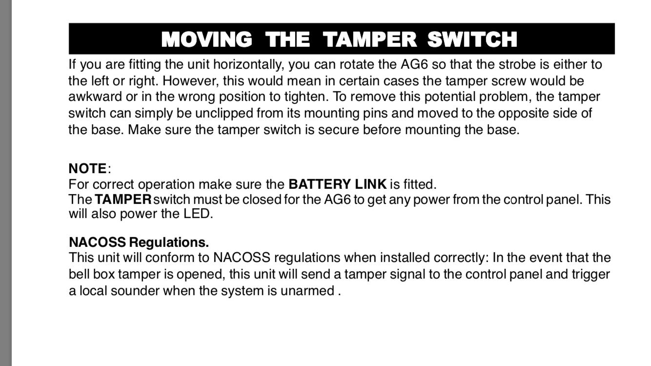

Is battery connected ?
No WHAT does it say in the above installation instructions for the AG6 bell box[/QUOTE

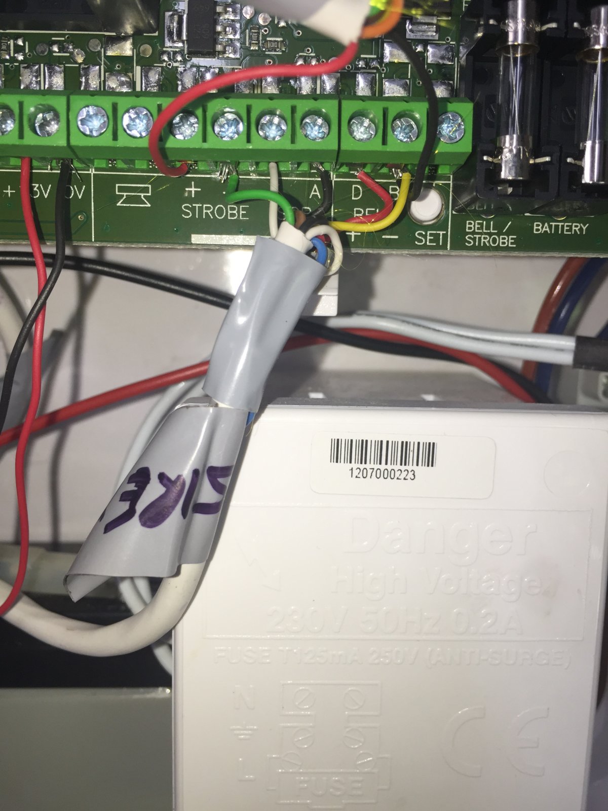

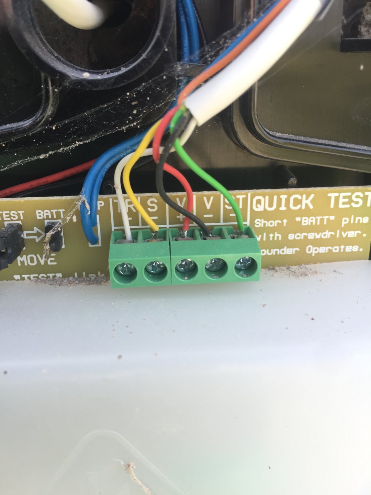

Ok here’s my connections, I’m a bit lost as to where this link is in the AG6? I can see to the left of the AG6 connections “batt”?

So no you haven't fitted the battery link ( picture 2 ) remove from test and fit on battery ...

Ok, so it’s the terminal to the left “batt” should a link have come with the AG6 (nothing in the box) or do I have to buy a specific type of battery with the correct link? Thank you for your help so far .........
FFS ....ITS THERE IN PLAIN ENGLISH .....REMOVE LINK FROM TEST ...PUT ON BATT....JESUS....
Thankyou - I wasn’t aware those links were removable - swapped over and working perfectly - your Diazepam is in the post! ;-)
