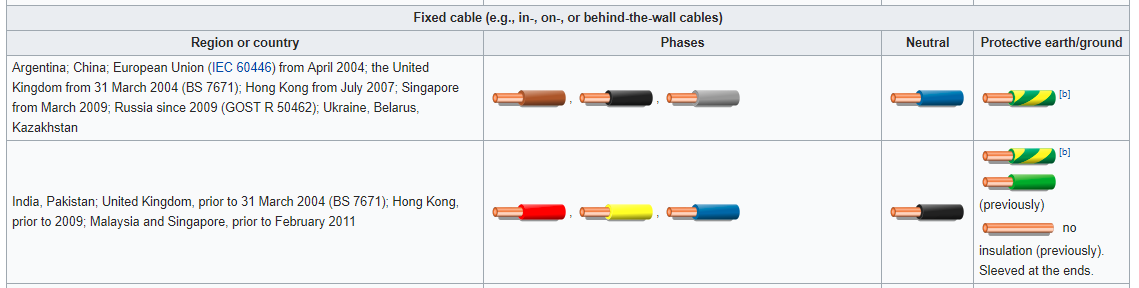

If the wiring is from 1965, it may be worthwhile looking for evidence of green residue on the cable ends, in the back boxes, or on the back of the fittings. PVC Cables from 1960-1970 ish had an issue where the plasticzer leaks out of the cable making it brittle. I certainly found exactly this on a couple of cables in my home dated 1965.
Note the little b in the picture which states
Cables may have an uninsulated PE which is sleeved with the appropriate identifying colours at both ends, especially in the UK.
Note the little b in the picture which states. Cables may have an uninsulated PE which is sleeved with the appropriate identifying colours at both ends, especially in the UK.
So it does - FrodoOne obviously missed that, too. Mind you, I think it's still a bit misleading, since that "may have" belies the fact that such is actually the norm in the UK.
It also makes one wonder why that column in the two 'rows' differ. The second row (which also has a 'b' next to the G/Y-insulated conductor also depicts a bare CPC, with a description saying "no insulation (previously). Sleeved at the ends.", which seems redundant (and would be equally applicable {without the "previously"} in the first row)!
Whatever, I presume that all of us in the UK can agree that 'the norm' remains for the CPC in multi-core fixed-wiring cables to be bare, usually with G/Y sleeving at the ends. I don't even know whether one can get 'fixed wiring multi-core cables' (i.e. not flex) in the UK which has an insulated CPC, can one?
