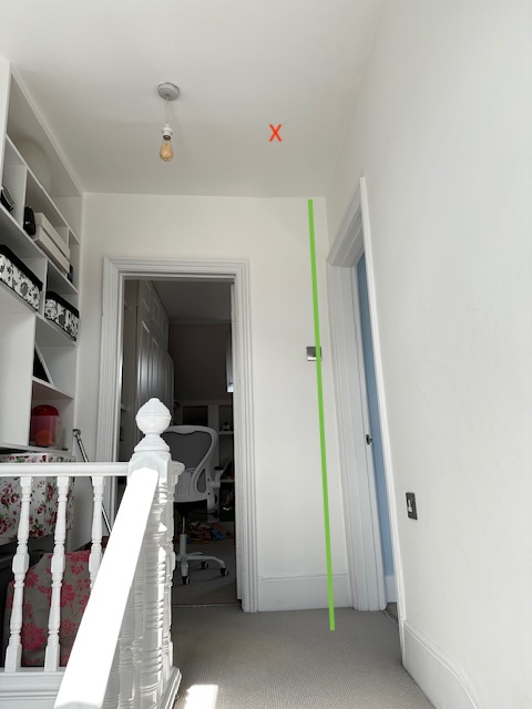

Ok, so after a week of easter hols, feeling a bit more refreshed to make some progress on this one. I am starting from the top floor, as the lower ones are much easier >> Just lift carpets, open floor board and run wires. The Top floor is the difficult one.
I am looking to install the smoke alarm where the red X is, which is about 300mm from each wall (and then on the same spot on each floor further down). The green line represents a void that I plan to use, which runs all the way into the basement. I do not plan to use the existing lighting circuit, as that is not the same as the downstairs one feeding my other smoke alarms. So planning to run a fresh 3core+CPC from X, to that void and then downstairs to connect to the rest. Ceiling and walls are all lath and plaster, so need to be careful.
Any ideas how I can find the studs/joists?
I tried one of these electric stud finders (with deep mode as well) and also a simple magnetic one, but nothing found. On the lower floors they run front to back. I am a bit concerned that the joist construction around there is somewhat unpredictable. Best case here is that the X is just on the edge of one and I can freely run a cable into the green void, but with my luck it's probably not the case and I need cut many large hols and fiddle somehow though the joists...

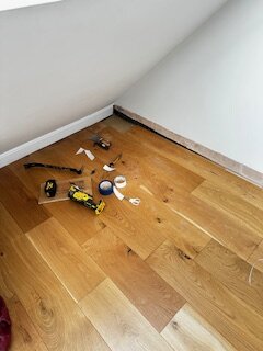

I've removed the skirting and cut out one board, hoping this would be a floating laminate floor, but unfortunately the T&G are glued together, so no way of removing them easily..

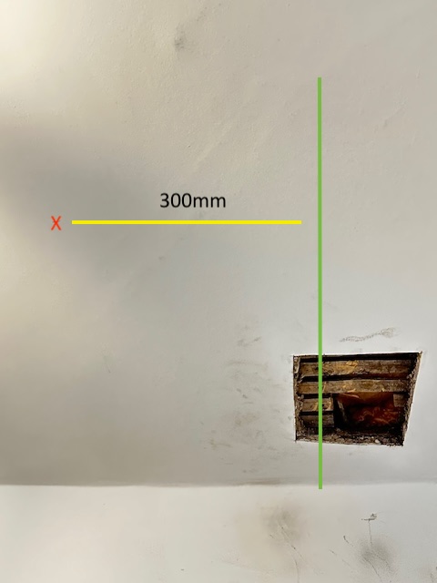

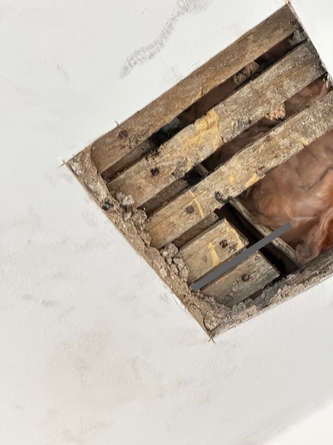

I've cut a hole in my ceiling now...because... why not... the plaster was bloody 40mm thick and the lath screws are super old. Even with no plaster in between my magnetic stud finder did only just about hold on to them.. The centreline of the joist is where the green line is, and the planned location for the fire alarm is just 300mm away, so on theory there is only that one joist to bridge.
I don't want to notch the bottom part of the joist, and since these are roof joists, cutting holes might also severely impact their stability. Could I just fiddle a cable between those two laths and then cover everything up with some toupret tx110? Or would the cable keep cracking the filler? I probably cannot go over the joist, as the loft is boarded down. How would you run the cable over from the red X to the square hole?
n.b.That white cable you see there is actually going to the light, but it crosses somewhat further down and I don't want to remove any more ceiling.
No, do it properly and drill a hole in the centreline of the joist. It should be between 0.25 and 0.4x the total span (so not near the end bearings and not bang in the middle). Cut the tongue off the board you need to lift and drill from the top if your ceiling hole isn't useful.
Alternatively, you could just get an extension/long bit and drill up through your boards. It's a bit **** but it's only a loft.
