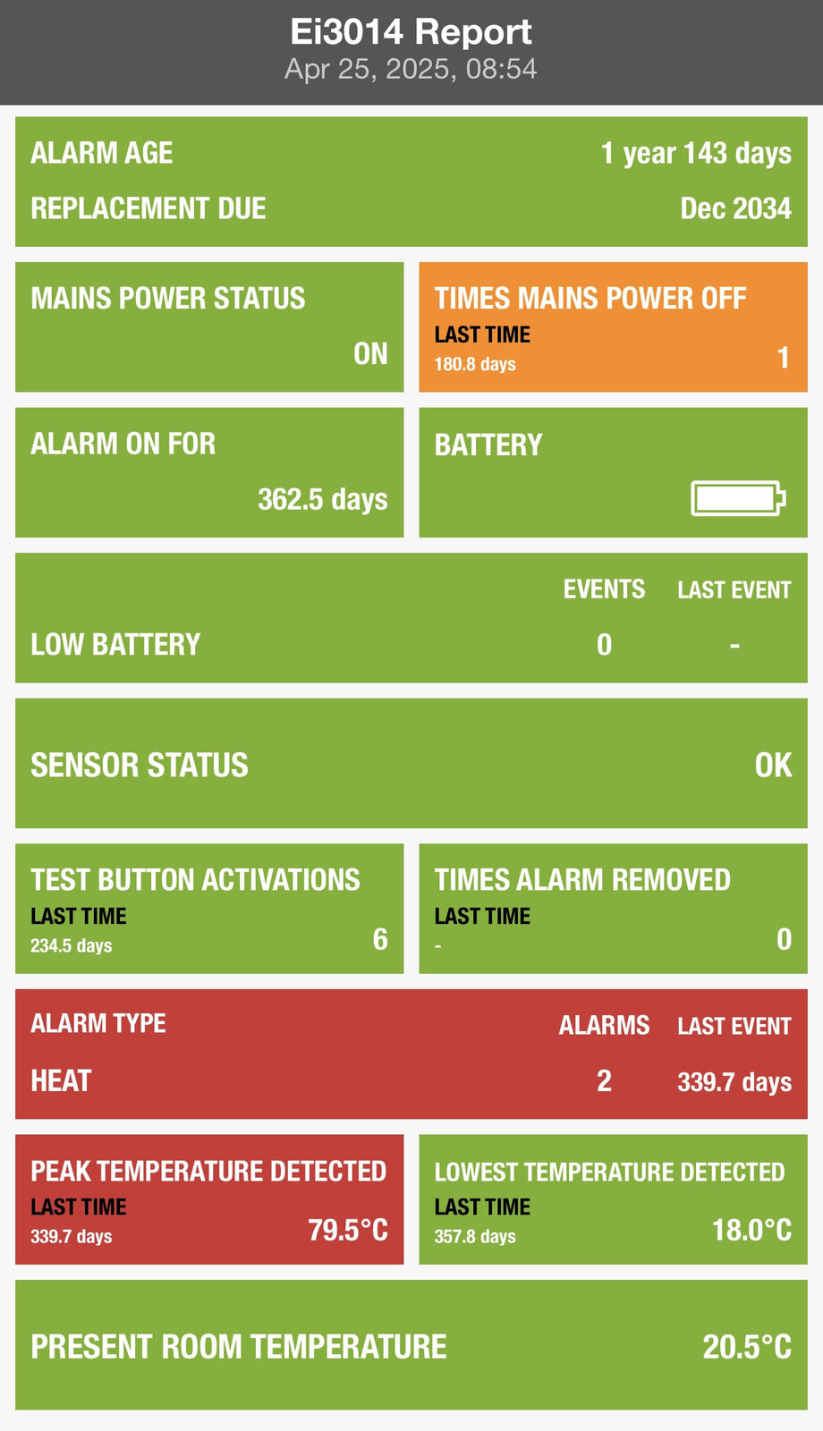

We had a fire about a year ago. A candle left on the kitchen island at bed time. The heat detector caught it before any damage other than a smoke blackened ceiling occurred. They detect a rapid rise in temperature, not a 'hot day' scenario.
The heat detector noted a peak of 78degrees c - the 3000 series can log this data to an app, by pressing the test button for 10 seconds.

No we aren't using wireless, all are mains interconnected. But we could have added expensive wireless interlink bases. You press the test button 3 times within a few seconds, and set the mobile app to listen for it. The alarm chirps for a few seconds, and the new data is downloaded. I did it this morning to share:
I imagine this is most useful for landlords, to prove regular testing.
Again very interesting, but I'm still a bit confused. The implication surely is that, although you have chosen to hardwire the interconnection, they surely must have some wireless/WiFi functionality - otherwise how on earth could a 'mobile app' communicate with them?

That's even more interesting, since it indicates that the alarms not only can communicate wirelessly but that they also have significant memory and data-processing capabilities. It looks as if I need to do some 'reading up' :-)

No wireless internconnect. The mobile app records the audio that the alarm sends out when you press the test button quickly 3 times. It's entirely manual, and you download it as and when you need. It's called AudioLink+
They hold only the data shown I think, so the last trigger, and when it was, and a few other bits.

No wireless internconnect. The mobile app records the audio that the alarm sends out when you press the test button quickly 3 times. It's entirely manual, and you download it as and when you need. It's called AudioLink+ ... They hold only the data shown I think, so the last trigger, and when it was, and a few other bits.
Goodness. I definitely do need to do some reading! I wonder if mine can do this - does "AudioLink+" come as standard in 3000 series alarms, or is it an 'optional extra' (and, if so, at what cost?).
It is standard - I didn't even realise until I read the instructions. The app is reasonable, allows you to test all alarms and then email a report - handy if you need to demonstrate regular testing.
