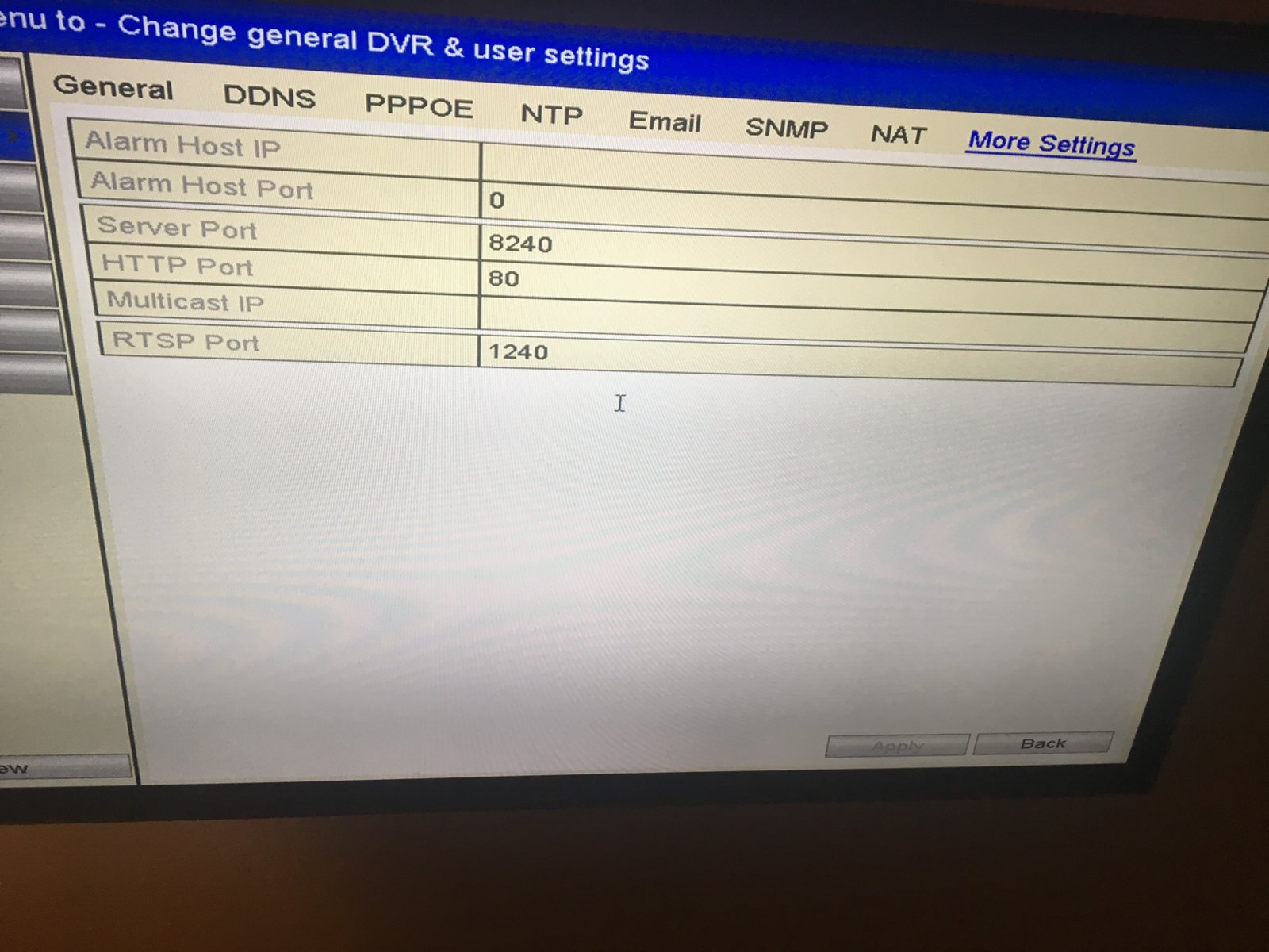

I am able to view my CCTV cameras on my iPhone whilst at home but would like to do it remotely on the alien DVR app.
I have followed their instructions on port forwarding but I am still struggling. I didn’t want to write war and peace but is there anyone who offer guidance to get me up and running please?

Hi both, sorry for the delay in replying. Just away with work at the moment. The router is the standard Plusnet version supplied for fibre. It does appear to have a plug and play feature but wasn’t sure if that could be used so set about following
the how to guide on the alien DVR site (but thanks for the suggestion). I have followed it point for point and checked the ports but show it as closed.
A couple of things occur to me: I have to setup two ports 8000 (8000-8000) and 554 (554-554) with the suggested ranges. Looking at the setup on the router the server port is 8240 and the RTSP port is 1240 with the HTTP port as 80.
Does setting up the ranges Alien suggest capture my ports as above?

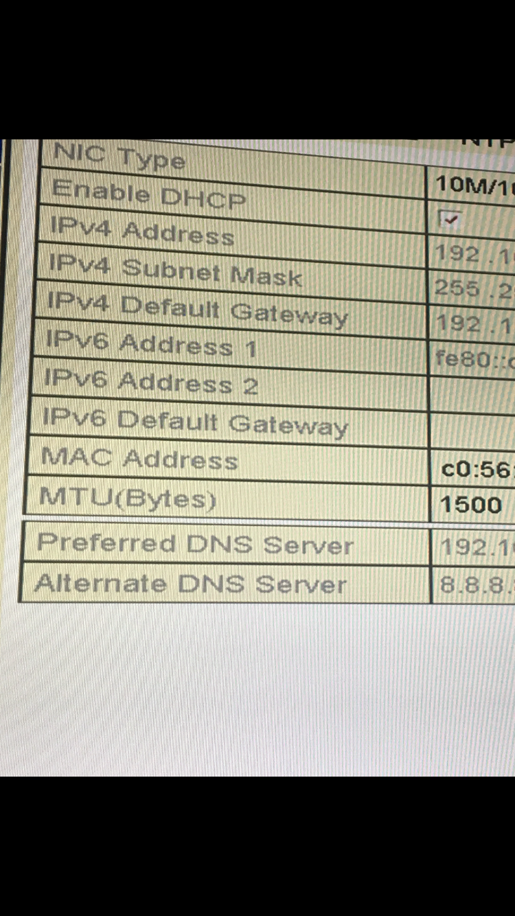

Also I am not particularly clear which IP address I should be using to view remotely, picture below. Can you advise please?

Hi Sparky, there are 3 in operation and the 4th shows NCR ( I think)
Works fine on my phone when at home on the WiFi.

Finally managed to sort it. The port references were not as per the references on the Alien guide. Changed them from 8000 and 554 to 8240 and 1240. Then added the public IP address to the app and bingo.
Thanks for your thoughts but I knew I wasn’t far off doing it
