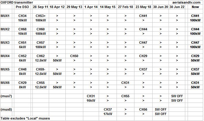

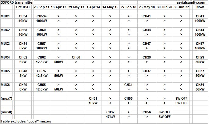

Hi, the Oxford transmitter uses channels 47,44,41,37,29,31, info curtesy of ATV aerials

If you already have strong signal from the Oxford transmitter then all you're doing with an amp is adding noise and reducing the signal to noise ratio (SNR) whilst boosting the overall signal level.
You actually make me wonder. Given that my signal is so strong, then if the problem is due to 'proximity of channels', I wonder if the situation might be helped by inserting an attenuator upstream of the sky box?
From what Trick-Dicky has told me about the Oxford channels, it sounds as if the Channel 48 I'm now using is probably a bit 'close for comfort' (to Oxford's channel 47) but, by the same token, suggests that the original channel 68 I was using is a long way from any Oxford channel
