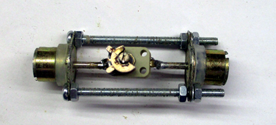

Somewhere I have some attenuators, but I haven't yet found them! So, being impatient, I've just thrown together a crude 'signal reducer', simply by putting a tiny variable capacitor (I think 15-20 pF max) in the signal path (see piccie below) - and that seems to have 'done the trick'. The Sky RF signal is now (at least to my eyes) totally clean throughout the house, and the DTV signal also remains OK (i.e. adequate) throughout the house - and all that whilst still using ch48. Adjustment of the variable capacitor is in no way critical, so I could easily substitute a (very small) fixed capacitor and make the whole thing physically much smaller.
So, although I'll certainly try the filter when it comes, it seems that I probably have 'a solution' without it!

The RF converter/modulator in a sky box passes RF from around 48 to 860MHz not just UHF. (Because Ireland where sky is also marketed used VHF for analogue TV). This means that any local strong signal below the UHF band could get in and cause cross mod in the modulator. Clutching at straws but something to be aware of.
EDIT. Your capacitor would have more attenuation the lower the frequency.

Exactly - I was avoiding 'technical terms', but that cross-modulation is precisely what I was referring to when I talked of 'brute force' interference - and is the reason why a low-pass filter (such as a 4G one) or a UHF notch filter (on Sky RF channel) would not inevitably solve problems.
Indeed so - but, pragmatically, the relative attenuations it is providing at (known) wanted frequencies and the (unknown) frequency of whatever is doing the interfering appear to be "doing the trick' satisfactorily (i.e. getting rid of the 'unwanted' whilst retaining enough of the ';wanted') :)

...and the 'signal reducer' is a work of art! :)
Thanks, but I have to say that aesthetics were not high on my priority list! As for the description I had to call it something, and 'attenuator' did not really seem appropriate, hence 'signal reducer'! Anyway, whatever one calls it, it certainly does seem to do the job. I suppose that the filter (which still hasn't arrived) might be fractionally 'better', but I'm not sure there is enough scope for further improvement for it to be noticeable to my eyes!

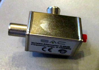

What would be interesting is taking the 4G filter out of the equation, and then comparing the capacitor to a standard wideband signal attenuator.
In fact, I'd go one step further and get hold of a 0-20dB variable attenuator such as the £6 ProCeption unit from Toolstation (lots of branches up and down the country, easy to check local branch to stock, click and collect ordering available to guarantee availability).
Try this before and after the Sky box adds its signal.
This would help point in the direction of whether it's tuner oversaturation or crossmodulation noise from outside the band.
What would be interesting is taling the 4G filter out of the equation, and then comparing the capacitor to a standard wideband signal attenuator. In fact, I'd go one step further and get hold of a 0-20dB variable attenuator such as the £6 ProCeption unit from Toolstation ...
Indeed. In fact, as I said before, I knew that I had some attenuators somewhere, but couldn't find them, but have just found a couple of them, one of which is a 0-20dB variable one such as you mention ...
Try this before and after the Sky box adds its signal. ... This would help point in the direction of whether it's tuner oversaturation or crossmodulation noise from outside the band.
I will. Watch this space.
