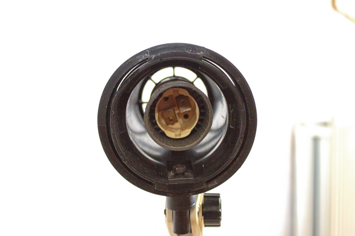

i need advice on replacing my Anglepoise type Lamp socket replacement.
The lamp is over 20 years old and when I put a bulb in it flashes as its not getting a proper connection.
Its a bayonet type fitting. I think the plastic in the bulb lamp socket has gone brittle with age.
I checked the plug etc and its all O.K.
What sort of socket do I need to replace it?

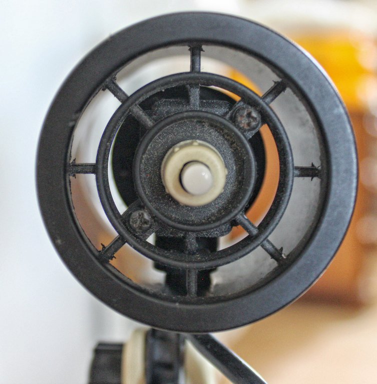

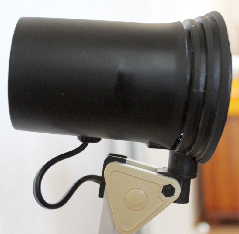

Here are some pictures of the lamp. It has a switch on the middle in the back where the holder is screwed in shown in picture 2.

As well as lifting the terminals slightly if you could give them a gentle rub with very fine sandpaper or wet and dry that would help
Have you tried a different bulb?
Lots of cheap imports have small circular connections whereas decent ones have oblong shaped connections
Lampholder terminals don't appear too shabby - could possibly be the switch contacts as much as the lampholder and/or lamp.
Try other lamps to see if it's, as suggested earlier, the lamp rather than the holder...
Ask Anglepoise for the parts to fit your specific model to repair / upgrade if necessary?
Dismantle the switch and check/service its contacts.

Then when I tried again and put the bulb back in a bit broke off the holder and it was discoloured and brittle.
Were would I get a new bulb holder? Its not an official Anglepoise just that type.
I think you will struggle to get a replacement the same as that one unless you know the manufacturer. Perhaps if you posted a pic of the old lamp assembly someone might be able to suggest how to modify it. Other than that there seem to be plenty of cheap desktop lamps available with a google search.

However, if we had a picture of the disassembled parts of the existing "device",
and how it is connected to the push-button switch,
it may be possible to suggest a way in which some available bulb holder could be modified to fit .
(By the way, is the switch working properly or does it need replacing also.)
After all, it is only the external plastic parts which may need to be modified - not the internal "electricals".

Look for BC (bayonet connector) B22 lampholders... and try to match pics / fixings etc.,. to the one you have..
https://www.lampspares.co.uk/bayonet-bc-b22-lampholders/ is one place... CPC/Farnell may have some...
Or you could replace with an Edison Screw ES type if desired.

I took out the screws that held it and looked inside with a torch. There was no way that I could see how to detach the holder though from the wires. There were no screws or clips visible. Most of the lamp will be recycled as its made from aluminium. I also kept the weight part and the springs. You can only try your best I m not an electrician.
