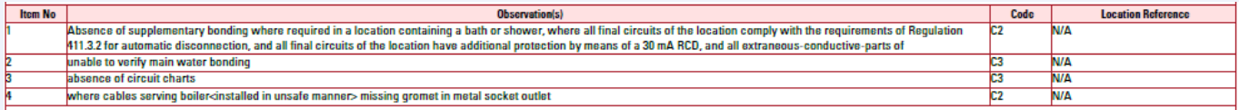

Hi there
Apologies in advance for a long post. I have got an EICR done for a typical 3-bed end of terrace rental house last week (sourced through OpenRent). The house has a main consumer unit and an additional one for the converted garage (bedroom + shower room). The report has come out today as 'Unsatisfactory' with two C2 and C3 observations each as attached (hopefully you can read it).
There are no further details in the report about these observations or recommendations on what actions are required to remove these which I think is very unhelpful. Below is the extract of the report covering two consumer units.
The first C2 is for lack of supplementary bonding in the bath/shower area but the report doesn't clarify which bathroom or both. From the report, it appears that the first floor family bathroom (presumably fed from first-floor lighting circuit) is only MCB protected but the downstairs shower room is MCB and 30mA RCD protected.
The second C2 is for lack of grommet in metal socket for cable serving boiler. To best of my knowledge, none of the existing metal pattrasses has grommets installed which would indicate this issue is specific to a particular socket. Again there is no further details or photo included to help understand the issue.
This is my first experience of EICR so not sure what the next steps are, hence this post for seeking help. I would be contacting the company issuing the report for more details but would be grateful if you can offer any comments or advice on these observations or remedial works needed.

1.
701.415.2 - the relevant regulation - states:
"Where the location containing a bath or shower is in a building with a protective equipotential bonding system in
accordance with Regulation 411.3.1.2, supplementary protective equipotential bonding may be omitted where all of
the following conditions are met:
(iv) All final circuits of the location comply with the requirements for automatic disconnection according to
Regulation 411.3.2
(v) All final circuits of the location have additional protection by means of an RCD in accordance with
Regulation 415.1.1
(vi) All extraneous-conductive-parts of the location are effectively connected to the protective equipotential
bonding according to Regulation 411.3.1.2"
411.3.1.2 relates to the Main Bonding.
So it is difficult to know what is meant by the report wording.
2.
The Main Bonding should be verified - it might not be required at all if the water supply is plastic.
Should be C2 if MB is required and not fitted. If not required then not even C3 - but C3 is only 'improvement recommended'.
However, it is dependent on the Main Bonding being present if required - so it is his lack of inspection which has led to the C2 given for the wrong reason.
3.
What is a circuit chart? C3 not important anyway.
4.
Easily cured. Buy a grommet, cut it and fit round the cable. Hardly a C2 anyway.
If that is all then it is quite good compared with others seen lately since the new PRS legislation.
Item 1: You have 2 options. Either install local supplementary bonding in the bathroom linking the CPC of all circuits with any metallic services which enter the bathroom ie hot and cold water pipes, metal drain pipes, radiator pipes, cast iron baths* etc, OR install RCD protection to all circuits which serve this room.
Depending on the manufacturer of your consumer unit, it should be a fairly simple job for an electrician to swap your MCB to an RCBO.
Having said that, no RCD protection to the lighting circuits is a non compliance in its own right and should have been noted during the inspection, but let’s not go down that route!
It reads to me as a bathroom without RCD protection OR supplementary bonding which rightly attracts a C2
I’m imagining the regulation number quoted is an error and the wrong type of bonding not present has been selected on the EICR software.
But we don't know.
If SB is actually required. If not, then C3 for no RCD.
If he can't find the Main Bond, perhaps he can't find the Supplementary Bonds.

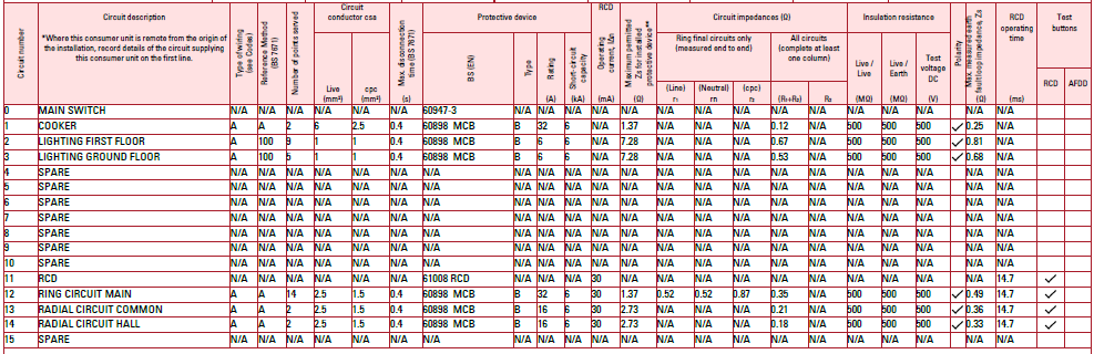

There are 3 MCBs in total which are not RCD protected (2 lighting circuits and Cooker). Not sure if a new RCD can be fitted instead to protect all these 3 circuits or I would need to install 3 individual RCBOs.
Three RCBOs would be better and easier than fitting an RCCB covering several circuits.

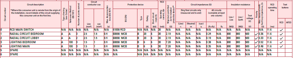

I had asked the tenant to inform me when the Engineer arrives as I wanted to attend if possible. The tenant called me in the morning advising the Engineer was at the property. He called exactly 20 minutes later to advise the Engineer has completed the work and has left. The tenant also mentioned that the Engineer told him that everything was fine. I will double-check with him. Maybe he got confused between gas and electrical engineers.
In general to price based on unknown work, which clearly it is, is hard. I remember commenting when doing my C&G 2391 on how to do the inspection and test on a board within the time given was hard, and this was with a board where everything could been seen and no walking seem to remember around 45 minutes to an hour, if one considers a house with same attention as that board then looking at most of the day, and since you don't know how long one would need to leave the day free, one could not really do two in a day, as you don't know how long it will take. And you have to make safe before leaving, i.e. repair or isolate any C1's.
So in the main people charge a days wages, yes win some loose some, but that is get away early or still there at 10 pm.
All my inspecting and testing was in house, so when you had no pressing work, you did inspection and testing, and clearly if you have fitted a socket last week, you know it's OK, so much of the inspecting and testing was visual, just looking for damage, the same applies when you did the inspecting last time, much only requires a glance to see it has not been touched and one can ignore it.
However how ever you price, you have to say up front what it is, and if you price at £50 plus £10 per circuit that's the cost, or £130 per day, that's the cost, or any other method of pricing. You can ring in the middle of test and say I have found xyz do you want it fixing, but if your charging per consumer unit, then if there is two, you would need to either phone and get authorisation, or only test the one, or do second for free. Unless you have agreed as I often do with a MOT if under £50 just do it. Then can't really charge, however likely if I could not get through on the phone I would do whole job, and cross fingers I would get paid. As said can't really do two a day, so all I have lost is time.
As said above, openrent/electrician have had your pants down, that eicr is clearly a work of fiction and a drive by test, the socket circuit ring end to ends are an exact result using a calculator, r1 x 1.67 = r2.
It is physically impossible to write out the top eicr pages, write out the db schedule of circuits, test the circuits correctly, write out the test results, carry out a visual for any non-compliances and do the job properly in half an hour, that is at least a 3 - 4 hour test you should of had done
It was stated earlier about replacing the upstairs lighting MCB with an RCBO. OK, but check the landing light isn't using a "borrowed neutral" with its phase coming from the downstairs lighting circuit and the neutral on the upstairs lighting circuit. :eek:
