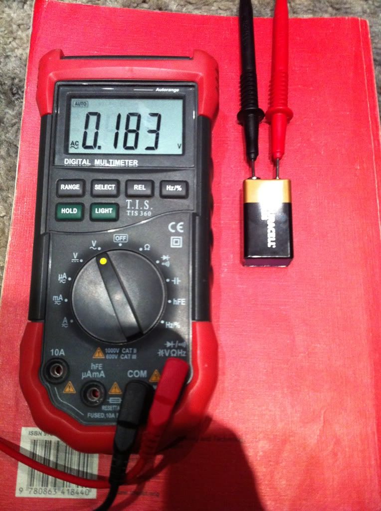

Anyone ever had a false positive testing for dead with...
Edit: My eX rated meter does not respond to AC on a DC range nor vice versa and it was not cheap!
Maybe I didn't pay enough, then (many years ago!) ...
The reading is a bit low, but that's to be expected because the meter adjusts so as to read RMS (not peak) values on an AC range.
Kind Regards, John.

That's interesting. I wonder if that's related to the fact that it's an autoranging meter? Mine gave lower readings on lower voltage ranges - but I showed you the result on the 600V range, since that's the one which would be used for checking 230V AC. A more realsitic test, in context, would be to use a much larger DC voltage. If I get time, I'll try that tomorrow - but it would be even more interesting with yours, since it's autoranging.
Kind Regards, John.
A Multimeter set to AC volts will only register AC volts, not DC. If anything all you would register is the ripple (which is handy for seeing if your capacitors in a PSU are failing).
Similar vice versa, a DC instrument wont measure AC.
So when was the last time you got DC on a AC circuit?
But I have seen a lot, AC induction on DC.
I come across distributed emergency lighting systems which operate on both AC and DC, AC for the maintained side of them and DC when on battery. So the answer is two days ago. :P
I use a fluke 73 and a fluke 77, both do what I said above - they don't give any meaningful reading when measuring AC when set to DC or vice versa

That's interesting. I guess I need to withdraw my previous 'rubbish' comment and substitute some apologies! However, it remains the case that I have never seen a multimeter which behaves as is being described. Needless to say, none give meaningful (if any) readings when measuring AC on a DC range - but every one I can remember has given readings (of varying degrees of 'meaningfulness') when measuring DC on an AC range. I must have a dozen or more multimeters scatterd around the place if I can find them, so I'll undertake a 'survey' when I have some time.
Mechanistically, it's quite hard to imagine how/why those AC voltmeter which don't respond to DC don't respond to it. The most obvious explanation would be a capacitor in the way, but I rather doubt that, unless it's done deliberately to prevent it responding to DC. If I find that any of mine don't give readings with DC, I'll get out my screwdriver and see if I can determine the reason!
Kind Regards, John.
