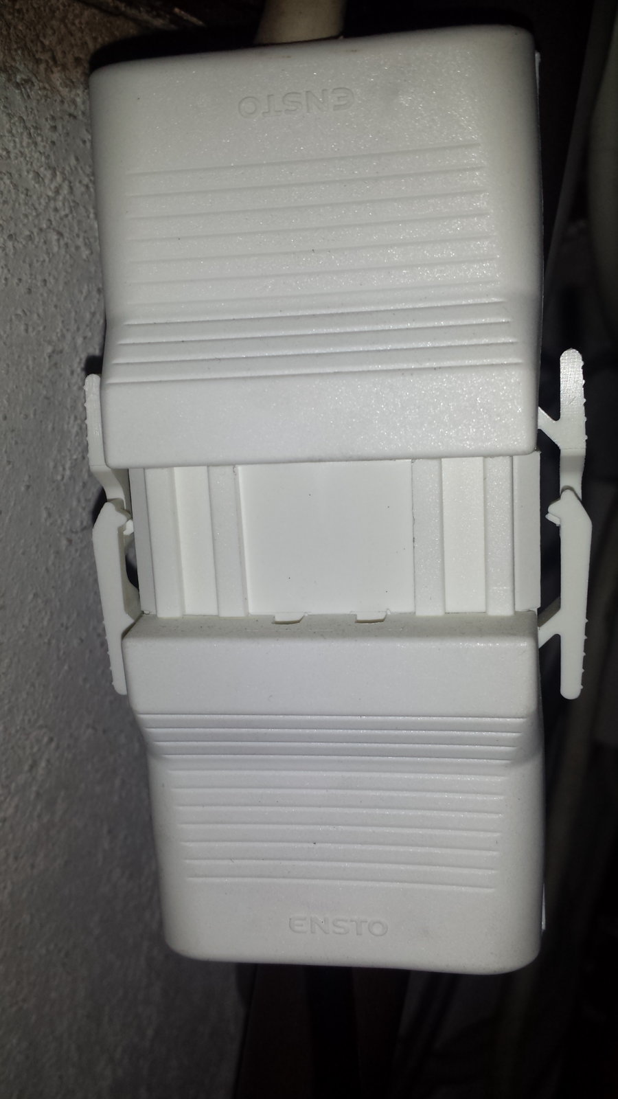

Hello All,
Here is a picture of an electrical connector which sits between my central heating pump and the wiring, a good way of swapping it in case of failure.
There's another one on the 3 Valve as well. Top marks to the installer!
I want to put one of these on the HW Cylinder stat as well - anyone know where I can get one from?
Cheers,
YYo
Thanks, so this is a Light Control Module connector - is there a high street equivalent?, I checked the usual suspects - B&Q, Screwfix, Wickes, etc

Similar things are on the shelf in plumbers merchants. Used them a few times when the plumbers decide to put the zone valve miles away from each other and one or both need extending - does make swapping the head/valve easier in the future

Lgiffer > I'll have to try local merchants and ask at the counter as I have never seen them on display - also might try a light shop (though these look like they are for commercial applications).

Anyway i think Rs sell them Ensto Nac 31S we sometimes use them for display lighting, however theres various types, male female, some with pins and some with holes and I recall its not that straightforward to work out whats what
I do believe they now do free delivery
http://uk.rs-online.com/web/p/lighting-connectors/3806463/

Sites just changed from being £1.37 each to a Discontinued product.
Though they still sell the similar Wieland versions
http://uk.rs-online.com/web/p/lighting-connectors/7684475/
