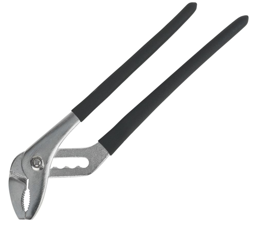

may be too big with some jobs, but you should not be buying more tools than you can carry around with you, tool boxes are useless when going up/down ladders so tool bag is way to go. And light enough to carry, when working on the building of T5 although we had a pick-up, the normal way to get around site was walking, you don't want a heavy bag, so in-spite of saying no moving spanner, in real terms you had little option, and since they do wear out, firm provided in the main. Water pump pliers come in a huge range of quality. These
ae235

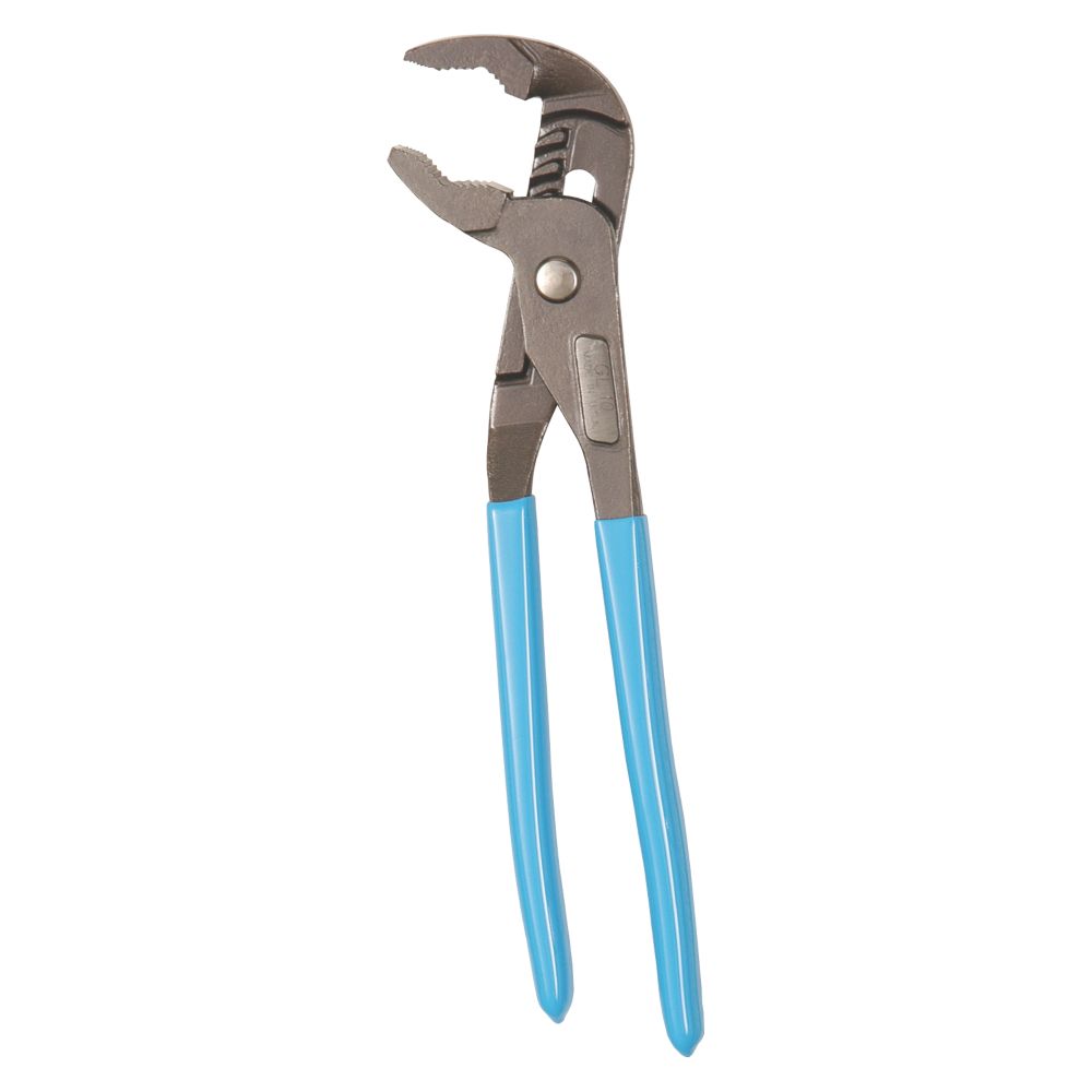

are useless and likely to slip and injure your hands, these
ae235
are far less likely to fail. Also cost more.

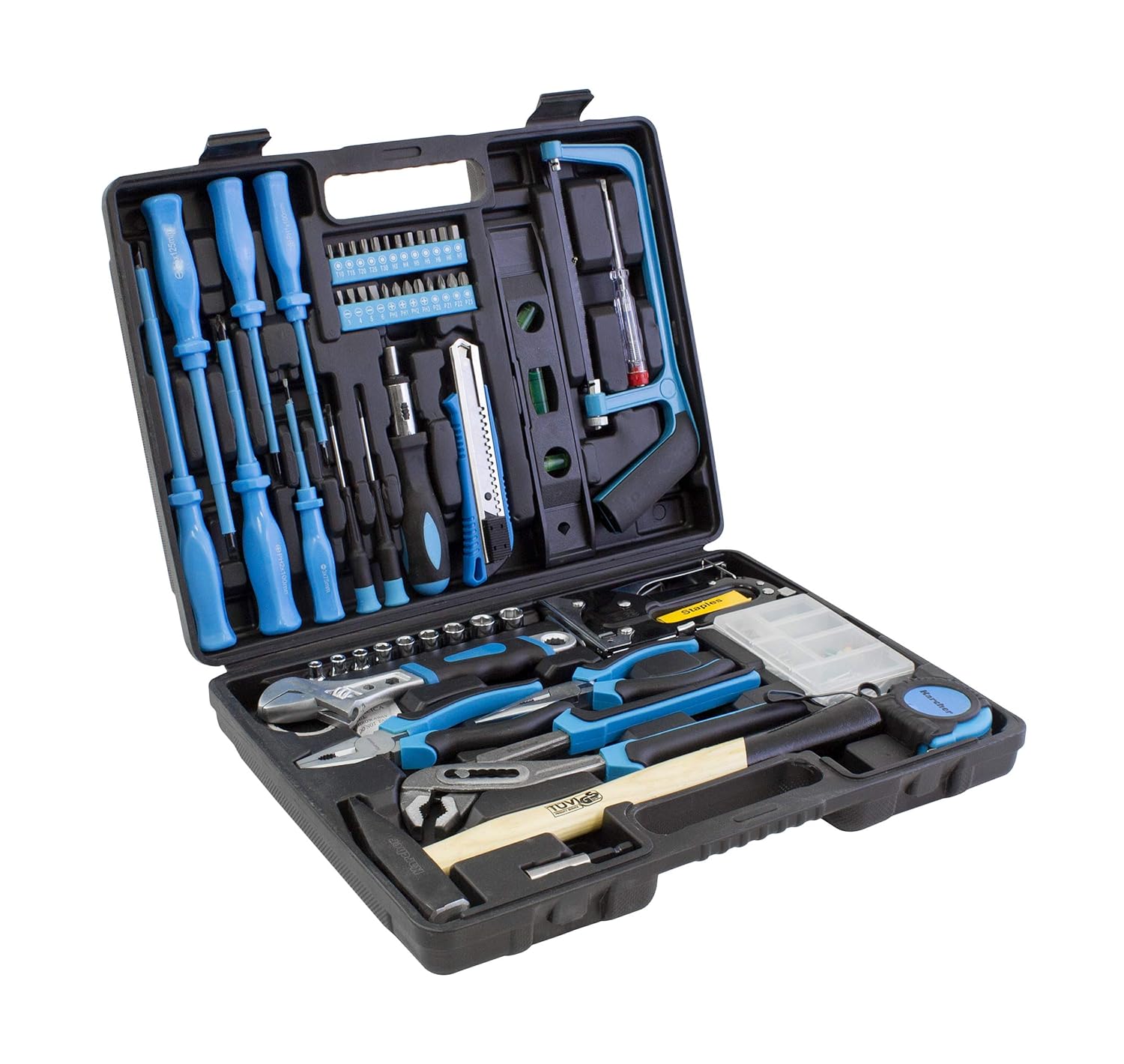

If I ever want to be an engine driver, then I have to be reasonable, and often that also applies to paid work, even if they should provide all tools, borrowing the instructors tools is not going to make you popular, so side cutters, pliers, junior hacksaw, moving spanner, channel lock pliers, and screwdrivers and bag shows willing, any other tools you buy as you see they are needed. Likely with bag £50 to £100 for start up tool kit. I would be temped to get something like this
at £38 then replace items with better quality as you find required. It shows you are willing to bend rules to help, without going OTT. But it will depend what you are doing, when working fitting alarms, I bought a cheap battery drill to use as an electric screwdriver, but I was on bonus.
