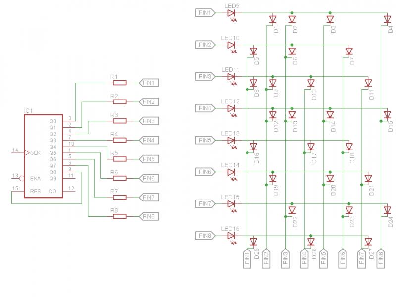

And the Cat 5 tester works using a shed-load of diodes in the remote unit. I think it works by pulling each pin high in turn with all the others low. Each pin as a forward-bias diode to all other pins (or just some others). Probably like this:

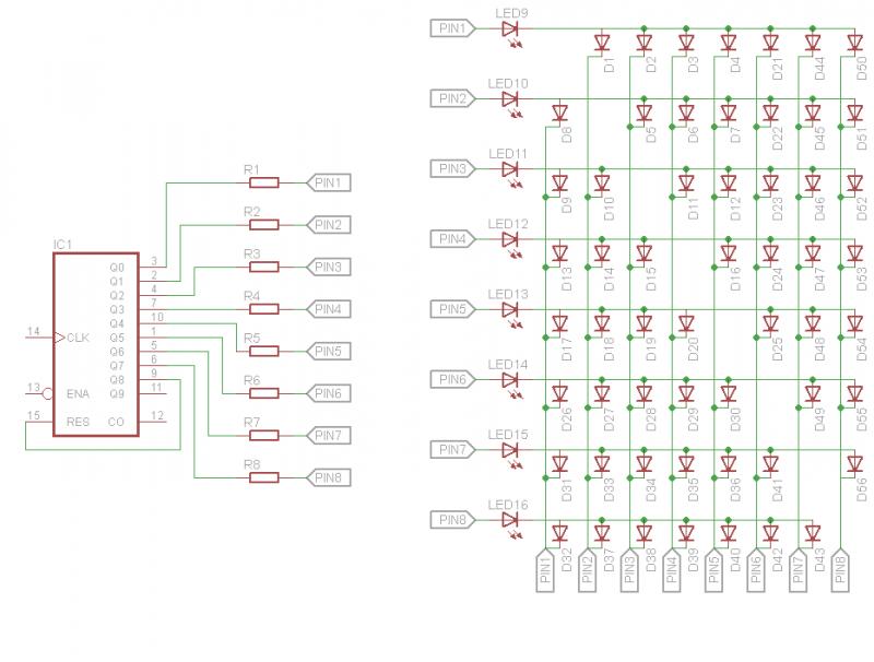

Although I would remove most of the diodes and do it like this:
I got one of those "thingys" £2.49 inc postage from fleabay , I am minded to open it up to see if it is indeed wired as you said (I suspect you must probably be correct ) I suppose your reduced diodes version would be almost equally effective in most practical instances.
