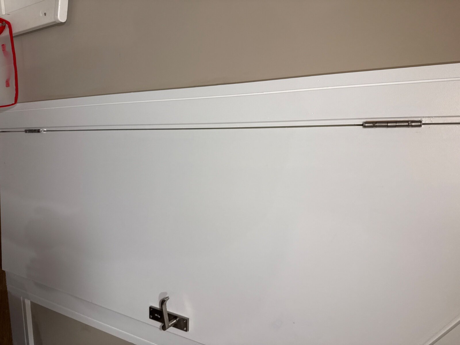

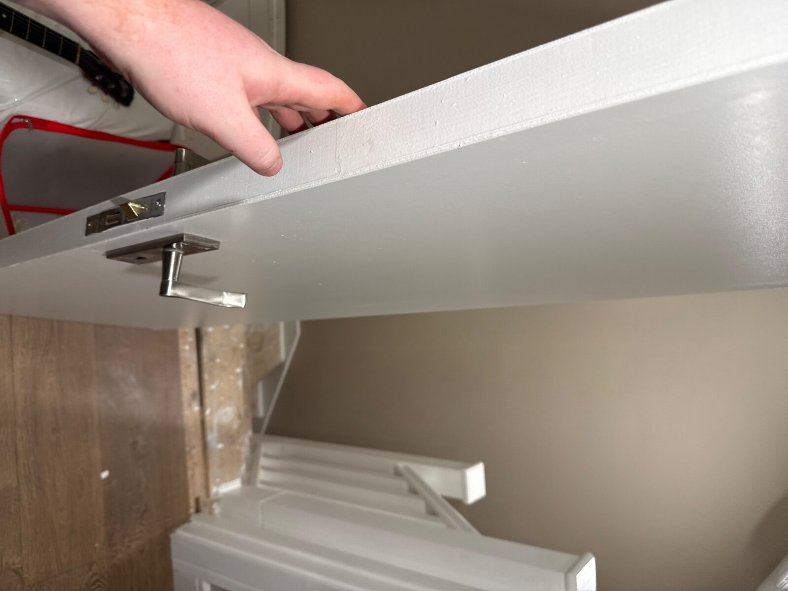

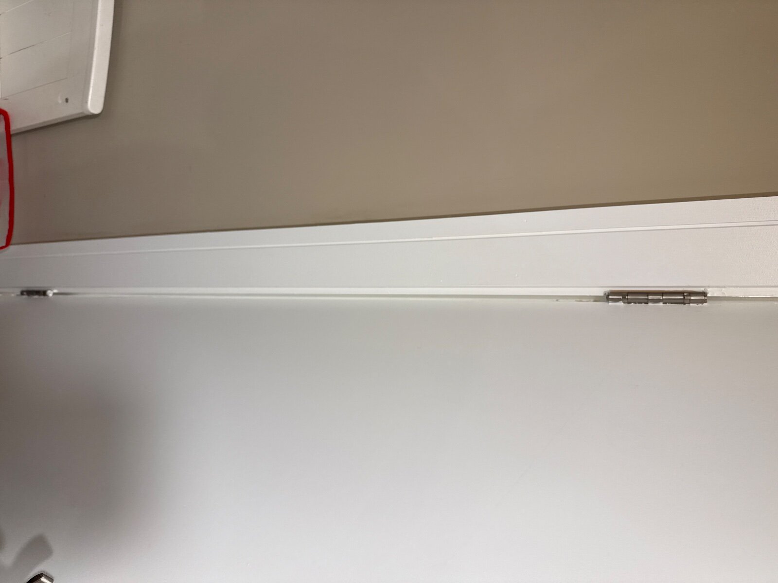

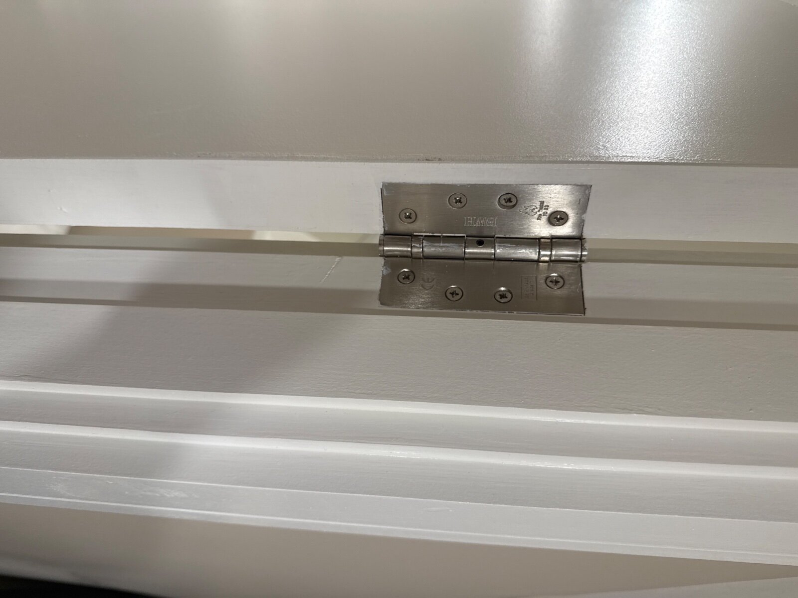

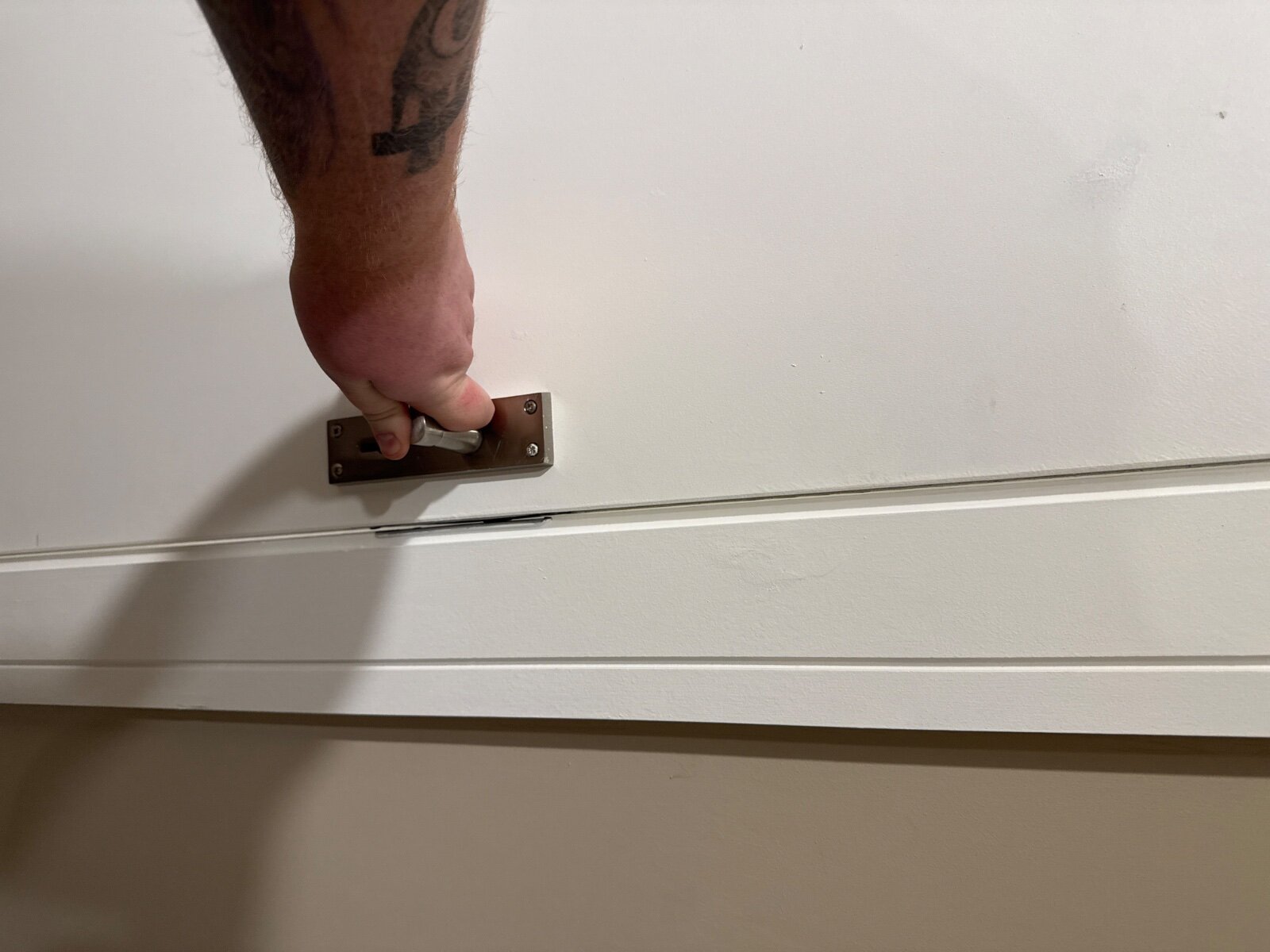

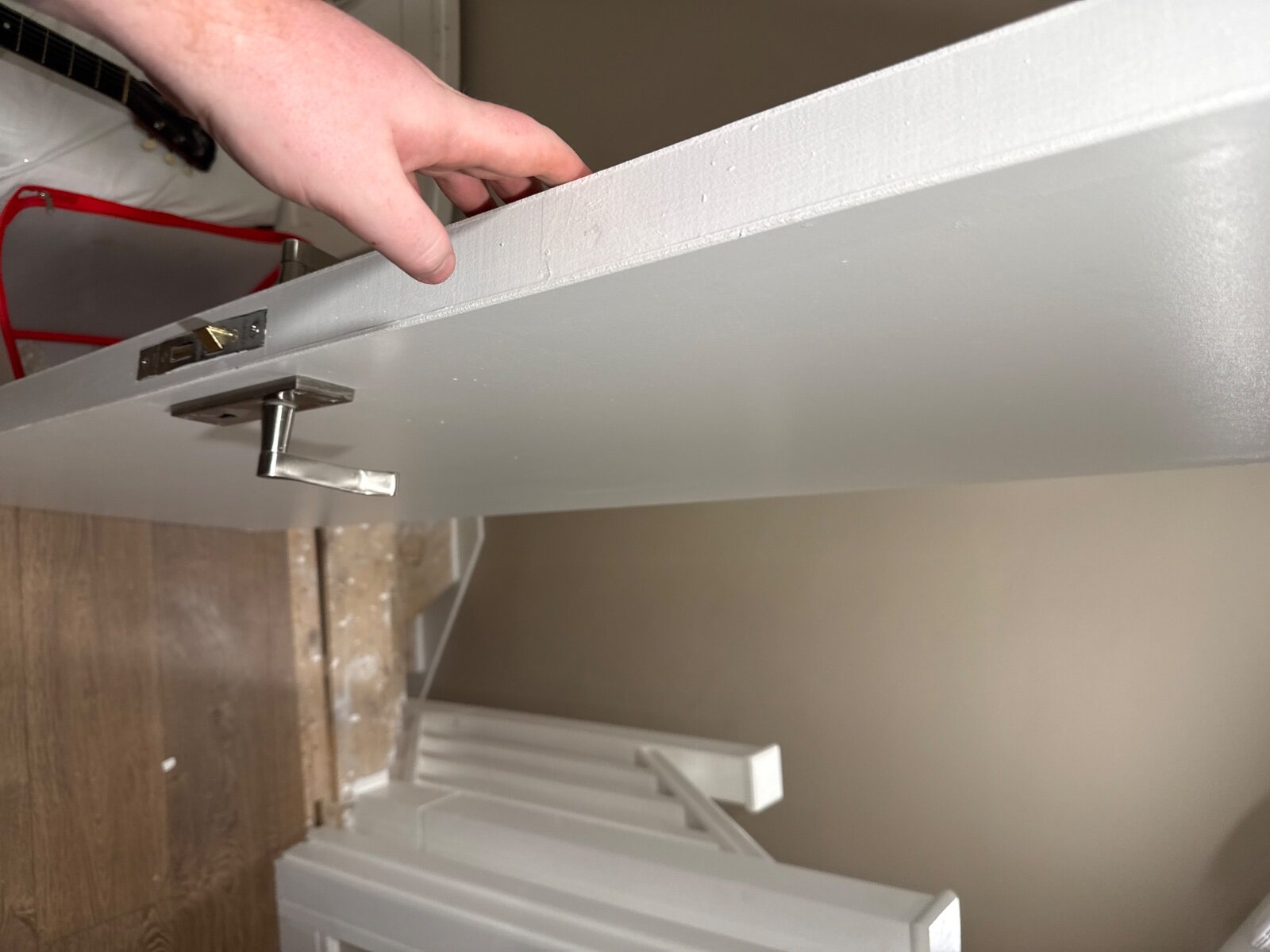

Hi there
We recently got our attic converted and it has a custom door at entry and it closed fine up until we got it painted. It doesn't look like the painter took the door off to paint the trim and door.
The door now won't close, when you try to close it the hinges start pulling away from the frame and on closer inspection I can see that the face of the door around the frame is pushing into the frame which is why I can't close it. ChatGPT is recommending I cutout the door side hinge to allow it to sit deeper into the door but it's ChatGPT and I don't want to go ruining a door if that's not going to solve the issue. Any recommendations? I've guests staying this weekend and would like the door to be able to close for them

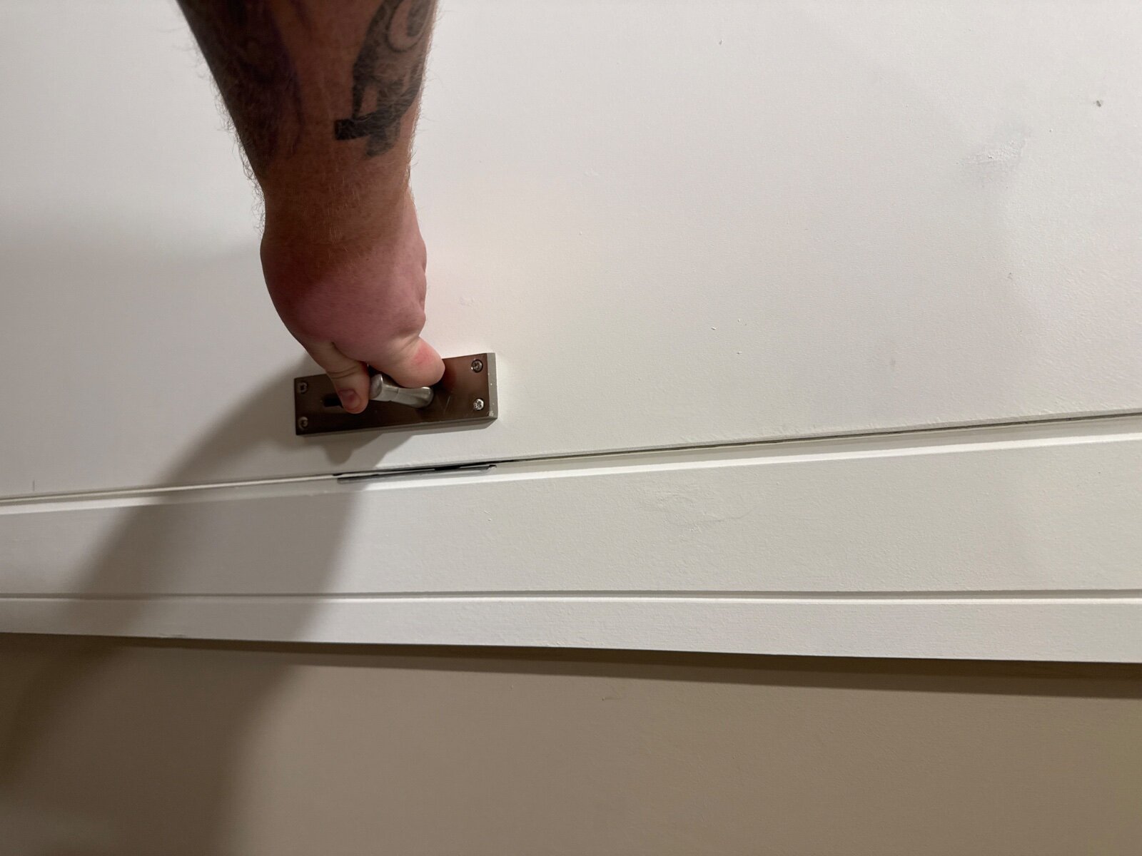

It's not clear from your description where it is catching. Is it on the hinge side or the latch side?
If the door stop (the strip of timber on the lining) is detachable - which it looks like it is, you can lever it off and refix it a couple of mm off the door. That's the least disruptive and easier option, and the correct one.
You don't really want to move the door outwards and re-set the hinges, so the other alternative would be to chamfer or sand the door edge where is catching the stop. This is more difficult and can look a right mess if you do it unevenly.

I see nothing that suggests that the decorator is at fault. That said, check the door stops to make sure that there isn't a massive build up of paint where the paint runs around and back to the frame. If there is, you can use a sharp chisel and sandpaper to remove the excess.
Your decorator seems to have used a roller to apply most of the paint. TBH, the finish is a bit pants. The roller might have built up paint at the edge of the door stop.

I am inclined to think that the chippie didn't leave enough space where the doorstop meets the hinge side of the door.
I agree with @^woody^ that removing the door stop and moving it by 2mm or so would be the path of least resistance. You will need to cut through the existing paint line to reduce paint chipping. It will be more disruptive than moving the hinge, but, arguably, easier than plugging the screw holes in the hinges.

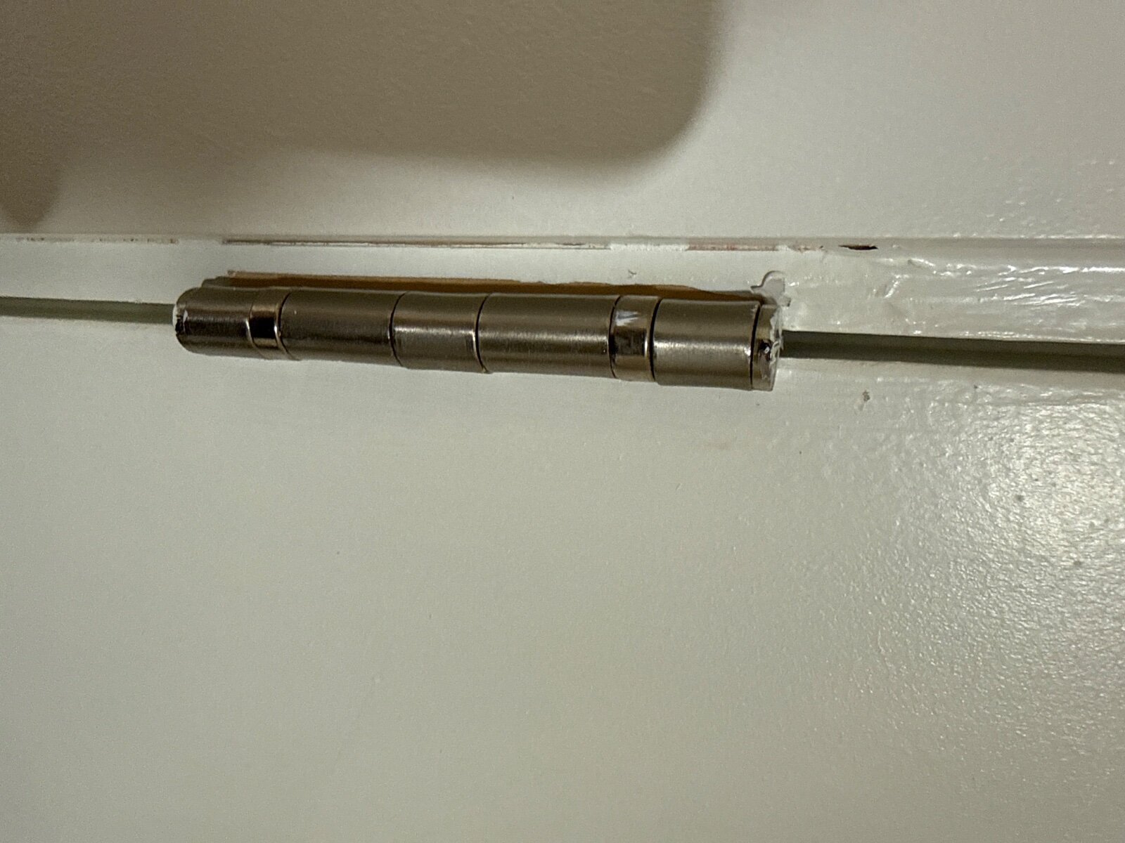

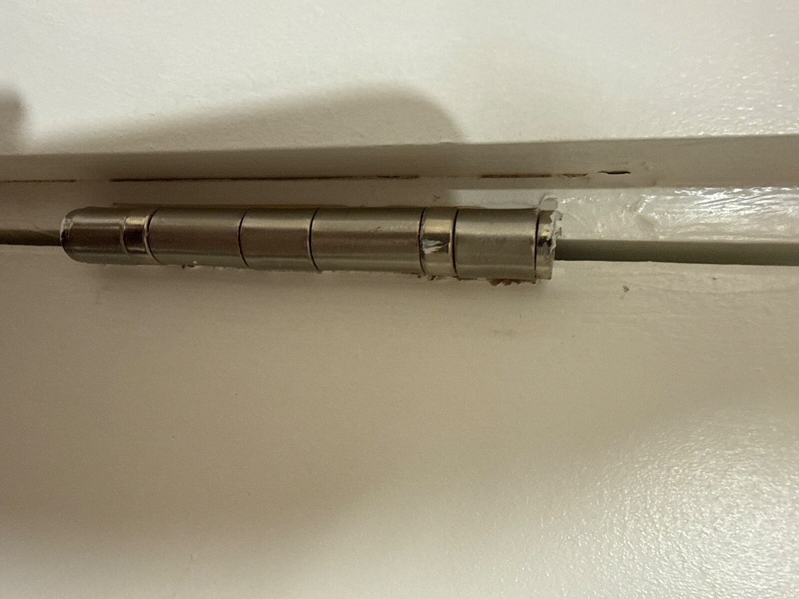

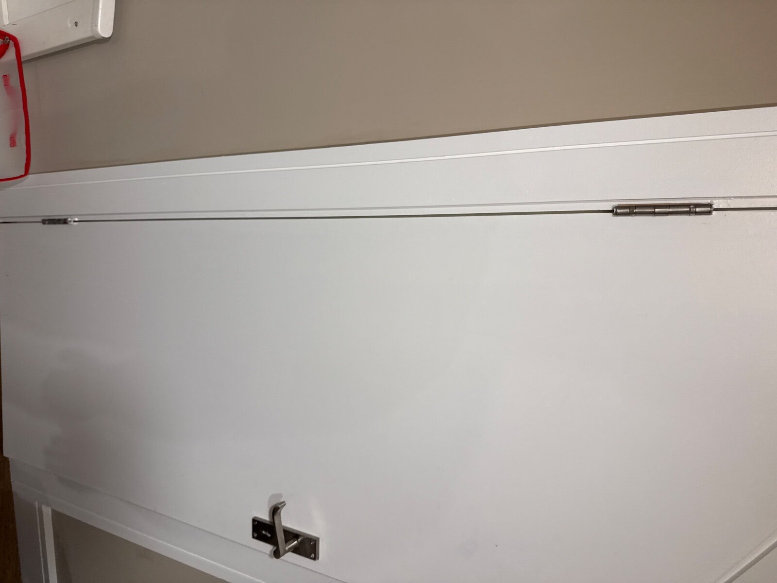

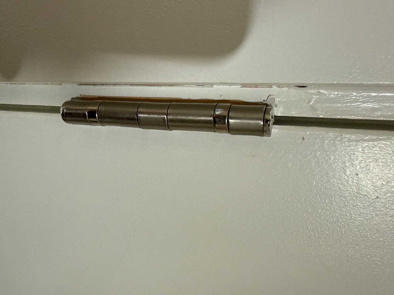

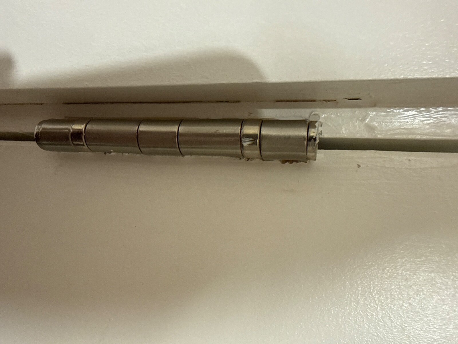

I don't understand why the pictures show a silver hinge with a zig zag screw pattern and the video shows a black hinge with a U pattern
Have the hinges been changed?

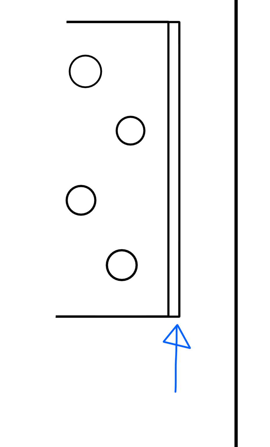

The fastest solve for this would be to drill a new set of holes in one hinge leaf (I'd do the leaf that attaches to the door frame), using eg a 4 mm bit for the hole then an 8 to chamfer the hole edges so a countersink screw sits in it nicely

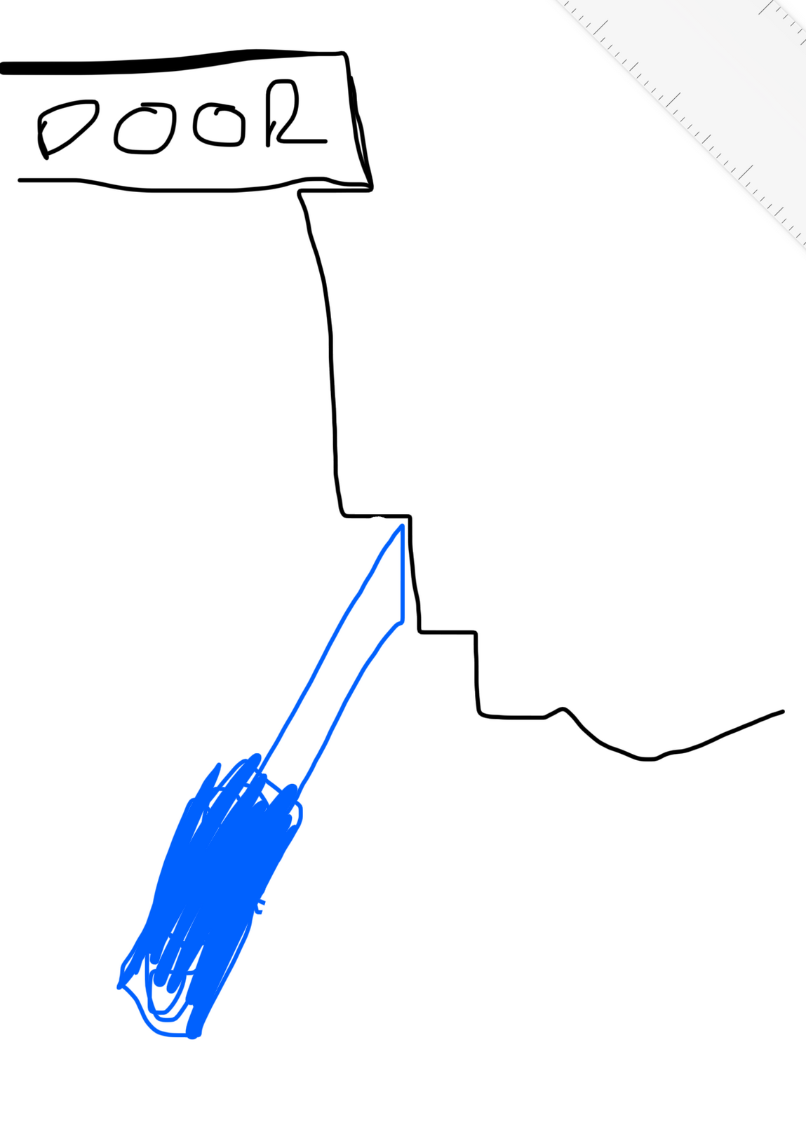

This means the door can be re mounted so the hinge screws are driven into into fresh wood in the frame. Mount the hinge so that it isn't where is was; it needs to be a few mm further away from the stop the door is rubbing on, so there is a small gap like this where the hinge sits in the frame (blue arrow)
Whether the sight of empty screw holes in the hinge offends you or not dictates how far you'll go in terms of filling and painting them
If the hinge is different in video vs picture because one hinge is silver and the other is black and the screw hole patterns differ it may help you actually, because you can swap the hinges over top to bottom and the different holing patterns means you have a better chance of getting them all into fresh wood. If any hinge screw holes so-so line up with old screw holes, pre drill a little way and drive the screw in at a slight angle so it doesn't just pull straight back into its old hole and mess up the hinge alignment

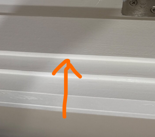

Drive a wood chisel into this joint, at the very bottom of the door case:
Drive it in like this (top down view) a little way:
And lever it gently and see if the entire strip of wood looks like it will lever off the frame
If you think it will, cut down the entire joint with a Stanley knife both sides then carefully prise the wood off the frame, do the same with the top one, then close the door and remount the wood so it's juuust not quite touching the door, nail it and then fill and paint
