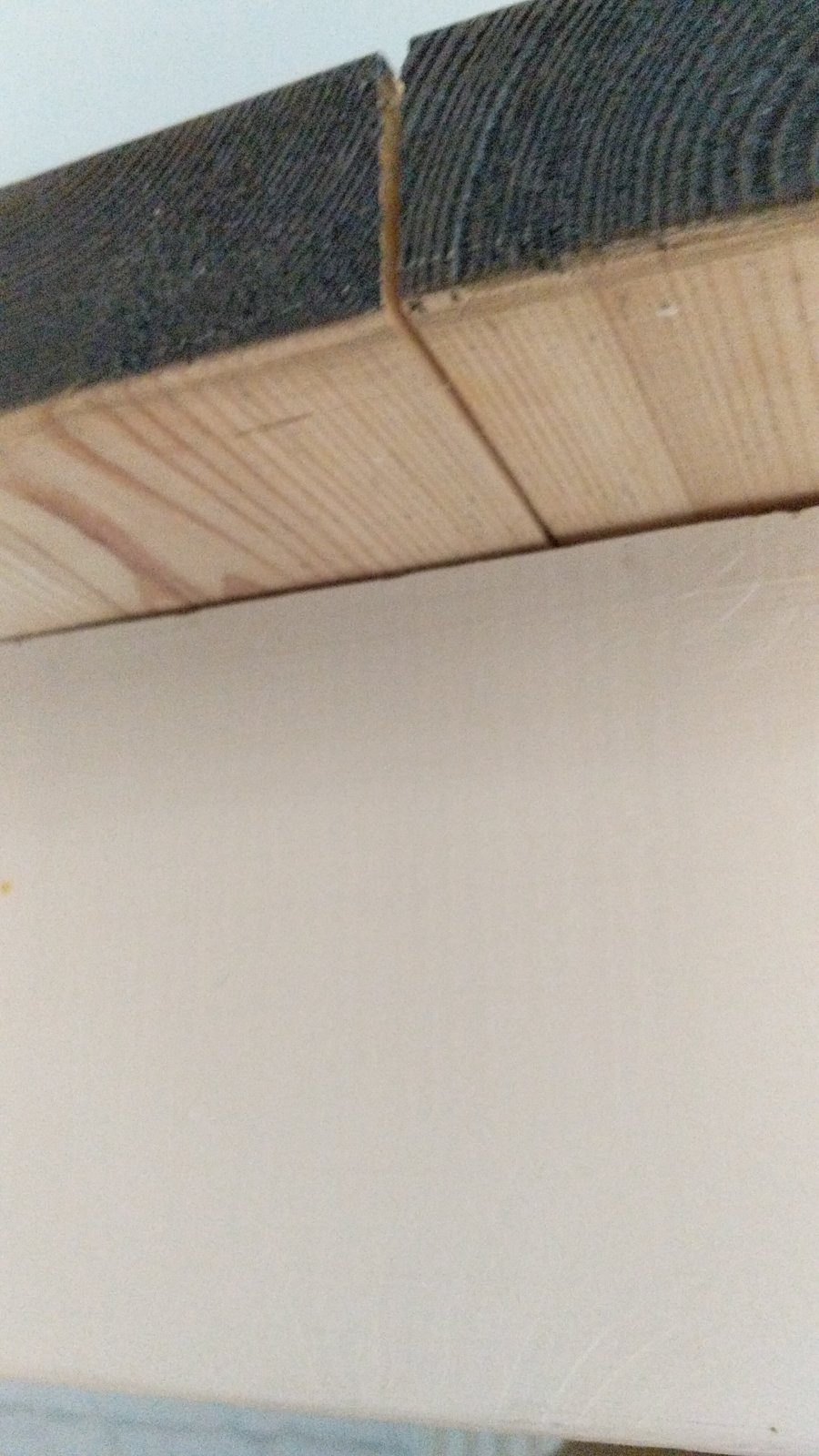

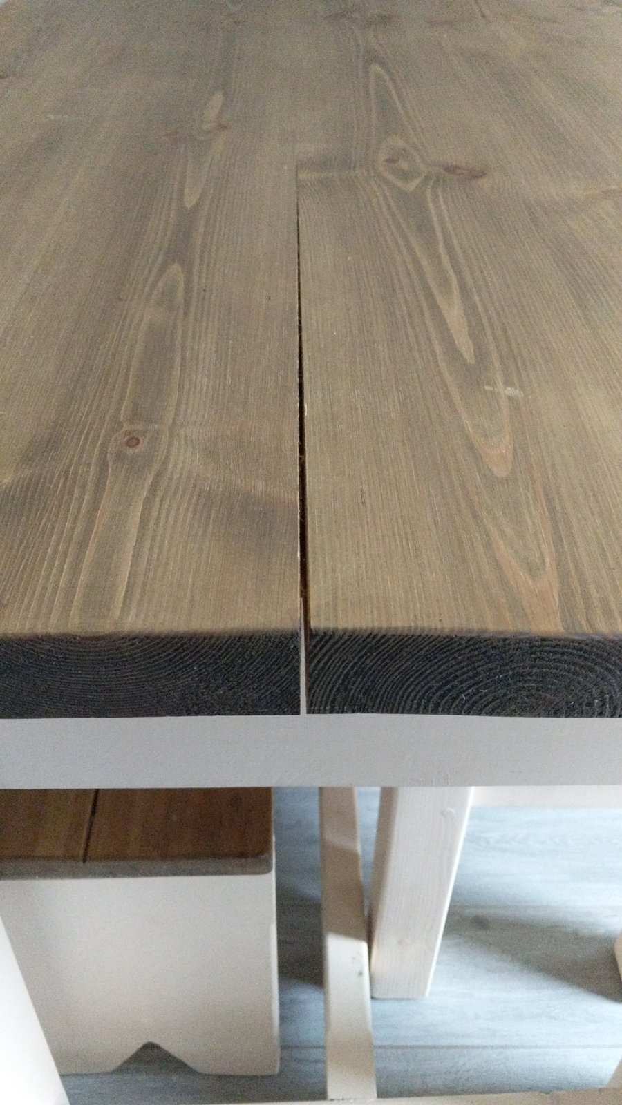

Looking at ideas in how to fill the crack in our table?
We've tried cramps but the top won't move at all
Wood filler? We're going to sand and revarnish the top afterwards but worried we'll be left with a noticeable line

Unless you can close that gap there's sure to be a filler line visible.
Have you tried a proper sash cramp, after first releasing the top from the table frame?
If the gap will close, the join can be plated with steel from underneath after gluing.
If the gap won't close then its filler I'm afraid.

My brother in law who's a carpenter came over we unscrewed the top and with a home made cramp and some wooden wedges which he tightened, tapping the wedges with no luck.
Boards have cupped, they won't come back together. If you have access to a jointer, best to take them both off and re-joint. Could be achieved by planing them.
is that end nearer to a heat source like a radiator or cooker ??
if so try turning it round for a while to see what happens

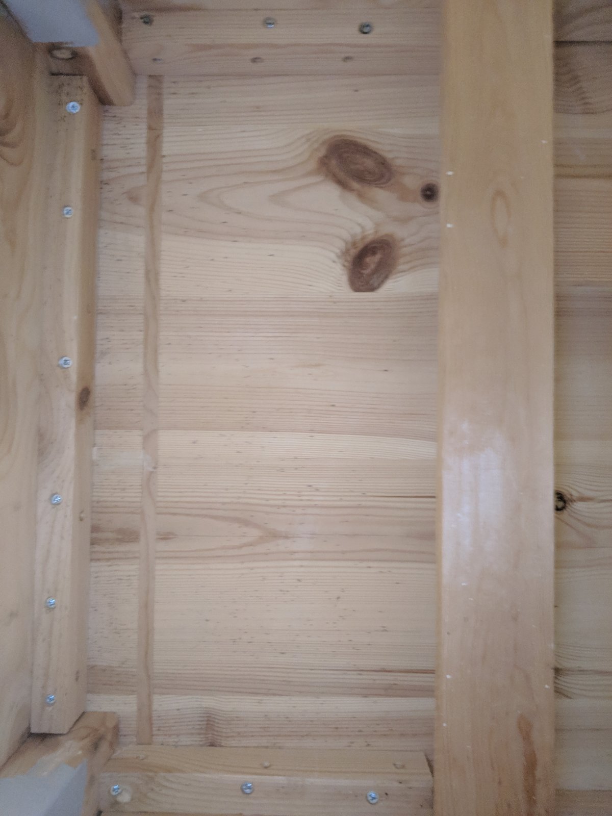

Been told I can't take the top off as underneath is a separate piece?
Undo those posidriv screws and the top will come off. Ideally the top should be allowed to float but that's rarely done these days.
If you want a perfect job the top can be sawn along the split line, the edges perfectly planed and grooved to accept a tongue or biscuit.....cramped together and glued the join will be hardly visible and ready for sanding.

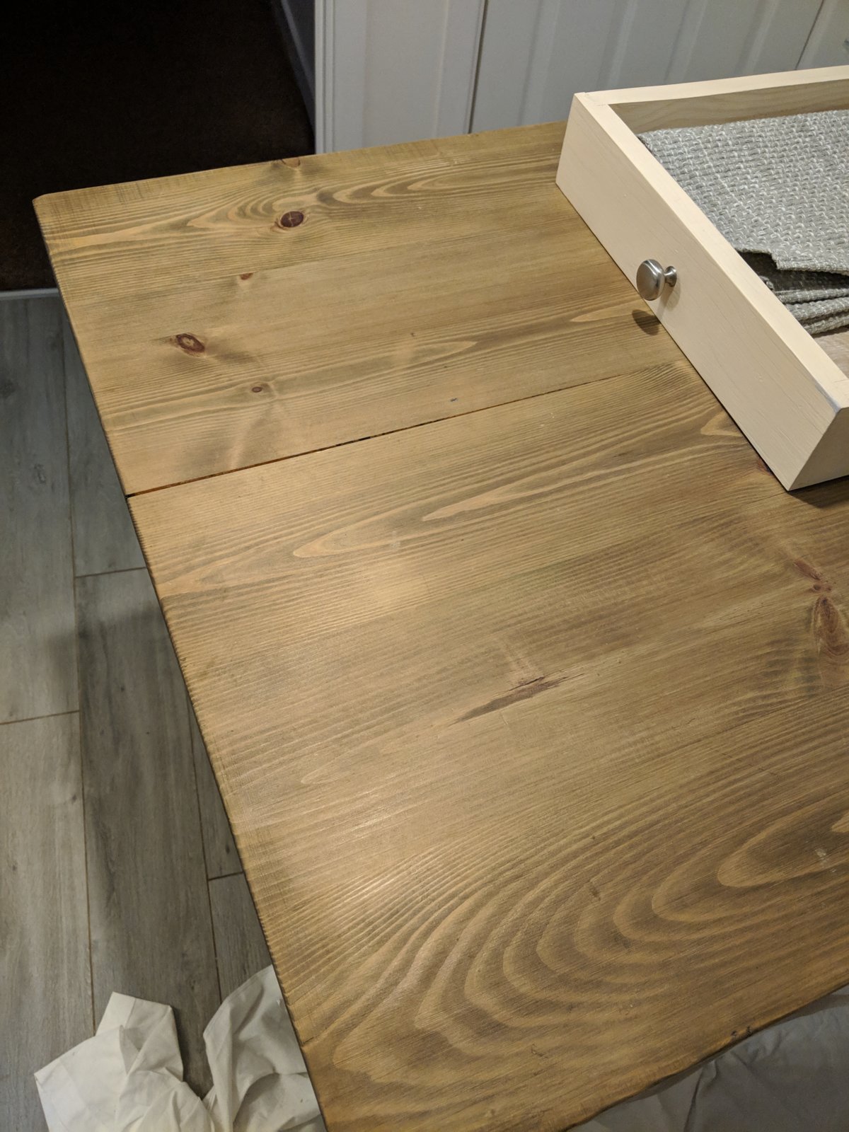

These any better ?
It seems to be bending upwards on the left corner

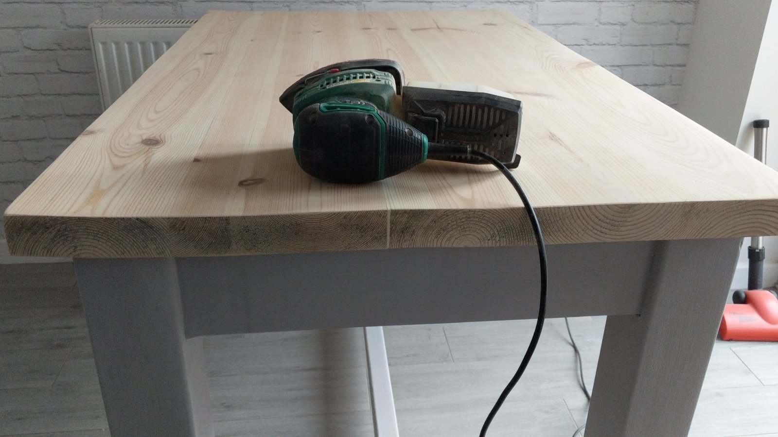

Tried cramping the top after I took the screws out but it wouldn't budge at all,in the end I filled it with wood filler
In the process of sanding it down now then staining hoping I can hide the faint line.
You need to take off the present fixings and refix the table top to the frame using 'buttons'. That will allow the top to remain as one piece but move with changes in temperature and humidity.
