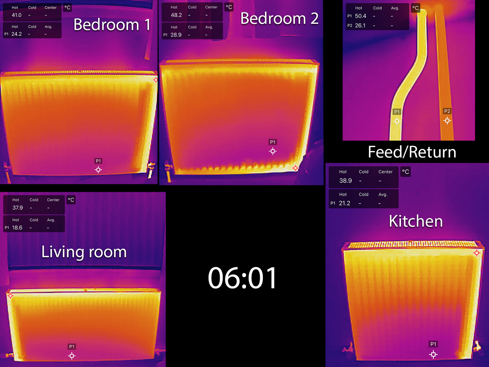

Thermal images - 6 measurements over 1 hour 18 mins. Feed/Return in the images is the 22mm feed from/to the boiler before any radiators.
06:01 - Heating just turned on

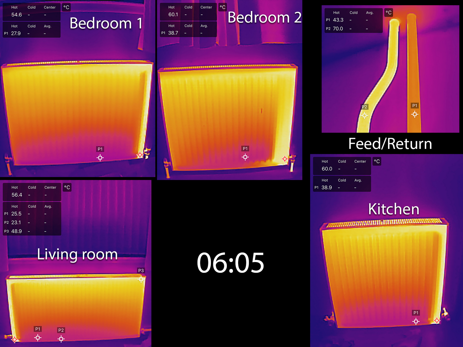

06:05 - running for 5 minutes. All radiators seem to be blocked at the bottom

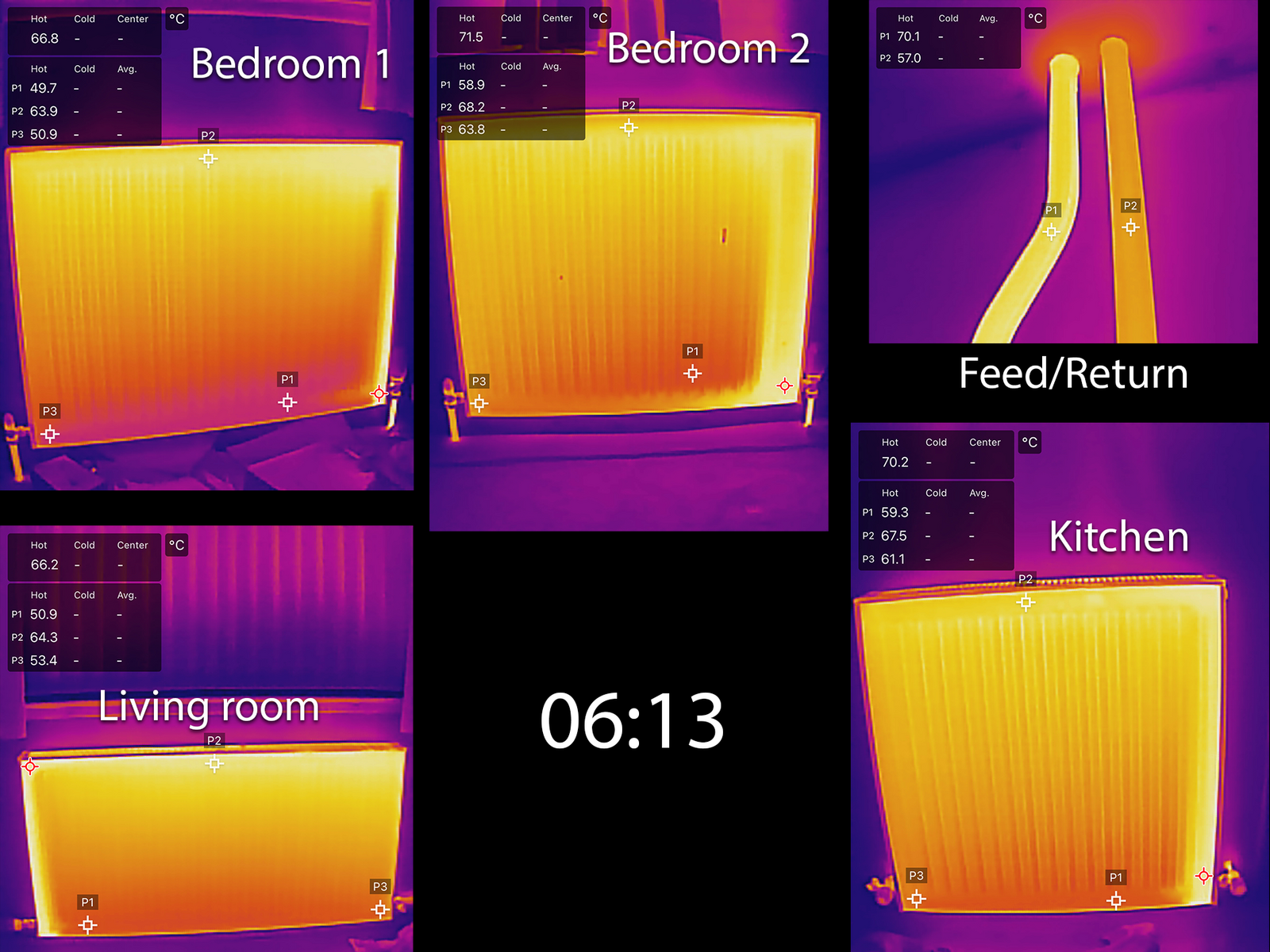

06:13 - All struggling to heat the bottom still, Bedroom 2 is doing ok. It's the closest rad to the boiler.

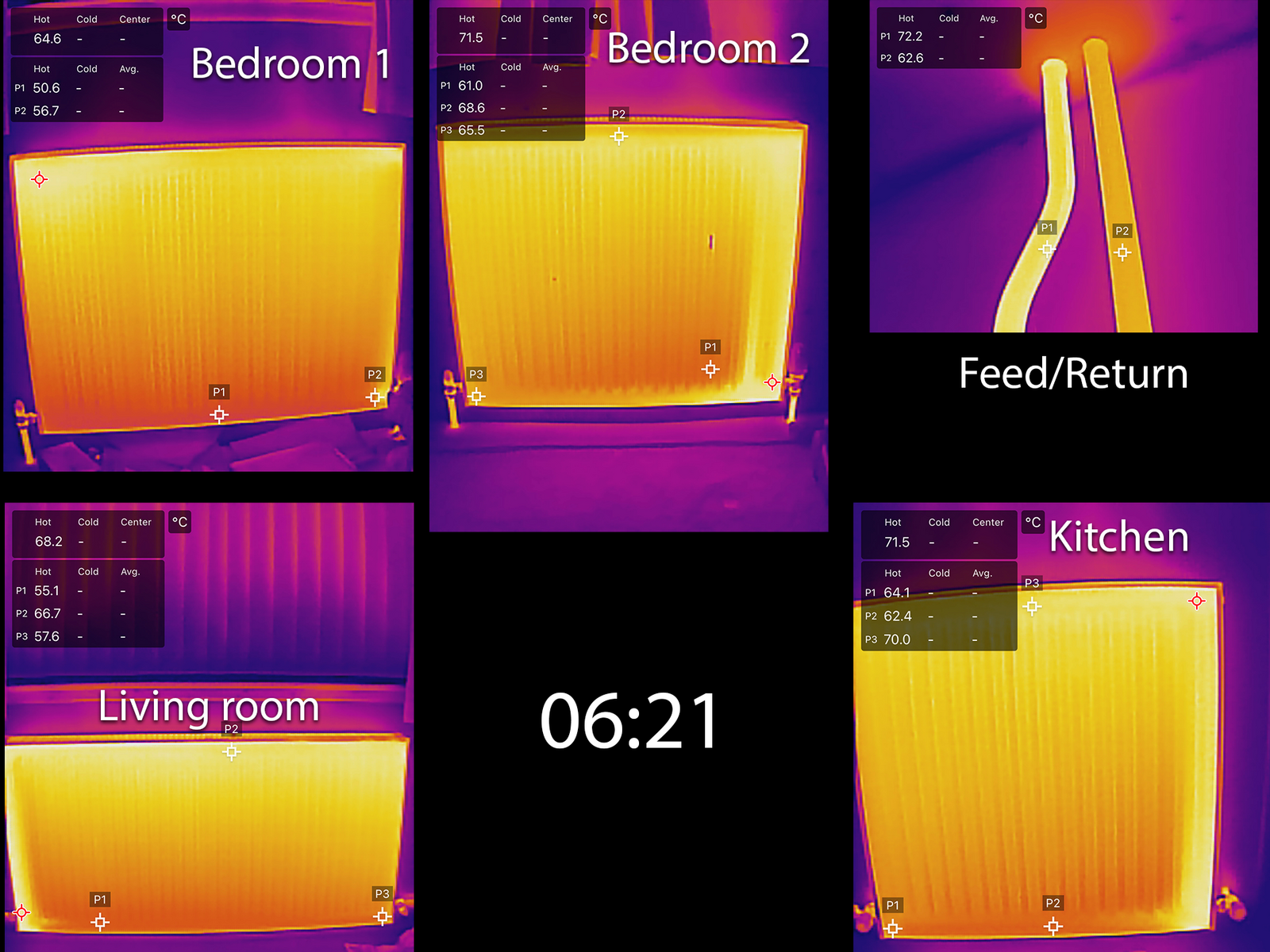

06:21 - Living room 13C difference between cold and hot spot, Kitchen 9C difference, Bedroom 1 14C difference, Bedroom 2 10C difference.

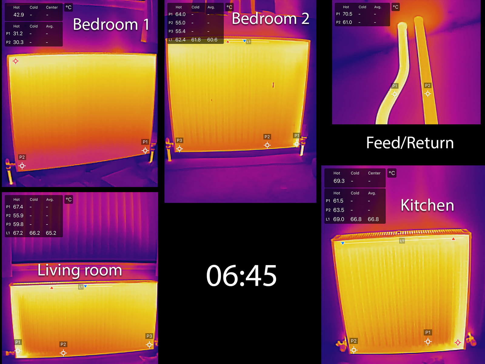

06:45 - Bedroom 1 TRV has restricted flow so this rad is cooling down. Bedroom 2 starting to shut off. Living room and kitchen still struggling at bottom. Living room - 12C difference between feed and cold spot. Kitchen, 8C difference between feed and cold spot.
