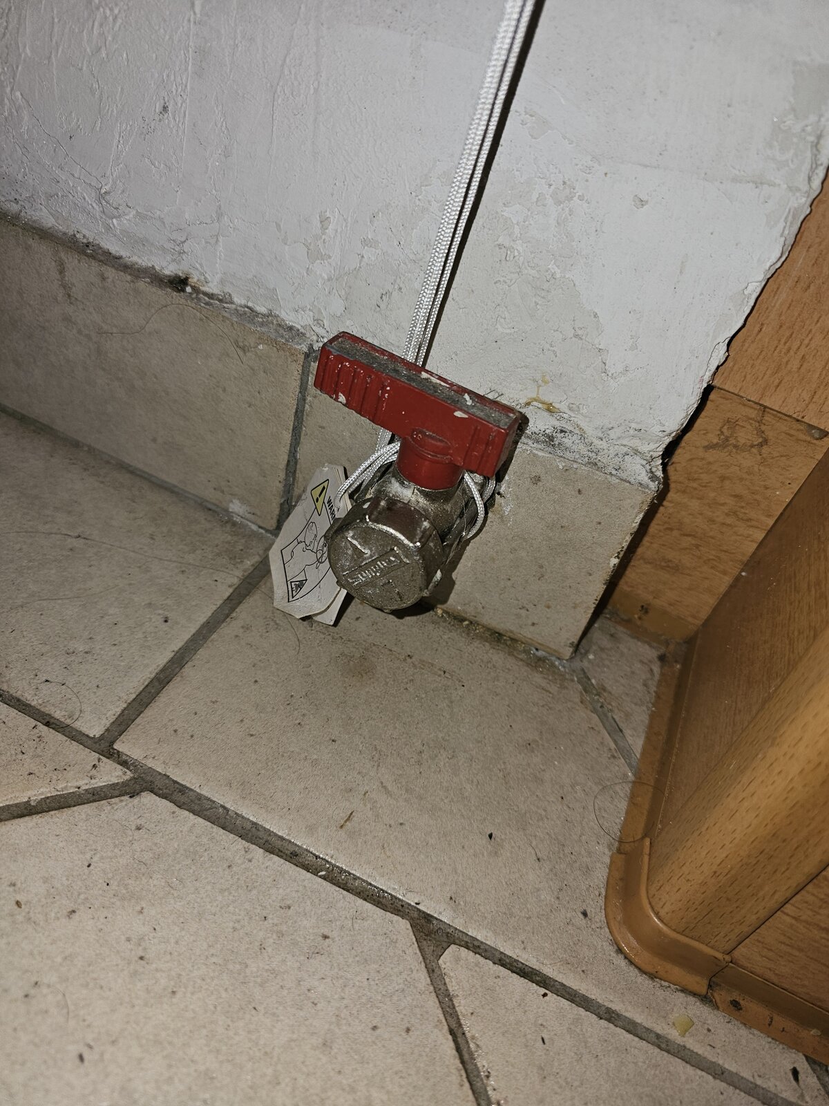

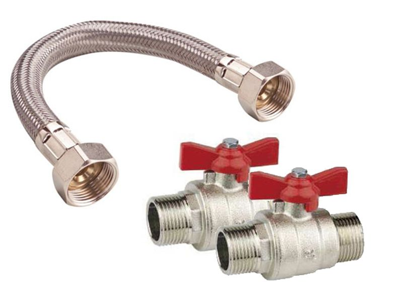

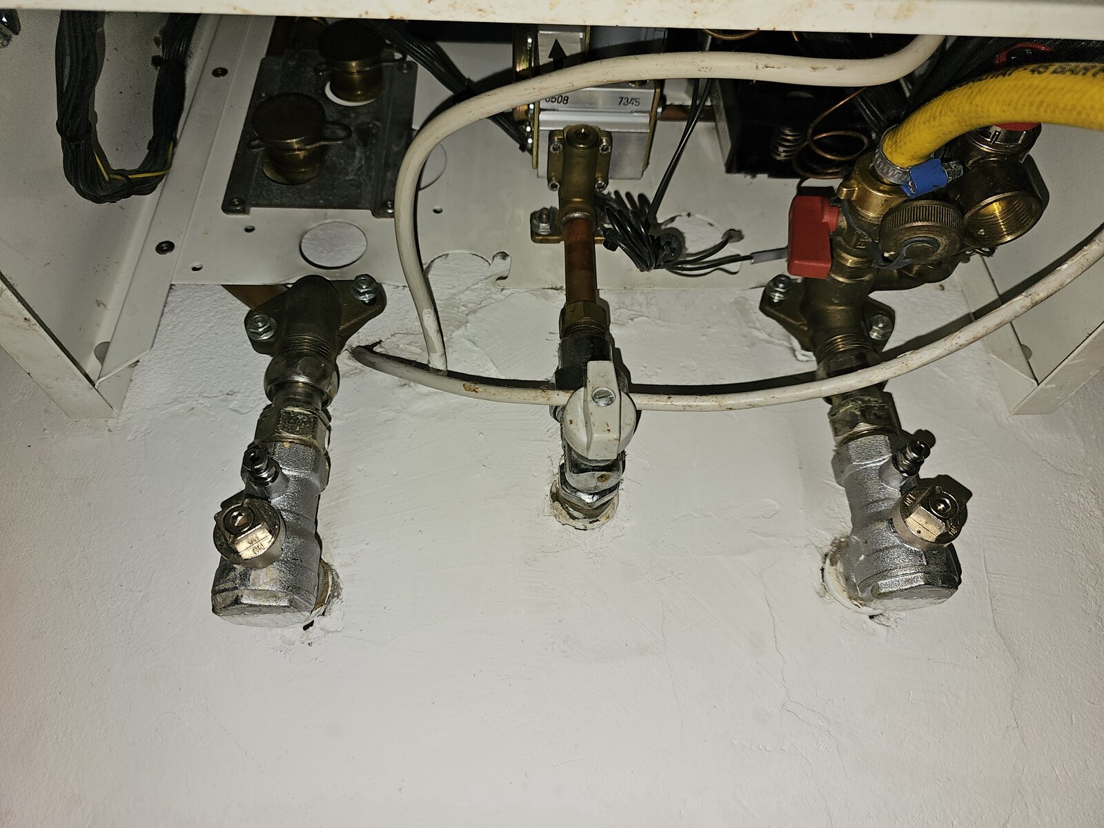

I am having the biggest trouble contacting my landlord about the heating.
I am 99% sure the issue is the boiler pressure is at 0 bars.
Now the issue is, I have no idea how to fill up the pressure. All the videos show filling loops or using two valves.
In my case it's like this, I have a hose that doesn't fit snug nor can I tighten it, can anyone advise!
I think I need some sort of adapter, but it might be easier to get a whole filling loop system?

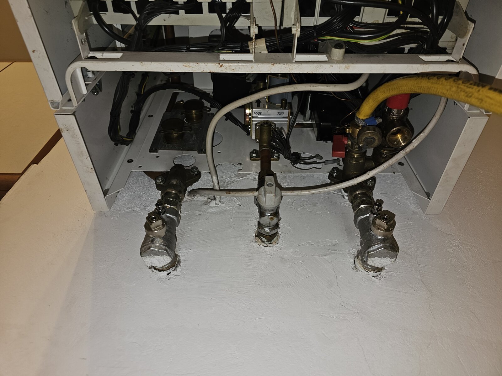

Edit sorry for being a stupid idiot, I took an image from online that I thought was the same as I wasn't home, please see the update.
I really appreciate your help!

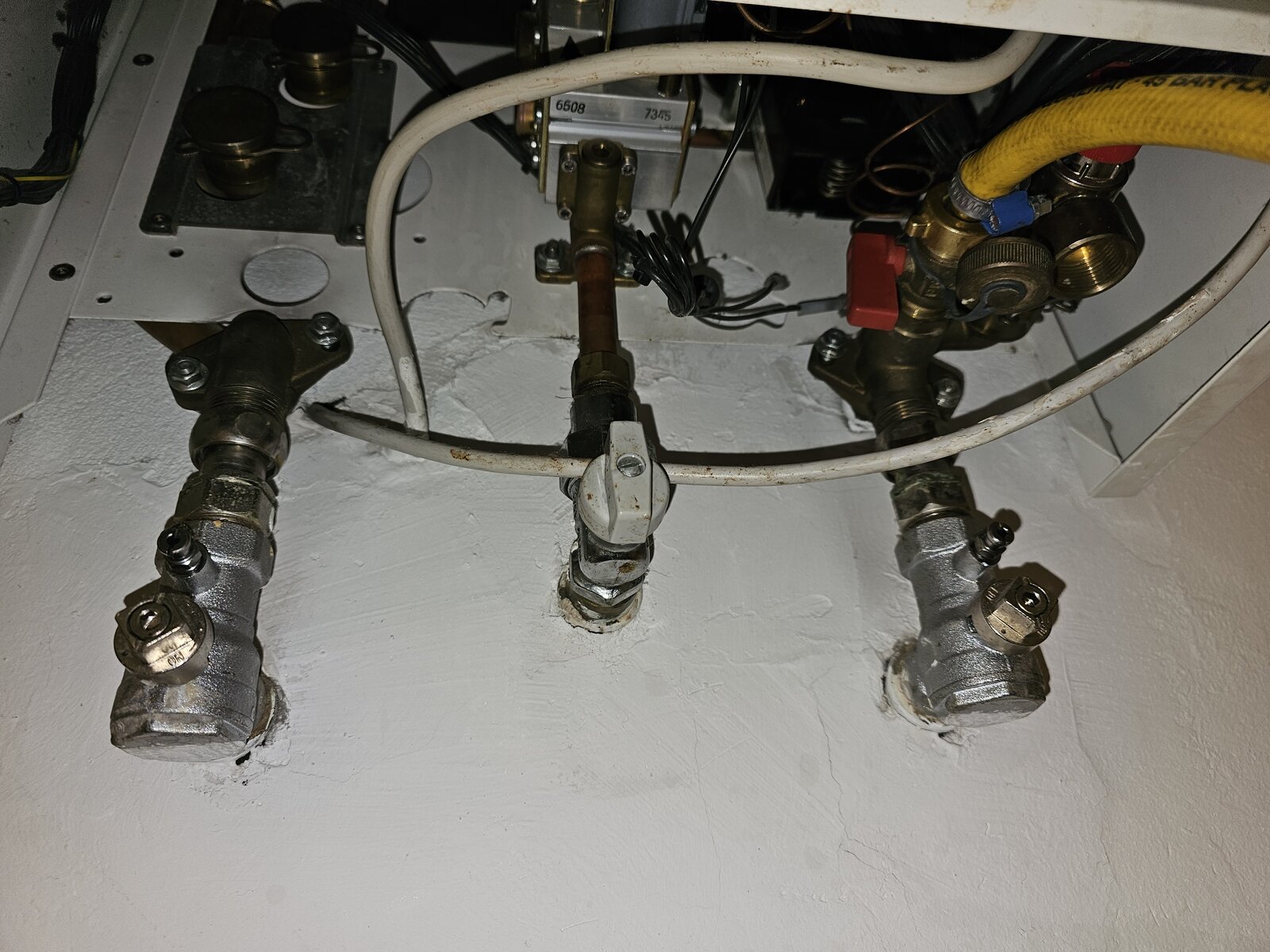

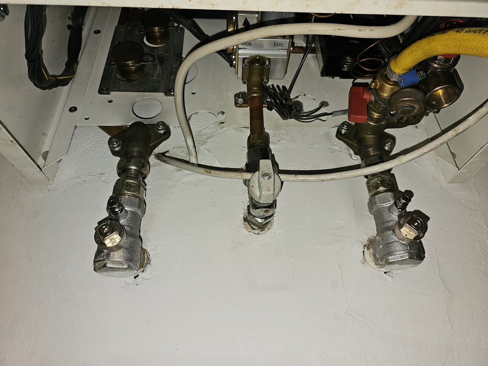

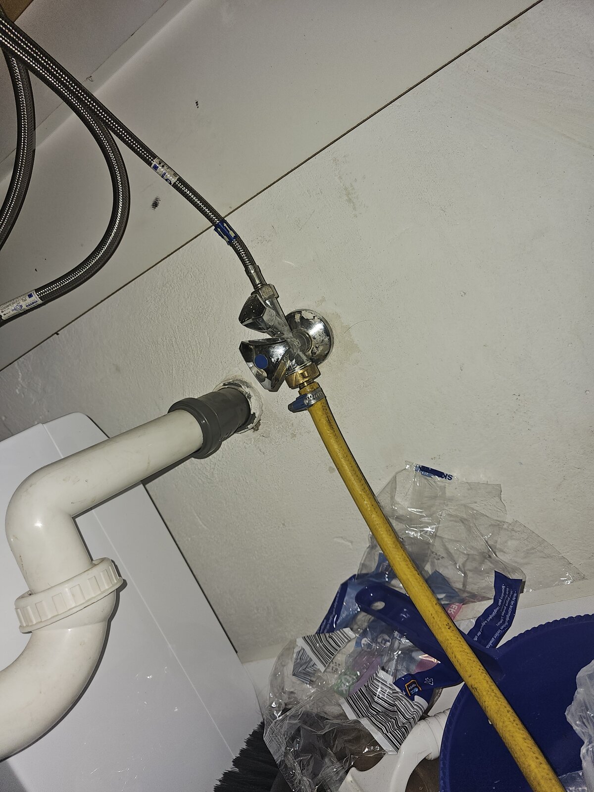

For anyone who is in an Austrian apartment and has a Viessmann Pendola 7520581:
The way I increased the pressure was by connecting a 2.5m hose to the valve underneath the sink and then to the boiler with the red valve!
Code 452 was cleared by turning on the middle gas valve, I am all toasty and warm now!
Thanks again @terryplumb

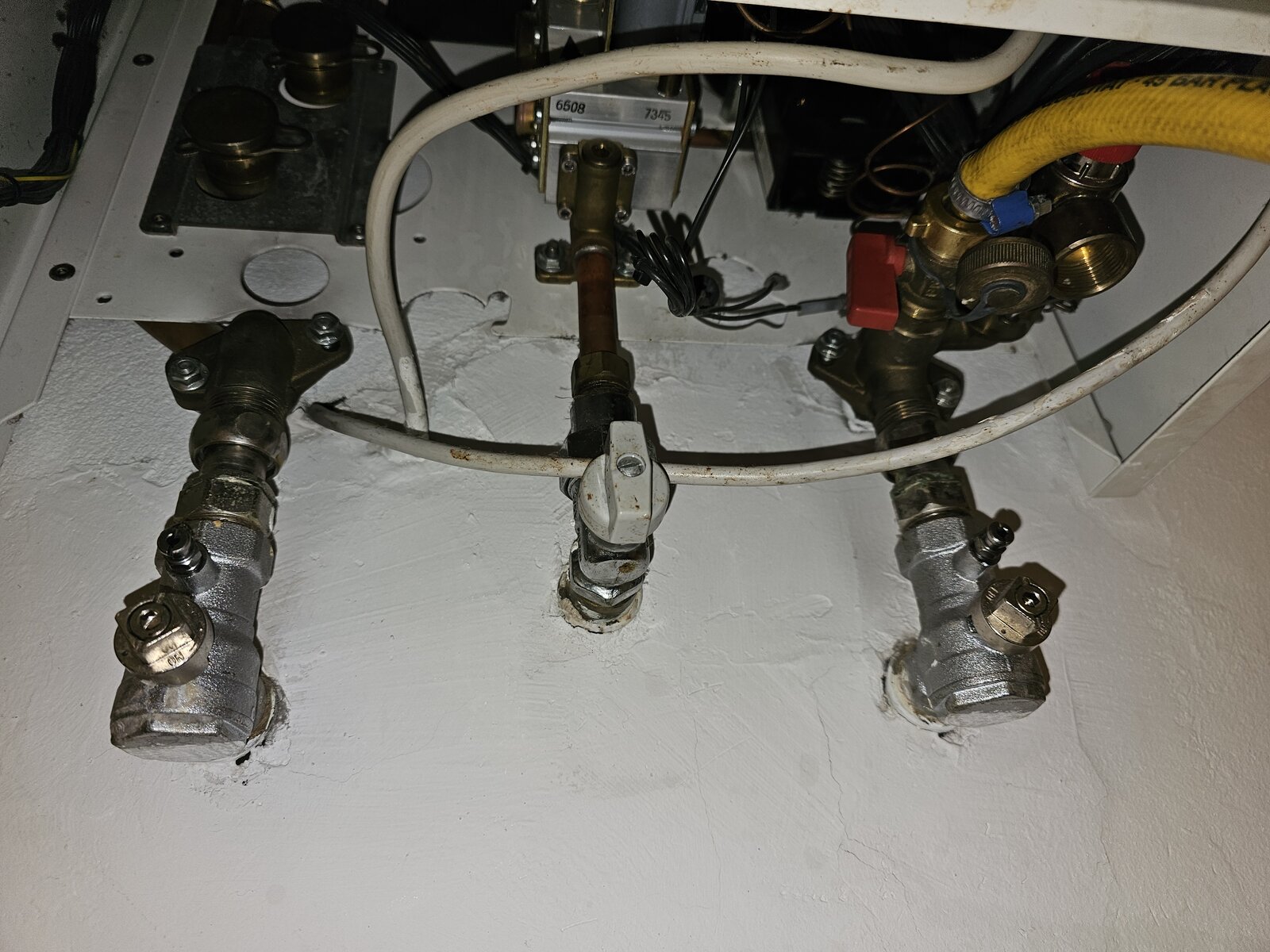

That's not your filling loop connection point on the right hand side ,that's a PRV.
There is a small red handle in your pic ,low down on the left hand side, that's probably where you connect the hose , joining to the two red handled valves.
Oh shoot wouldn't have known that thanks!
It still won't connect, do you know what type of adapter I need?
I have the hose but am I missing these adapters.
But it doesn't make sense to have these many valves?
You do know that the caps need to be removed from both valves before a hose can connect don't you ?
Is it the red hose pipe in your pic that you are trying to use to connect up ?
I suspect that you need to remove the cap in your first image...
Edit, the proper plumber beat me to it.

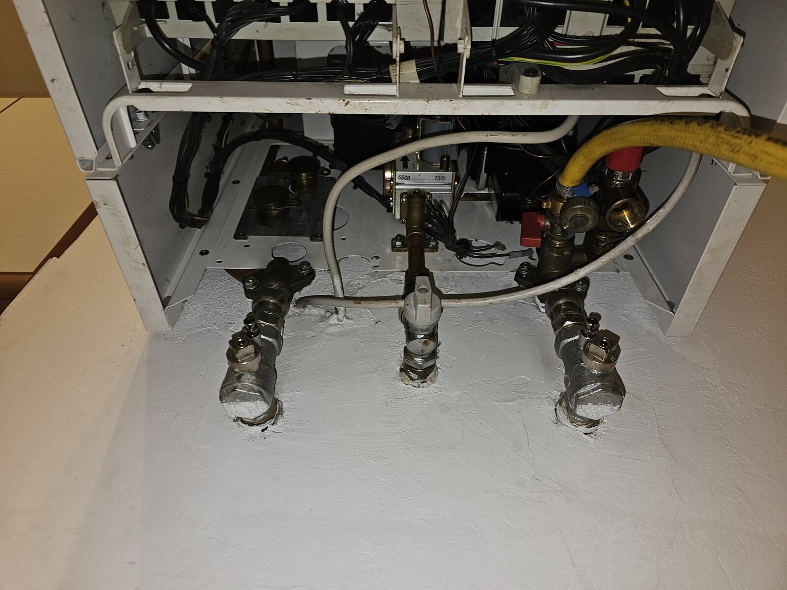

Being an idiot and taking a image that I thought was the same, any advise where the hose goes? I actually got one side connected.
Being an idiot and taking an image that I thought was the same, any advise where the hose goes? ? I actually got one side connected.
Eh ?? I already told you the hose connects between the two valves that have red handles
Ok ,we now have a completely different set up !
Where does the yellow hose go to from the boiler ,there is nothing in your pic that it can connect to.
Yes, sorry I thought it was exactly the same!
It's a long hose 2.5m long I have no idea where it could go.

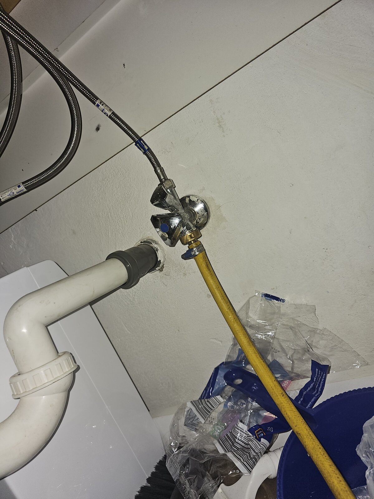

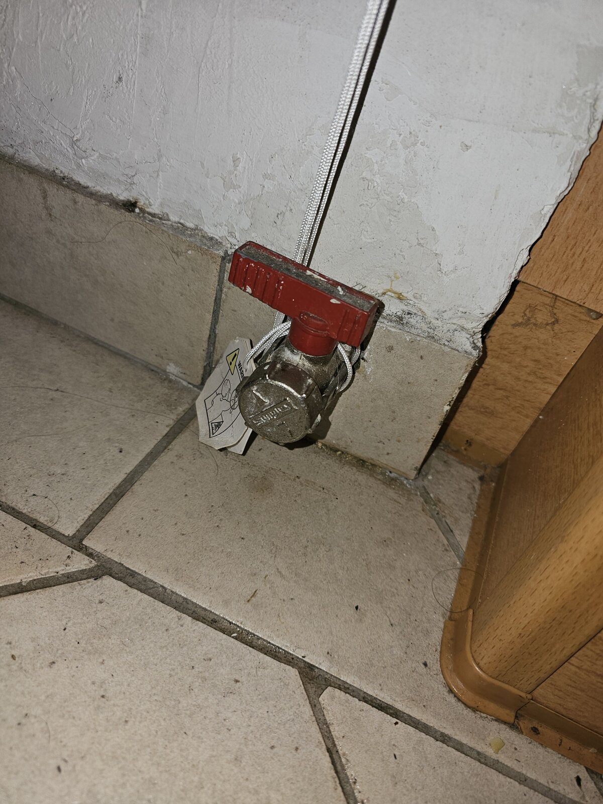

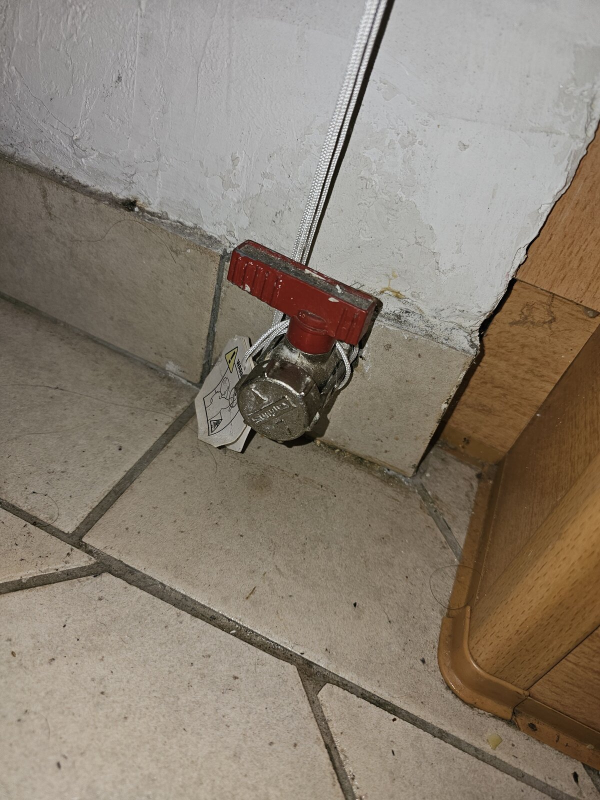

There is this valve at the end of the kitchen; could this be it?
I know where I would like to put it !!!!!
Anyone reading this thread in the future is gonna be scratching their heads !!
You need to look around for a connection point on your cold water mains supply
