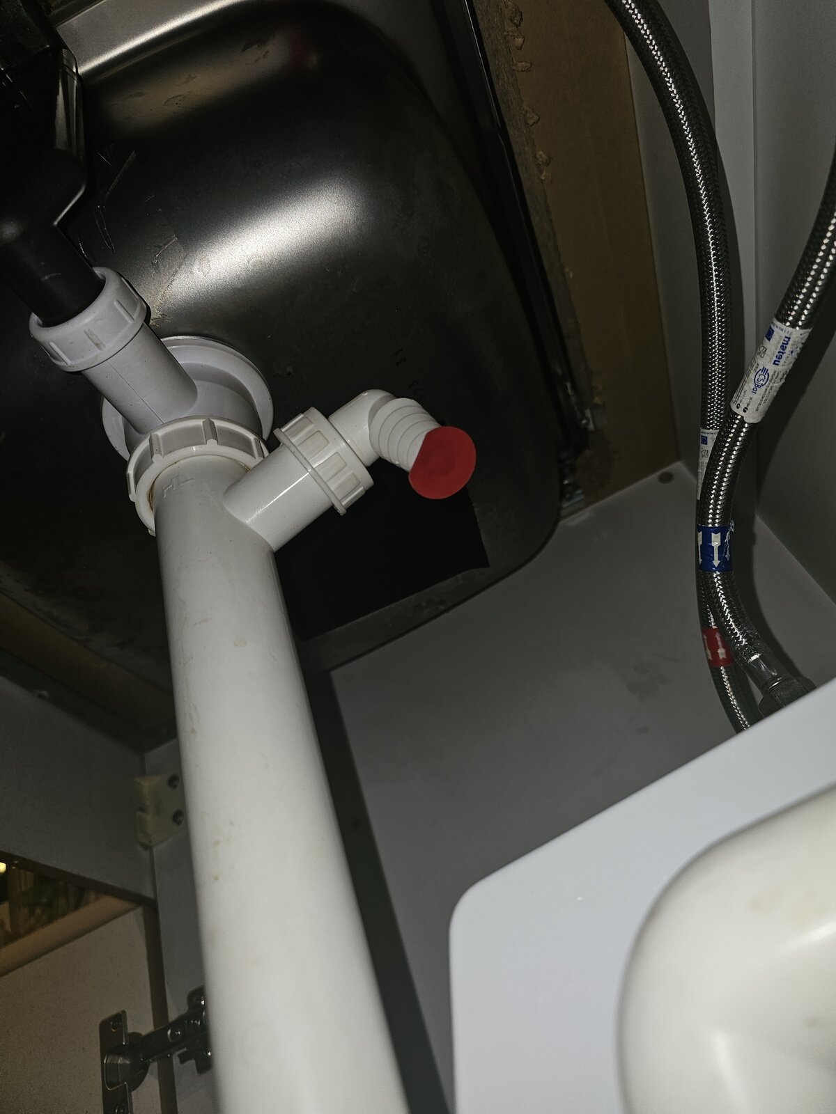

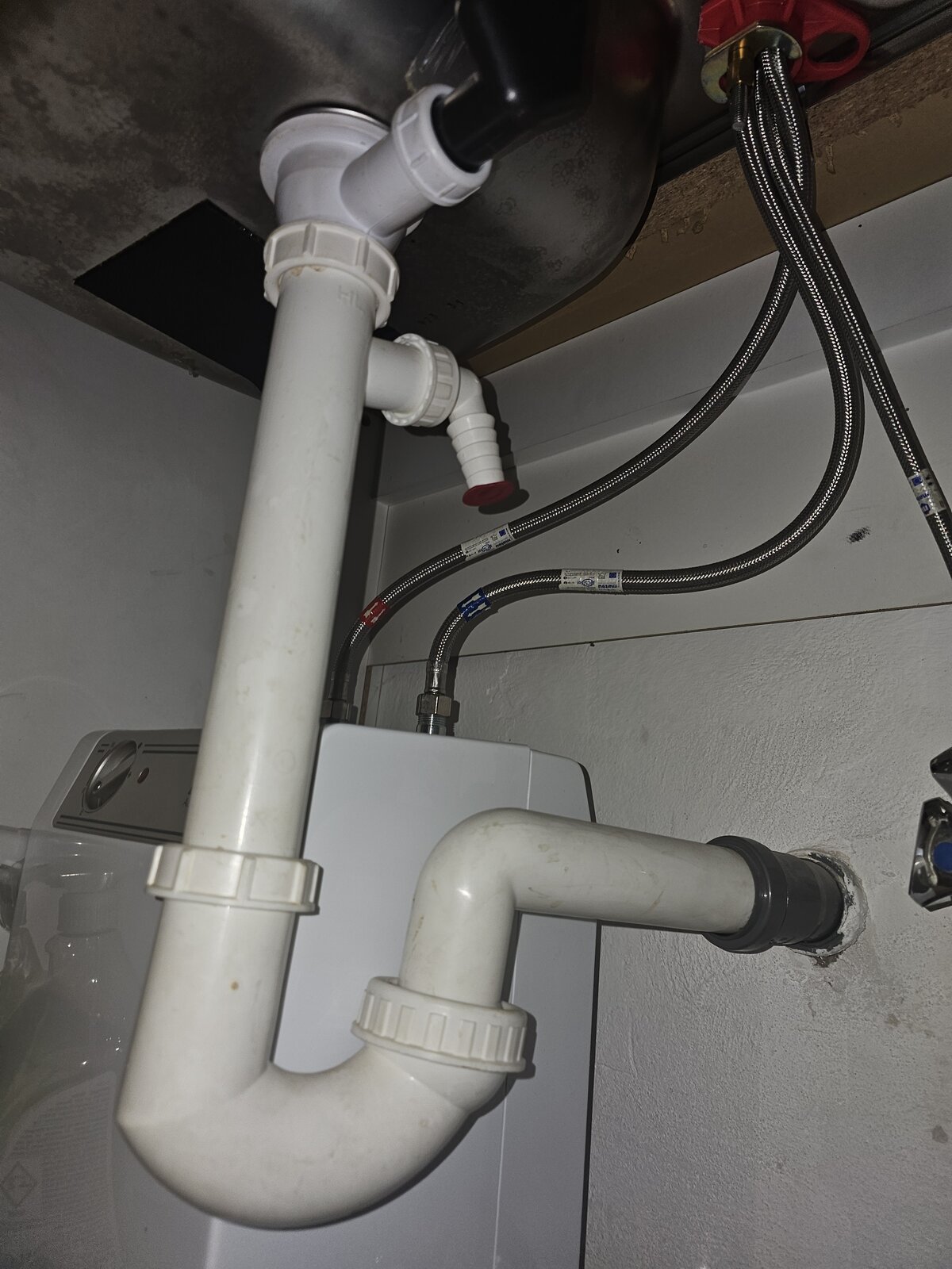

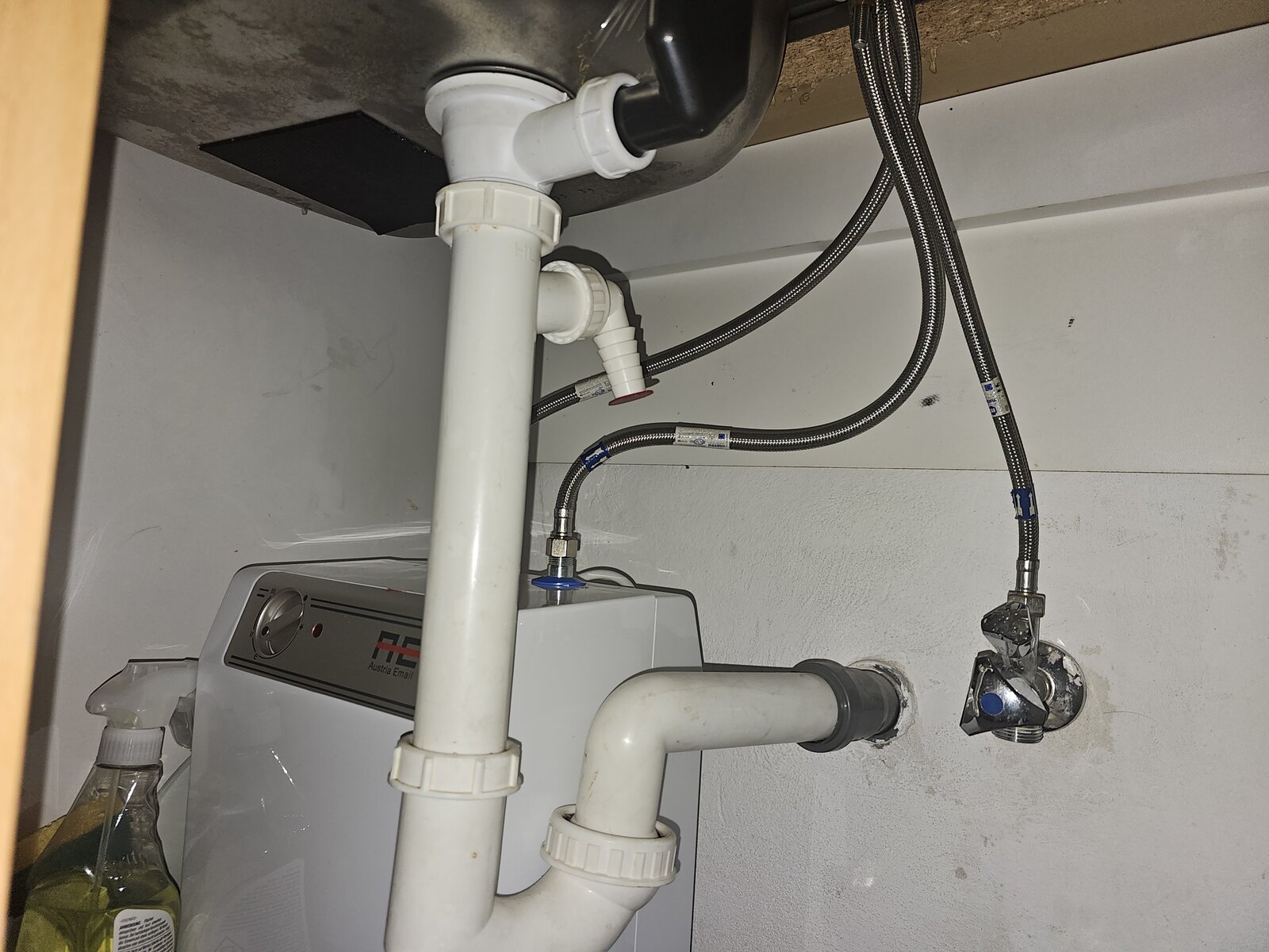

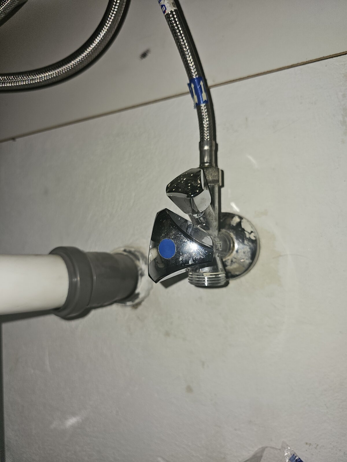

Show us some pics of pipework under the sink.
Didn't you show pics of another boiler , or am I thinking of another thread altogether ? Have you looked to see if a connection could be made there If there is another boiler ?
If the hose will reach to the sink ,there may be a connection point on the pipework there ?
The hose can reach the sink, but it's not an ideal connection.
Here are the photos:

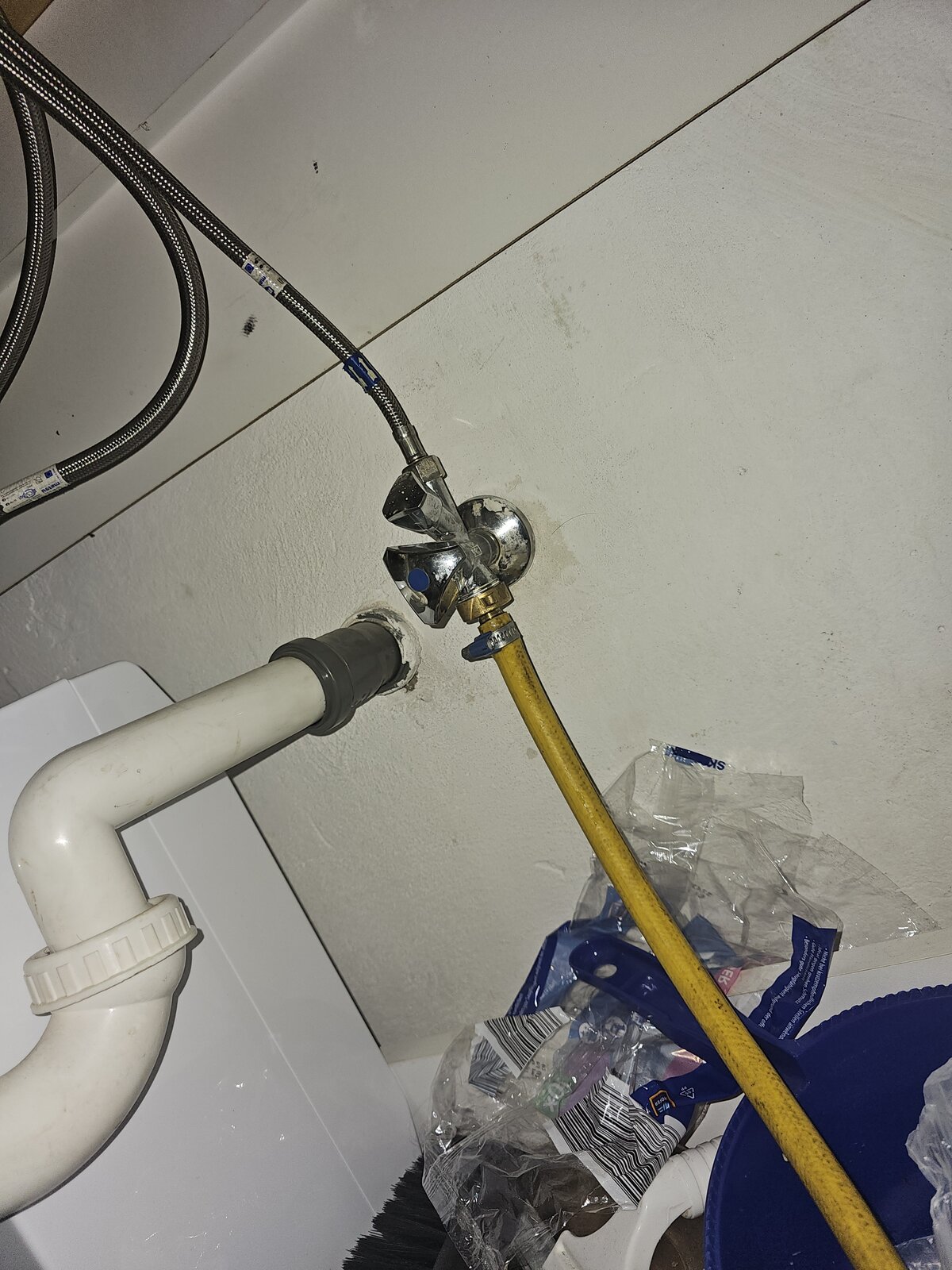

I looked under the sink and I found this, water is coming out nicely. I will try fill up the pressure again!
