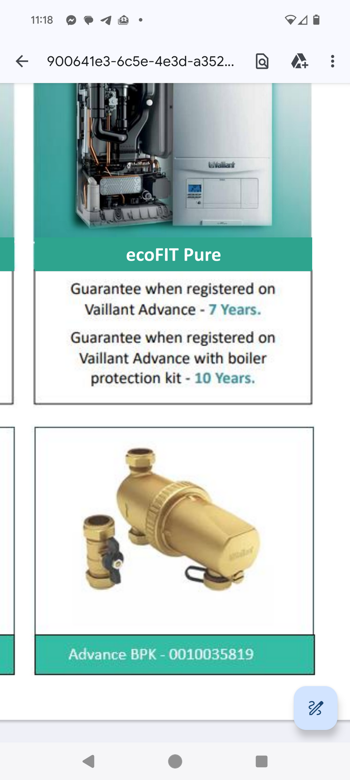

Hmm, I'm not on that list either and I'm a Vaillant Advance Mastertech. Better have a word with my rep, but shows it's not definitive... here are the latest warranty details though

He's absolutely wrong there, as suggested, it's his responsibility to register the boiler on Advance Installer (AI) to obtain the extended warranty, no one else can do that and as also suggested it's got absolutely nothing to do with the shop where he got the boiler from. To register on the portal they do need extra quals apart from being GSR'd, MCS (Microgeneration Certification Scheme) being one of them. If they don't hold that then they may not be able to register. BTW, as shown above, it's 7yrs for the basic extended warranty, only 10yrs if their mag filter was fitted, was it?
Phone Vaillant (0345 602 2922) just to get it from them and then you need to reply to him and tell you know that it is his responsibility to register the boiler with Vaillant for the longer warranty, no if's or buts, I hope you still have the warranty card?
Appreciate the feedback. It was installed yesterday. I was expecting 7 years warranty as that's what I was told. He didn't install the Valliant filter, he installed a Fernox TF1 Omega Filter. Valliant have said the same, I get 2 years now, and 5 additional when the installer registers.
