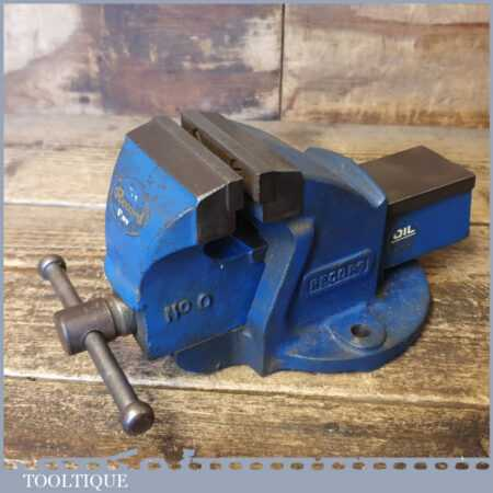

Can you not post a pic of the vice? But really just take the vice to B&Q, choose the biggest bolts that fit in the holes, the B&Q's near me have a pic and mix you just choose whatever bolts/washers/nuts you need and it costs about £2.

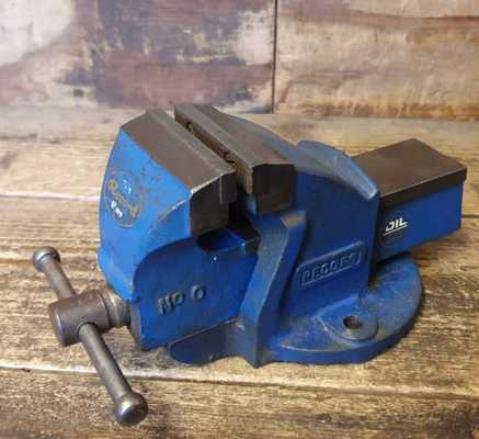

Here is a pic from the net of the vice.

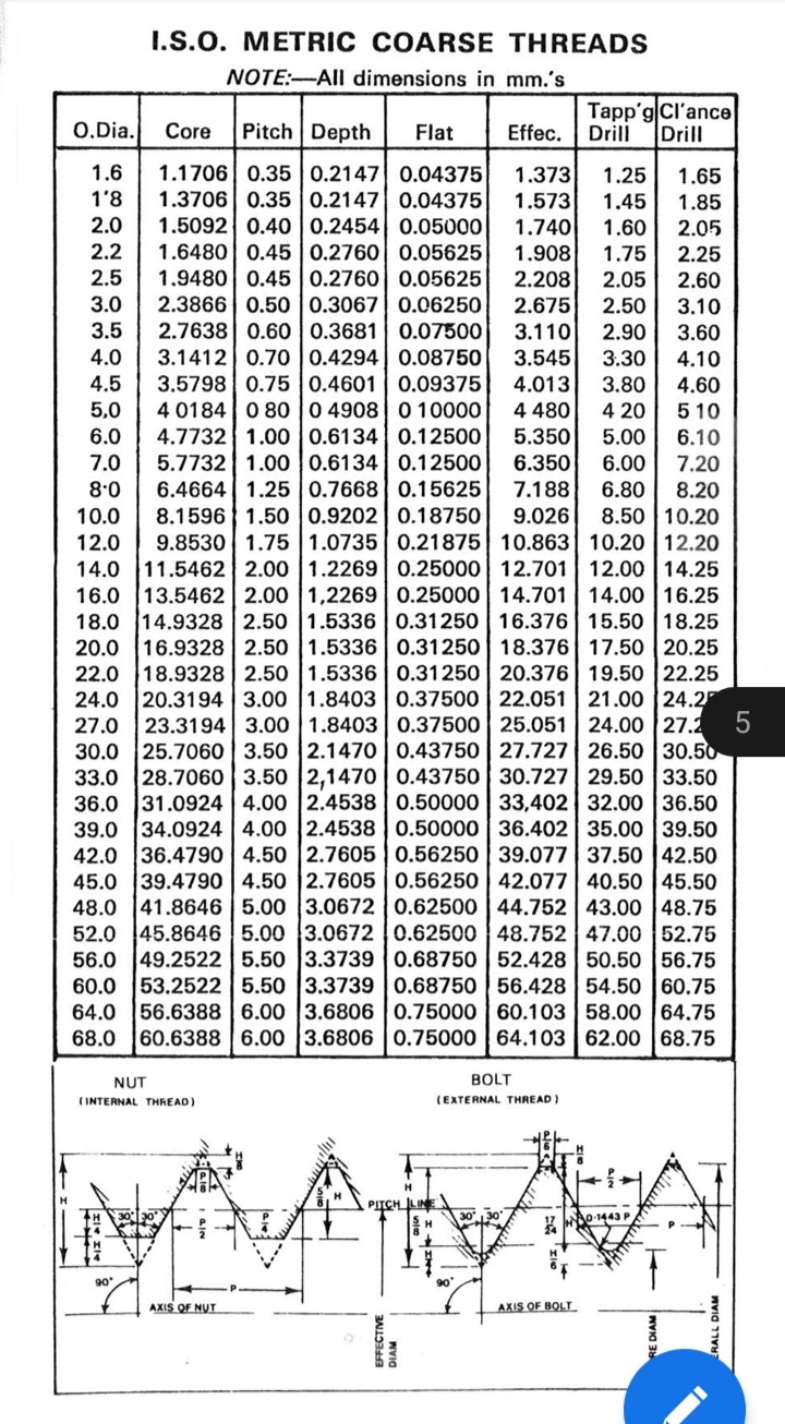

Zeus Precision Charts and Tables, could be a pamphlet you may wish to investigate, especially useful if you are getting into machining!
