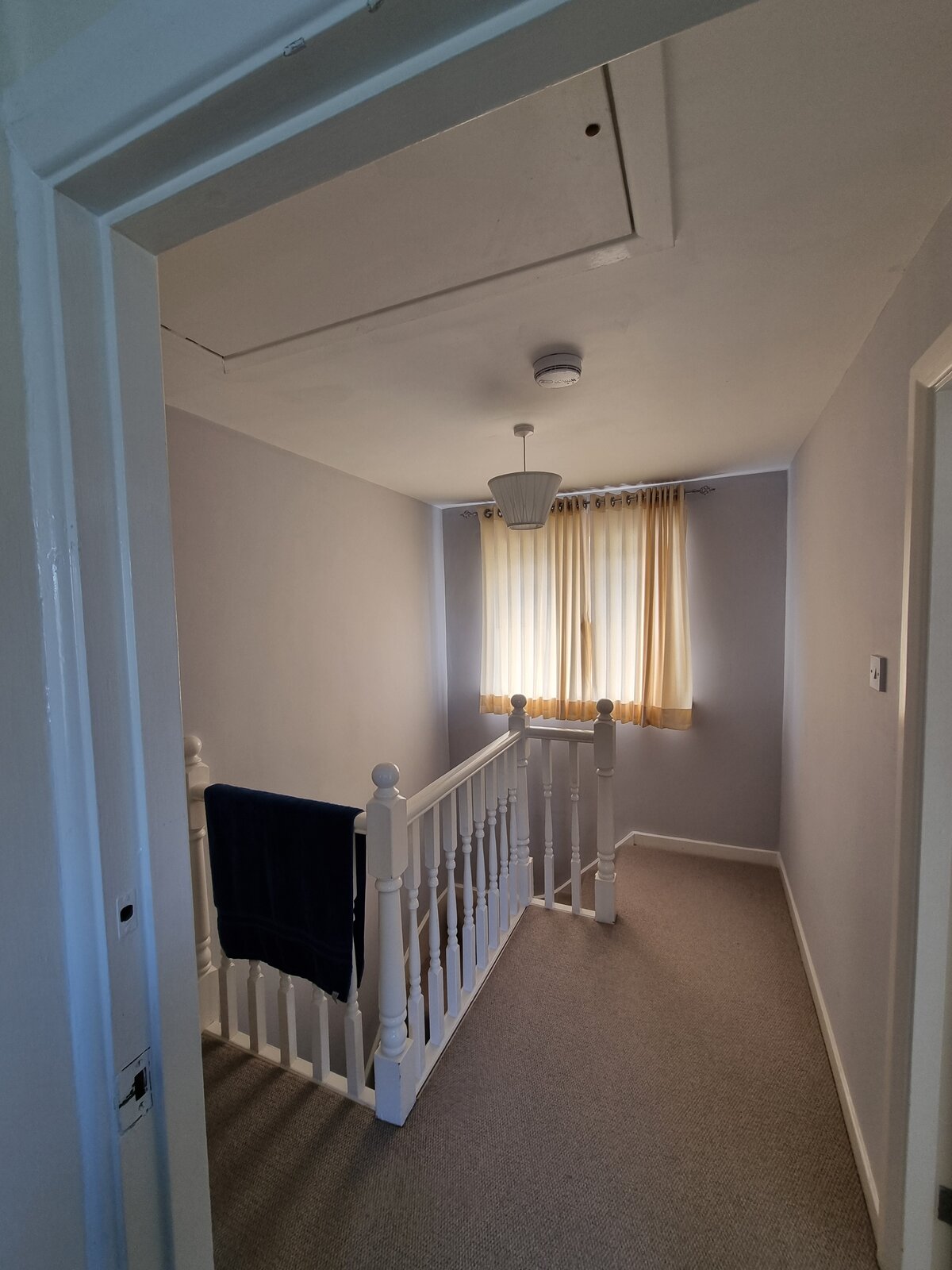

Hi all,
My mums house has a loft and we have an access ladder but she can't really use it as she is old. Wondering if anyone can provide any ideas on getting a staircase to the loft but without needing a dormer (If possible).
I have attached pictures.

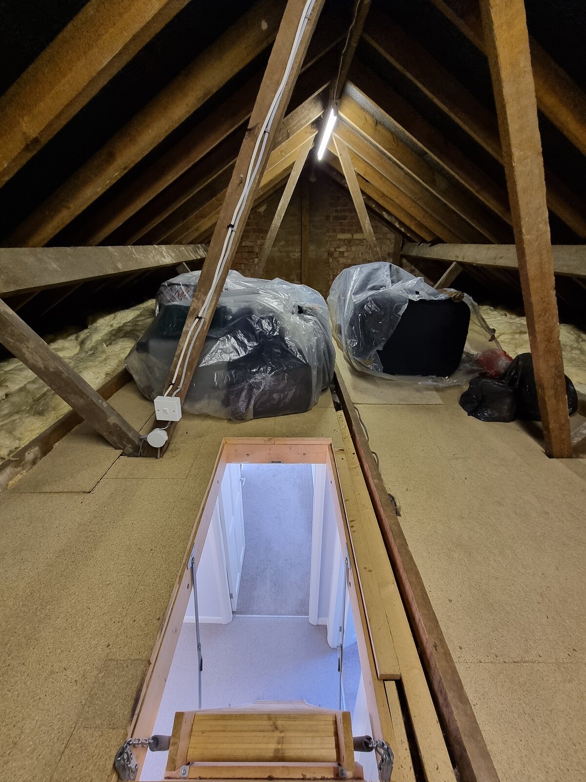

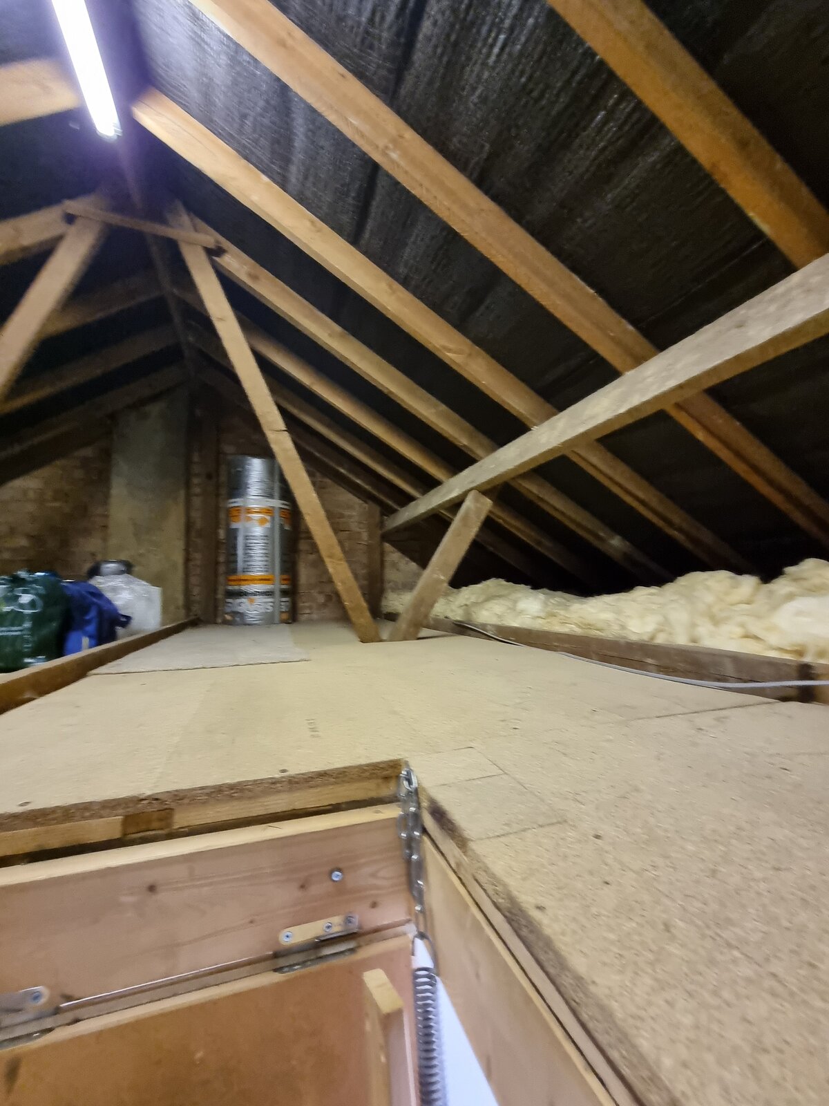

I think you would struggle for headroom in there given that the roll of Rockwool is around 4ft tall and you look like you have 18" or so above that but that is before you strengthen the floor by fitting deeper joists. Unless your elderly Mother needs to get into the loft then i would get someone who is more able to do what you want in terms of using it for storage.
Assuming the downstairs rooms are around the same height as the upstairs you're probably looking at fitting a staircase that starts where that towel hangs over the bannister and mimics what the downstairs case does when it comes up, with a turn, probably tw don't comes back on itself and enters the loft at 90 degrees to present
If ma struggles using that ladder she won't take kindly to a spiral or space saver and a usable case for her will probably clown that window and any sense of open was in the upstairs hall, but anything can be made possible with time and money

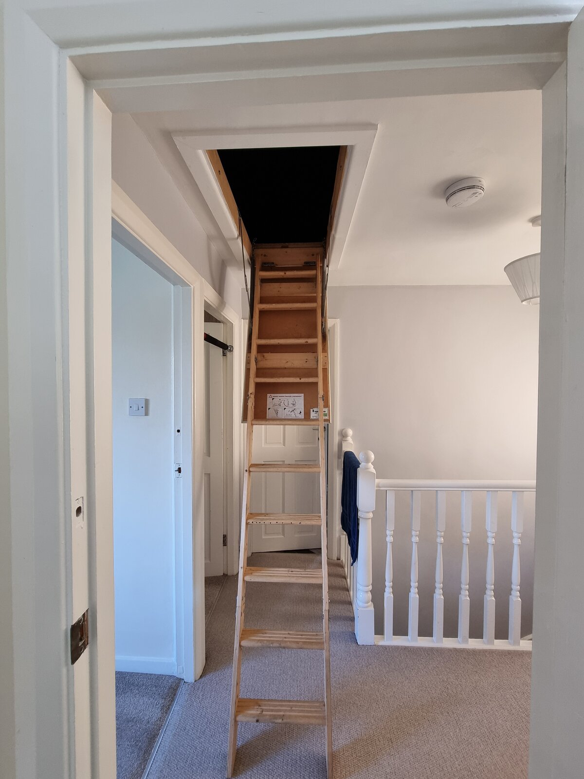

Having spoken to her, she doesn't mind the fold out stair case, but she would rather it be less steep and possibly with a bannister if those exist
Sounds like more of an engineering job then to just make a longer, more meaty staircase and rail, perhaps garage door style springs to assist with raising and lowering, or if she could still get on with a ladder style access, electric ones exist with handrails..

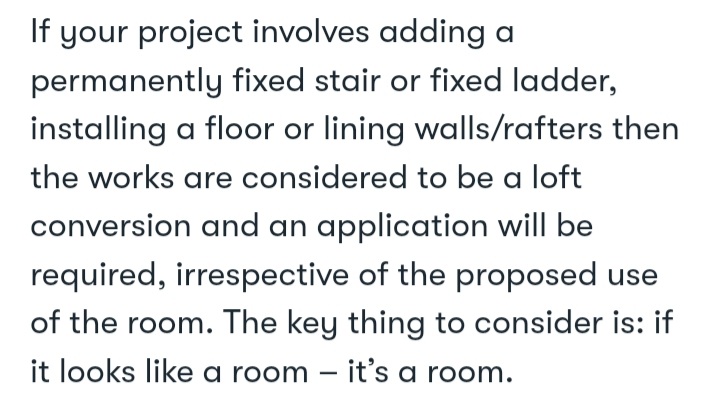

Once you fit a permanent staircase in the eyes of Building Control (and when you come to sell) it will be seen as an illegal loft conversion. Technically you would may be breaching your house insurance conditions too. Google 'retractable stairs UK' there are few choices that may suit.

I say old, she isn't drastically old like. Just not able to climb steep loft ladders. Main reason is storage, as the loft is a good size she would like to utilise it if she can. She can get up just now down as its steep haha
Not unless it’s intended for use as an occupied room. Storage with a stairs is fine.
Only if the loft is not converted, surely?
