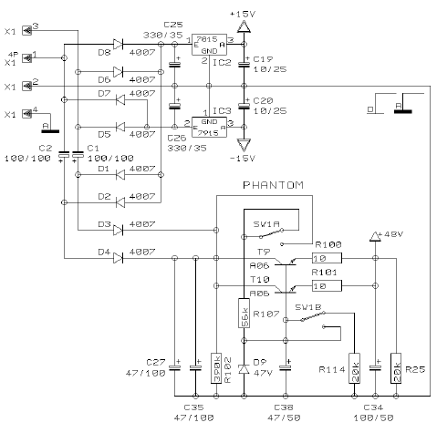

This is not at all unusual of this type of equipment. I have very little insight into the internal workings of Behringer kit but fairly extensive knowledge of older Soundcraft kit (FX, SX & notepad) In these there is a 17-0-17V ac supply feeding a bridge rectifier providing + & - 21V which is then smoothed and regulated to + & - 17V to feed the op-amps. however there is one other little catch, the phantom power for the microphones is 48Vdc. This is achieved by passing the 2 phases of ac through capacitors (to provide dc isolation) and then fullwave rectified to 32V which is then added to the unregulated +21V supply, smoothed and regulated to +48V.
A couple of years ago I needed to use a mixer on battery and simply used 2 X 18V jel batteries (2 pairs of 12V 7AH & 6V 6AH) which worked well, except the phantom power was 11V but not needed.
Edit to 21V from my notes
So I checked my computer to see if I have a circuit diagram for a soundcraft and sadly I don't, However I do for a Behrenger 1202 which is simply 2 more microphone inputs than OP's:
X1 pins 1&3 are the 2phase 15v supply, pin 2 is neutral

This is not at all unusual of this type of equipment. I have very little insight into the internal workings of Behringer kit but fairly extensive knowledge of older Soundcraft kit (FX, SX & notepad) In these there is a 17-0-17V ac supply feeding a bridge rectifier providing + & - 21V which is then smoothed and regulated to + & - 17V to feed the op-amps.....
Fair enough, but I still don't understand why that needs a 17-0-17V supply?
.... however there is one other little catch, the phantom power for the microphones is 48Vdc. This is achieved by passing the 2 phases of ac through capacitors (to provide dc isolation) and then fullwave rectified to 32V which is then added to the unregulated +21V supply, smoothed and regulated to +48V.

What is being termed "Phantom Porwer" in these circuits appears to be voltage derived from a "Voltage Multipler" circuit utilising 3 (sets of) capacitors - and, hence, would be a "Voltage Tripler".
(https://www.electronics-tutorials.ws/blog/voltage-multiplier-circuit.html)
Of course, the current supplied in this way would be quite low.
Correct.
Not knowing the the knowledge base of partcipants of this thread, I had kept the explanations rather basic. This is a full wave voltage trippler rather than the more usual half wave version.
The 48V is supplied to each mic input by a resistor of typically 4K7Ω to 10KΩ so across a 12 i/p desk we are only looking at 20mA or so.

'Most sound desks' use op-amps as their active components which run most successfully on a dual supply rail of 15V, the easiest way to derive this from the mains is a 2 phase ac secondary and full wave rectification. Using the voltage doubler/tripler for the 48V phantom is also easy.
To do all of this from a single 12V supply does require some form of inversion to ac followed by rectification etc which also tends to add noise which is one of the things we try to avoid in pro audio kit
