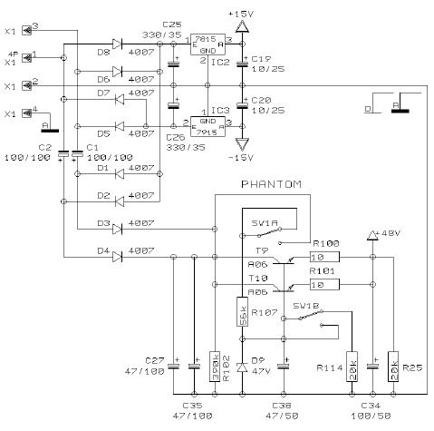

So I checked my computer to see if I have a circuit diagram for a soundcraft and sadly I don't, However I do for a Behrenger 1202 which is simply 2 more microphone inputs than OP's:
X1 pins 1&3 are the 2phase 15v supply, pin 2 is neutral

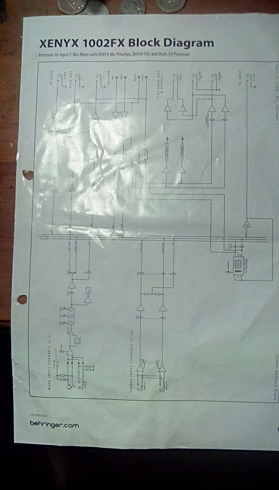

I finally found the schematic diagram for my mixer
Thanks. Unfortunately, that only shows the electronic 'works' of the mixer (i.e. the audio circuitry), and not anything to do with the power supply arrangements. Are there any other schematics there?

I have the full circuit for the 1202 (but not the FX version) which is probably identical to the 1002 if that is of use, I've already posted the PSU element of it.
it.

....I have the full circuit for the 1202 (but not the FX version) which is probably identical to the 1002 if that is of use, I've already posted the PSU element of it.

You may be unfamiliar with the idea, but it's not rare, and for an application like this makes perfect sense. As you'll have seen from the diagram previously posted, the internal circuitry is quite simple - apart from the detail of the voltage tripler for the phantom power. It's low power, efficiency is not an issue - but noise is. It would certainly be possible to have a PSU made to do the whole lot in the external PSU - but it would probably be a custom model and a custom unit costs more than an off the shelf one as well as bringing various factors into play in terms of specifying the design and ensuring that the manufacturer meets it. As they've done it, the key bits that control supply quality (especially noise) are inside their own box.
But it comes down to this : whatever any of us think about it, it's how they decided to do it, and that's all that matters !
As for the OP, the unit should work just fine from + & - DC supplies with the exception of the phantom power. A quick check of the specs for a 7815 regulator indicates that the dropout voltage is around 2V, so the + input needs to be around 18V minimum (and the - input around -18V). Maximum limits seem to be higher than I expected at 35V, so damaging the unit is unlikely with (say) ± 24V. It might even be practical to power it (for short periods) with 4off PP9 batteries to give (nominally) ±18V.
