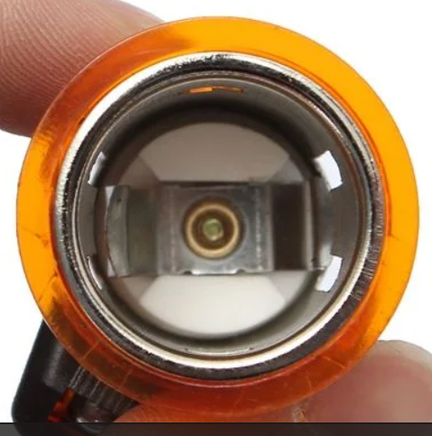

Those sockets came in two 'internal' diameters --- hence the removable red plastic part on some of those shown in the link I provided. In the (unlikely) event the Volvo cigar lighter socket had such a narrower centre the adapter pictured would be unable to reach the centre conductor.

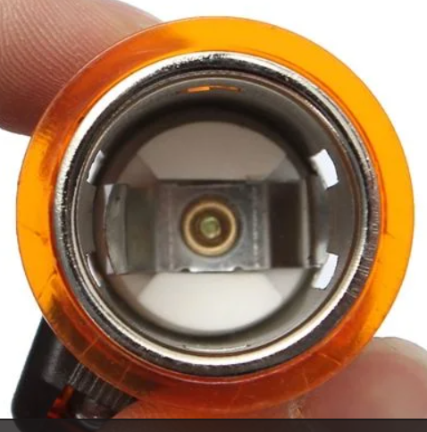

I will next time I'm there. Meanwhile this is one from the internet, it looks like the ones I've seen in the past, and I think his will be similar. I can't see any sign of that needing a centre contact.
Yes that requires a centre contact activated when pushed in .

This is the 'plug' I meant: ISO 4165 and from German military WW2 vehicles originally... https://en.wikipedia.org/wiki/ISO_4...ockets_(iso_4165)_and_cigarette-lighter_2.jpg
Thanks Harry, very interesting. It looks as if there is a centre contact for the one on a USB adaptor to reach. Perhaps I didn't push it in hard enough, as the bishop said to the actress. I'll try again next time I'm there, and take a pic of the socket.

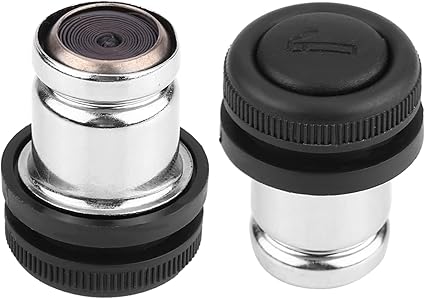

Assuming you don't allow smoking in your car, you could throw away the lighter and fit an inert cap.

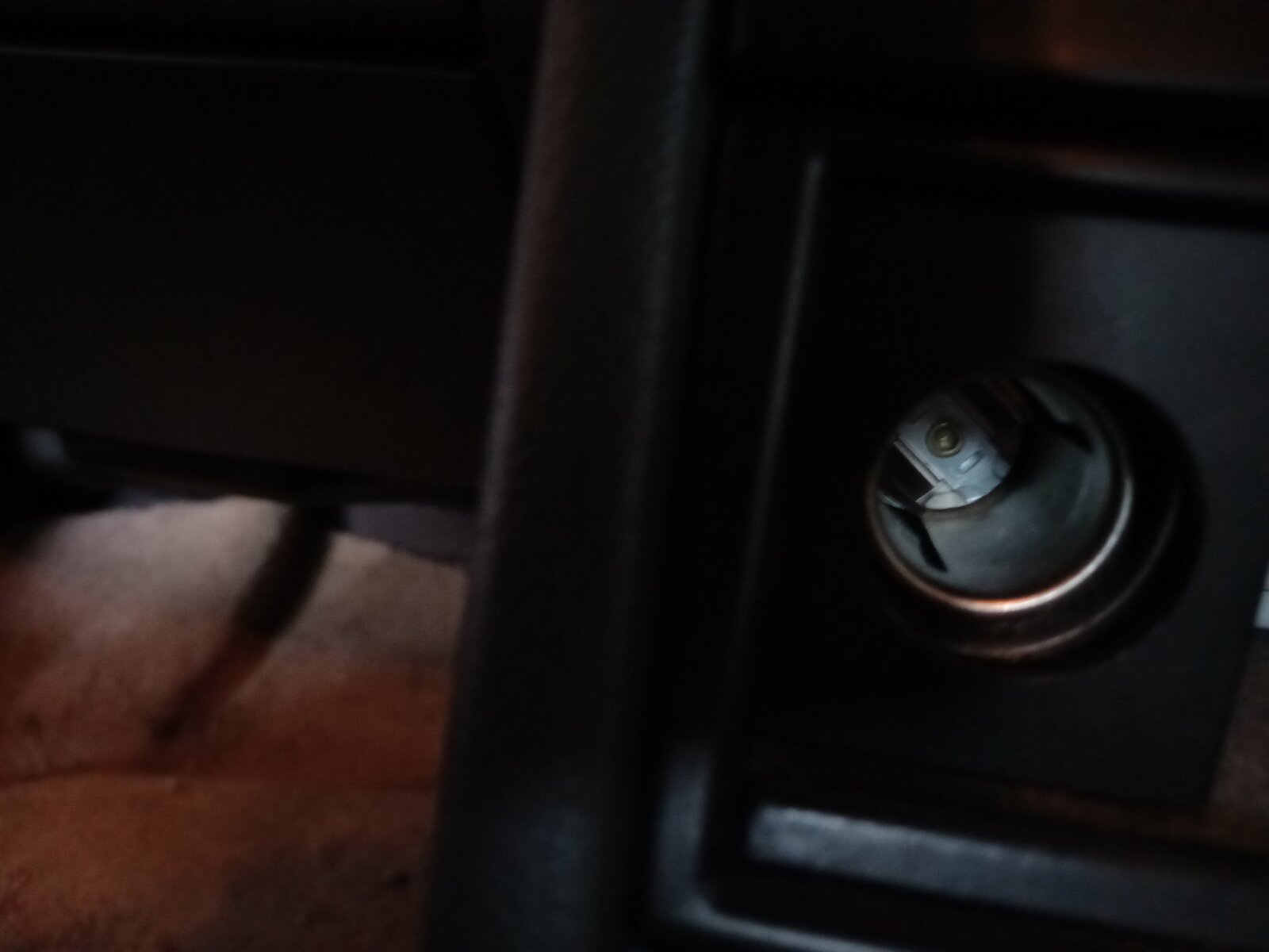

Some interesting developments from visit to bro yesterday.

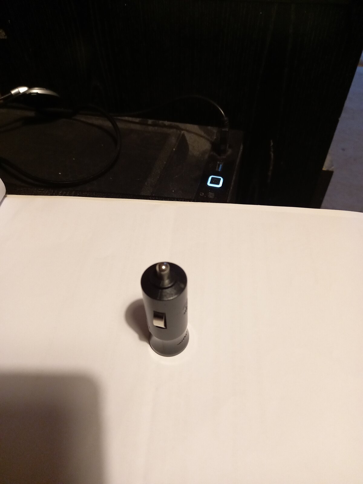

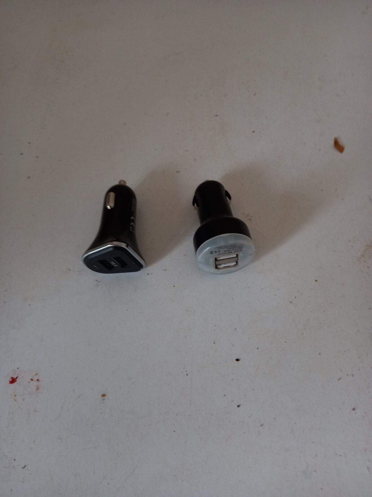

I tried the adaptor in #6 (which I didn’t have with me on the previous occasion), and to my surprise, it worked. My first thought was this is embarrassing, I didn’t try hard enough earlier, but when I had another go with same adaptor as before it still didn’t work. And with a third one, the neon indicator came on for a couple of seconds, then went out. Pic of those 2 attached. All 3 worked fine in the Hyundai.
No doubt the explanation is the two that don’t work flare out, so don’t go in as far. My assumption that the Volvo socket is a different type was clearly wrong, but it would seem to be deeper, than Hyundai anyway. Pic attached, not great but the best I could do.
Thanks (to most posters) for comments and help on this.
