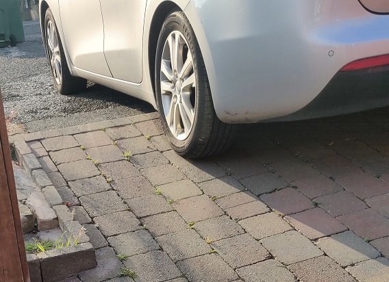

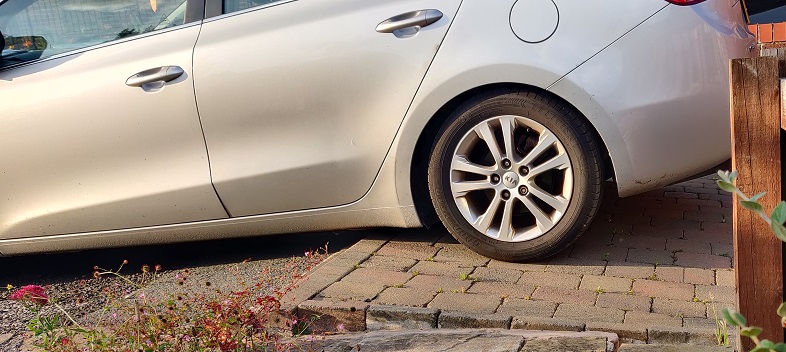

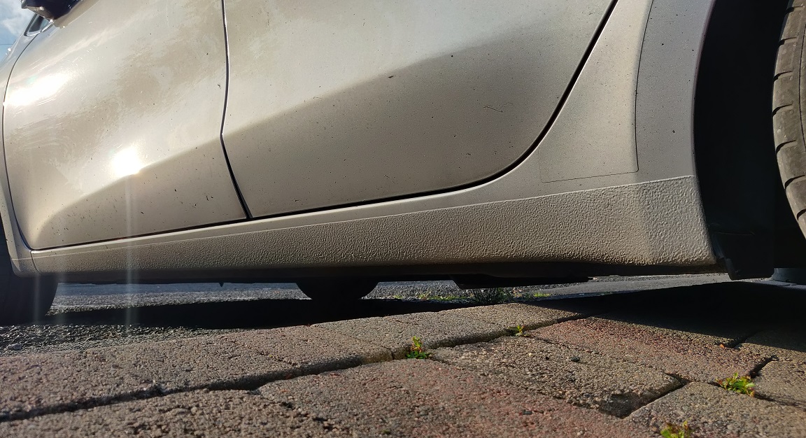

This sloping driveway came with the house we moved into (ie I didnt do it :D) - for some reason there is quite a big hump at the top then it goes back down to the road surface. Because my car is quite long, it wont go over the hump without scraping so I cant really back it down the drive. Whats needed to sort this out - remove 4 or 5 rows, scrape out some sand and drop them back in? Whats the chances of there being enough depth of sand to remove to drop it enough? Do I need to go back more rows than that to smooth out the curve?
Wondering if this is a job I can do or if its a cheapish job for a pro :D

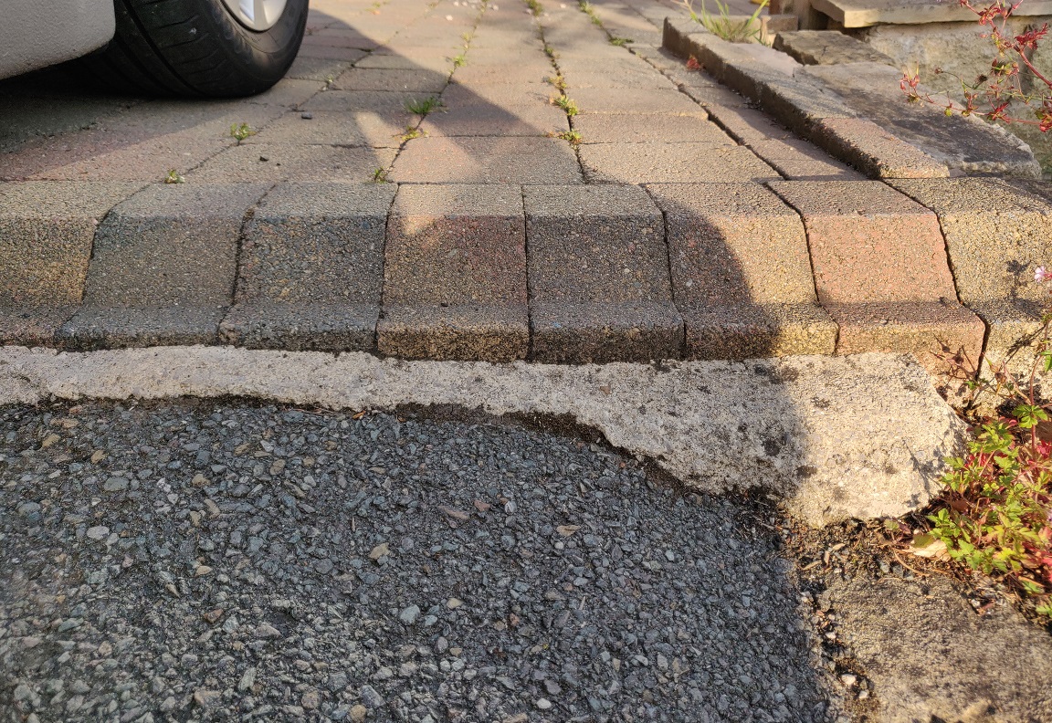

Is it me or do those brick pavers rise up then drop down to meet the tarmac?
If that's the case if you level the pavers the you will naturally get rid of the hump and solve your problem
I would get in a pro to do it personally unless your confident laying pavers and using a vibe plate
A temporary solution, if you have the space, is to drive on/off the drive at an angle. It works for my classic getting over sleeping policeman or road humps.
1, take your car to a friendly garage to check if the object catching on the kerb has been positioned properly, there might be some wriggle room to raise it.
2, Check the Specified tyres for the car, increased wall size if allowed so as not to contact the top of the wheel arch might help.

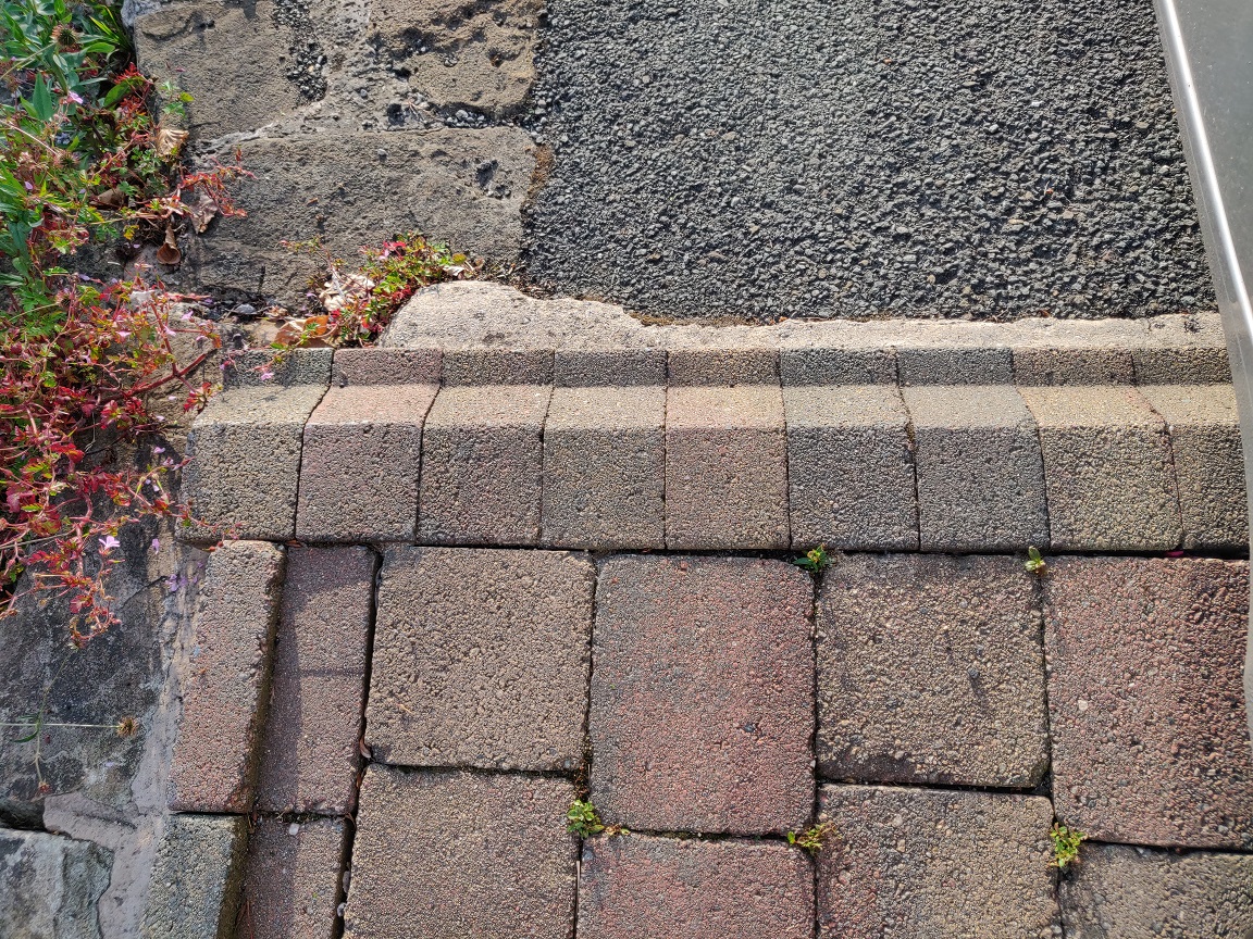

4, the driveway appears to be down hill to the property, so the front may be a dam. I would guess it looks like the blocks have been simply laid on top of a tarmac drive that expired and the falls are towards the house.
5, I would consider taking it out-back 6 blocks to the end of what is a level edging wall There would still be a dam but a little further back and about 3 ins lower. Instead of having to dig up too much of a previous drive, You could do the new front bit in thinner Paviors.

Catlad has the right answer what is needed are several boards either buy or borrow eg rough shelving shed quality long enough for both wheels to drive onto reverse as shown until just about to touch front kerbing - move car forward a foot lay a thin board behind the Front kerb to prevent any grounding and say 3 boards behind the rear wheels and drive on to them if clearance is ok - Then the thickness of the board is the amount the blocks must be lifted plus an amount to allow settlement or you need thicker boards continue doing this until the there is increase in the grounding distance when front wheels come up on kerb. it may be needed to thicken up the boards as you proceed depending on fall until the car has both wheels on the drive. Remove car from drive raise Blocks according to amount determined. Now there a simpler process of matching up to the original block drive levels. You may have to allow 3/4 inch for settlement on the raised blocks as trial and error

There's a good chance the back of the block paving can't be raised because of the height required to level it would create a large step
Far simpler to drop the blocks at the front to level and lower the tarmac too
I would do as you say, go back 5 rows but I would also swap that unusual front row for a standard block paving chamfered edge so it finished flush with the tarmac.

There is an apparent existing access stone line visible in the side view with a post visible and appears to me when you look at the plan view of that corner it being the possible level of a previous drive.
