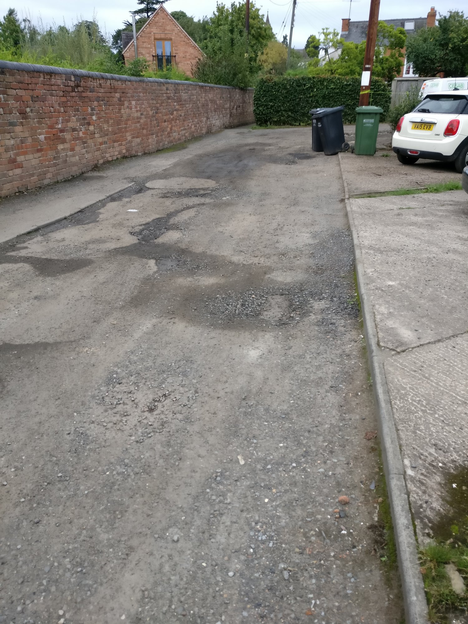

Hi,
I have a bit of a problem with my driveway, as I can only get my car onto it by driving very slowly at a specific angle to avoid scraping the underside.
I have just put up with it since I moved in but I could really do with being able to drive straight onto it, so I want to try and do something about it (other than getting a higher car!)
The road is in a bit of a state, and my actual driveway is on a concrete pad that is raised up above the road. I had considered putting a load of gravel / hardcore or something down on the road to build it up around my driveway, but I don't know if this would look bad, if it will last, or if I am actually allowed to do that.
I can't just pour a bit of concrete right next to it to make a small slope because the middle of the car will scrape before the back wheels reach the slope, so the raised up area needs to spread out a bit beyond the kerb/step.
The road is a dead end by the way, so there isn't much traffic.
Any ideas?
Cheers.

Embarrassingly, I don't actually know if it is privately maintained or not, I'll have to dig out the paperwork when I get home and have a look.

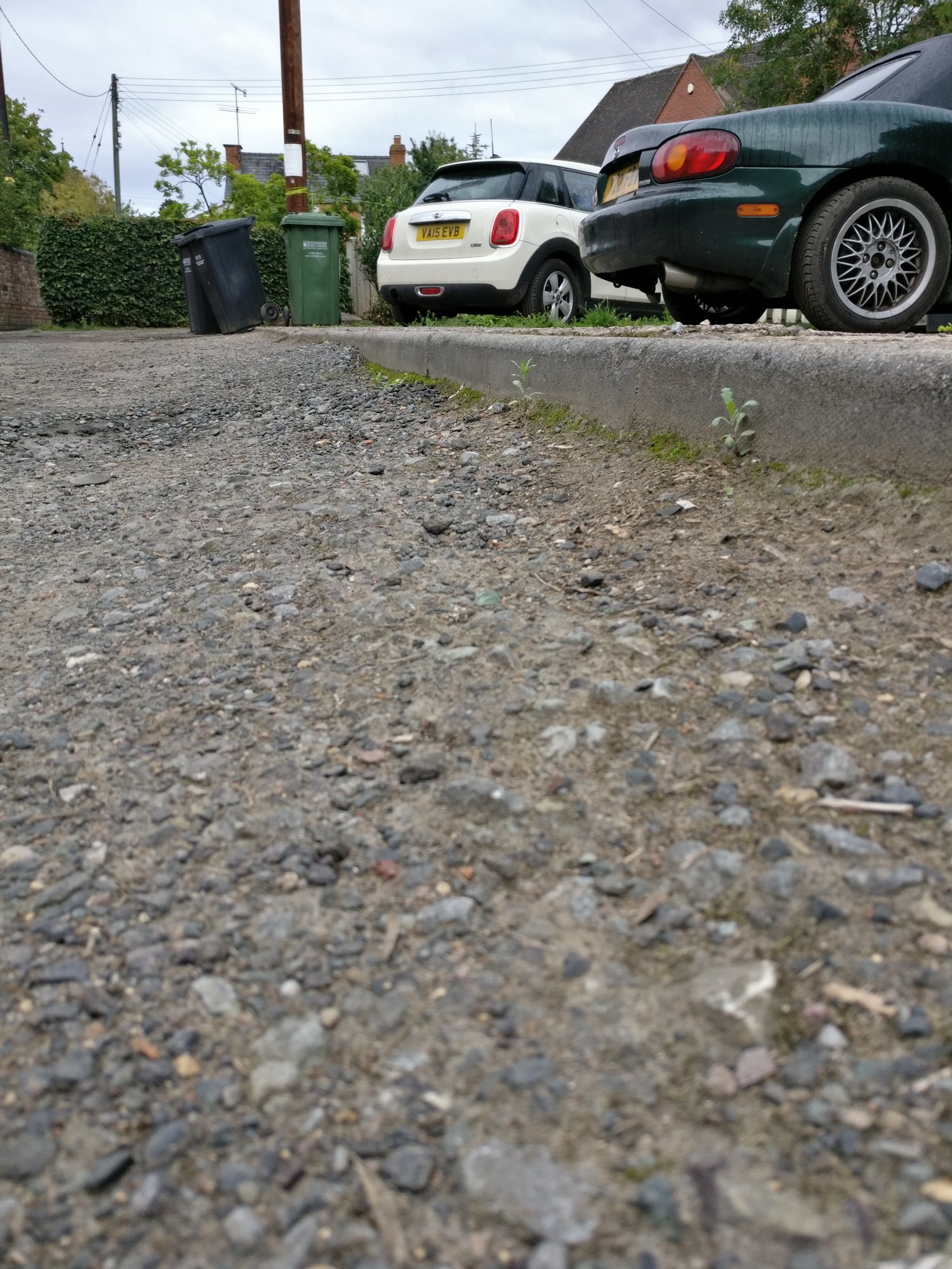

One of the neighbours a few doors down has actually already added a small concrete ramp, but unfortunately that wouldn't help much for me as the car will still bottom out before the back wheel reaches the ramp.
If it turns out to be my responsibility, is there any kind of gravel that I could just spread in the general area to build it up a bit that would work and not just scatter about after a couple of days? I'd probably have to try and match the colour too so it doesn't look horrendous (not that the road is pristine as it is anyway).
Gravel will act like a liquid after a short time, and spread to one stone's thickness. You will need to contain it within edges or rake it very regularly. The white car seems to have it easier- I'd be surprised if it is bottoming; and they have a gentle concrete run-out easing the kerb's effect significantly. Have you had a go on their drive?
Yes, the neighbours with the mini have it better, I would be able to get my car onto their drive if I tried, it just gets worse from about half way across my drive.
The neighbours on the other side have it just as bad as I do, it's just that their car is capable of driving up a kerb, and my stupid lowered car cannot! A gradual concrete slope would be ideal, but I don't know how easily I could blend that in to the rest of the road.
I have more than 1" of clearance, but it isn't a great deal more than that! I had the car before the house..
A barrow-load (or 2) of concrete spread reasonably neatly will suffer the same fate as the gravel (breaking and spreading), but would last a lot longer. I'd give it a go. I wouldn't worry about the road- its little more than a track, and adding concrete like the mini owner has done ain't gonna make it worse!
Use a bit of strong concrete, (or a Grano mix may be even better), and provided the road is private, make yourself a ramp. Lowering the kerb wont help unless you lower the drive too. Probably worth painting the edges either side with bright yellow paint, just to make it a bit more obvious.....

The car isn't horrendously low, I can get over speed bumps fine. The step is just bigger than a standard speed bump!
If you own that driveway (hard standing) then you own the edging kerb at the end of it, and you can alter it yourself.
Whoever owns the access road, be it council or shared private, would not own that kerb
