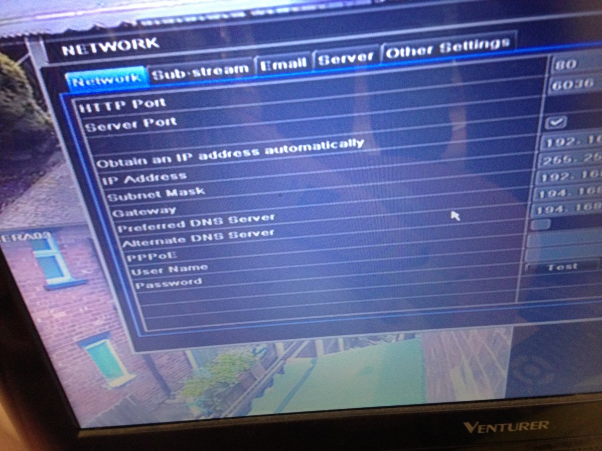

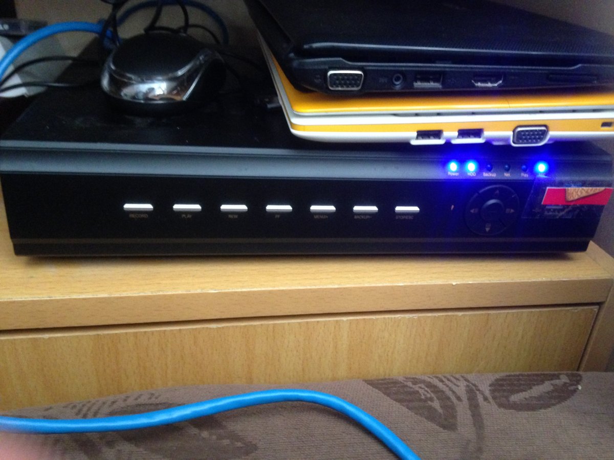

I got a Dvr 16 ch with this info on it
I've got on my iPhone 5 a superlivepro app which allows me to view from home through wifi but when out of house (at work for example ) it won't let me view either off 3G or wifi do I need to change something thanks

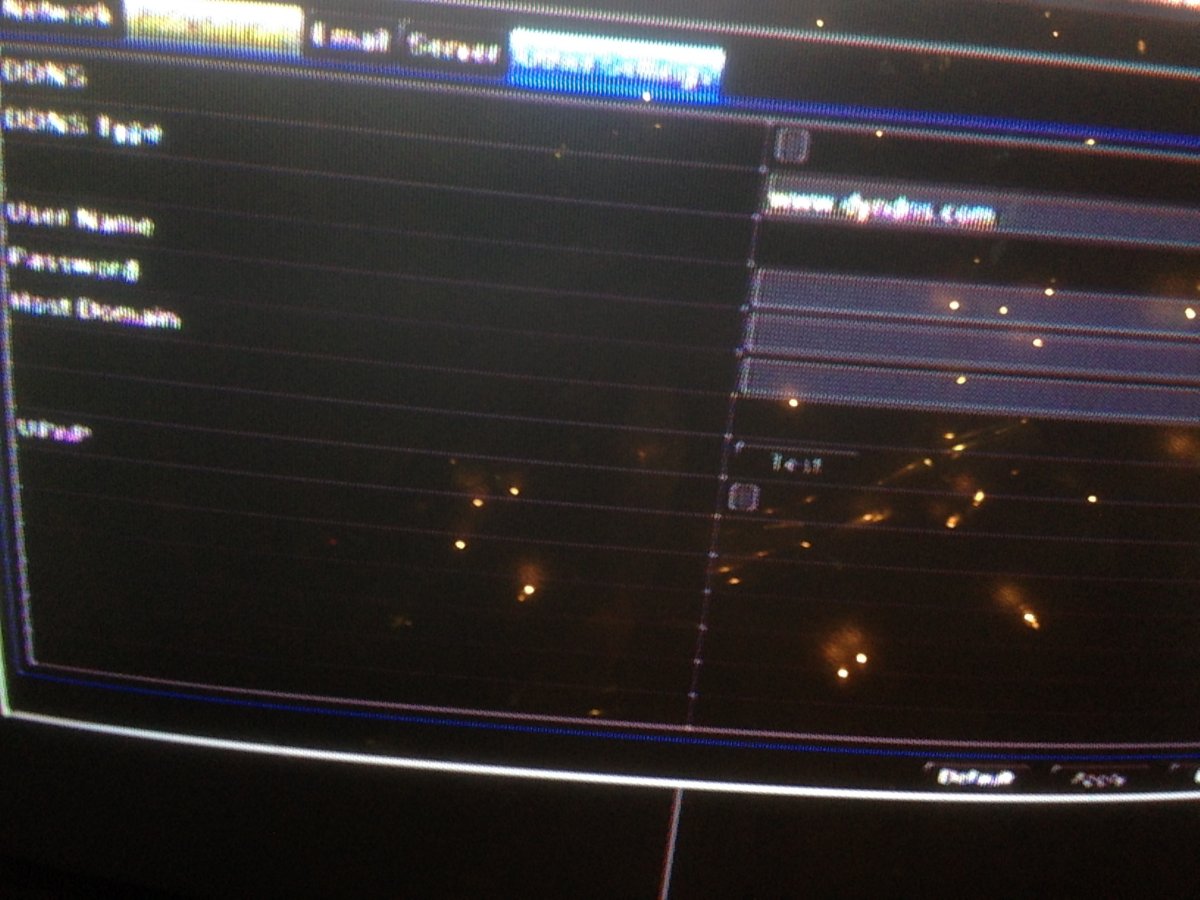

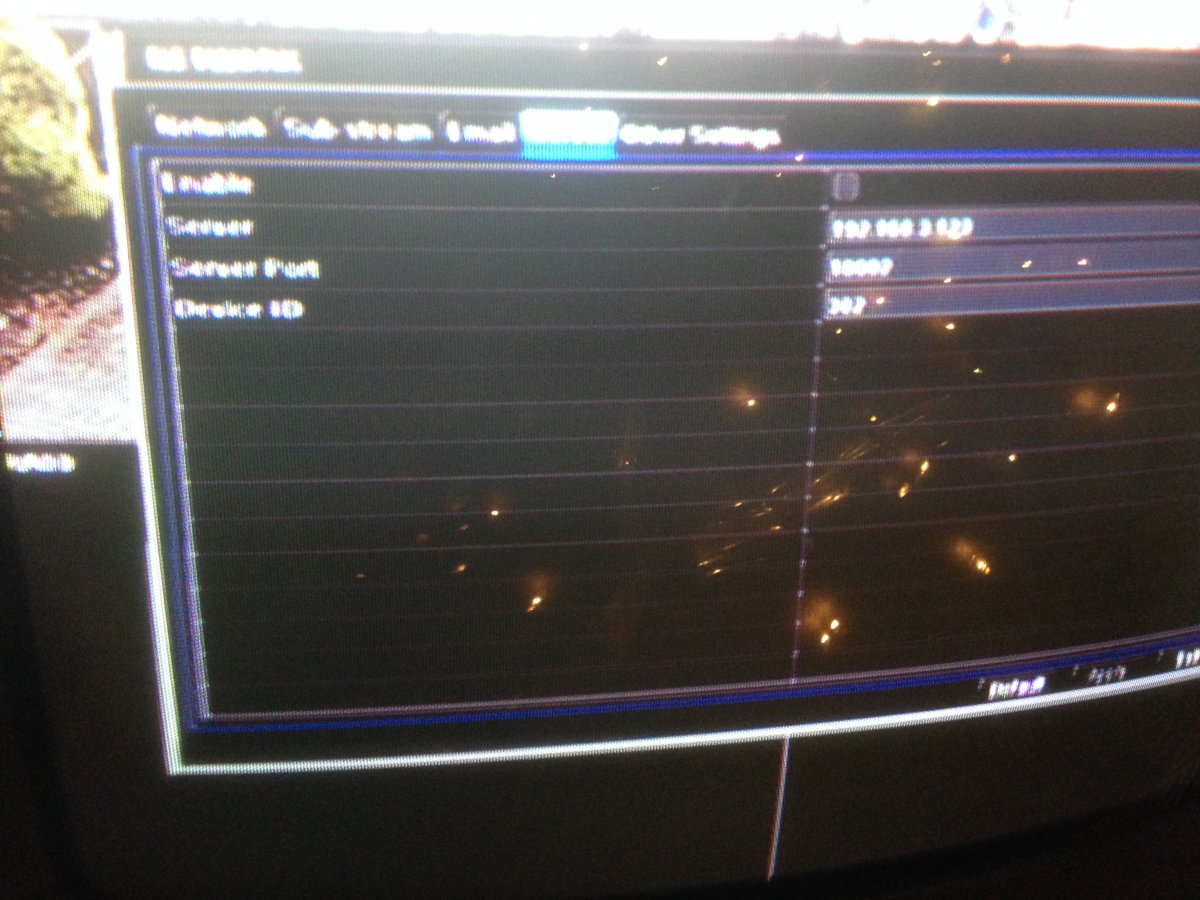

Does it come with a free DNS account ? If not you will need a DNS account or fixed IP address , then you need to set up port forwarding in your router ( this is the more common dvr set up ) other options are out there if your dvr supports it , without any further info on the dvr I can't comment any further ..
The app only asked for IP address and the Dvr came as what you see on pic one sorry to be abit thick but have not got a clue
Is the dns account for app thanks
